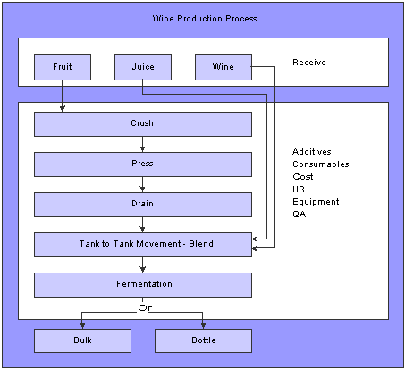

JD Edwards Blend Management Business Processes
The following process flow illustrates the JD Edwards Blend Management business process:
JD Edwards Blend Management process flow
We discuss these business processes in the business process chapters in this implementation guide.
