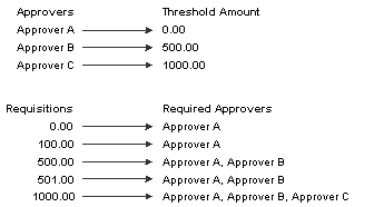

This diagram illustrates how the system would route approvals if you set up a distribution list so that approval is required on all requisitions, regardless of the amount:
Approval required for all requisitions

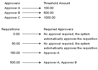

This diagram illustrates how the system would route approvals if you set up a distribution list so that approval is required, starting at a specified amount.
Approval required starting at a specified amount
The Threshold field is a greater-than or equal-to field, meaning that the system requires approval for any requisitions or requisition lines with amounts greater than or equal to the amount in the Threshold field. For example, if you enter 100.00 in the Threshold field, any requisition lines of 100.00 or more must be approved.
