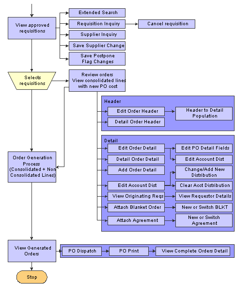

The following diagram illustrates the process flow for expediting requisitions:
Process flow for expediting requisitions
