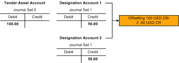

Scenario 2
Donor makes a gift of 100 USD to two designations:
Scenario 2, in which the gift results in a Tender Asset Account debit of 100.00 USD and two Designation Account credits of 50.00 USD each

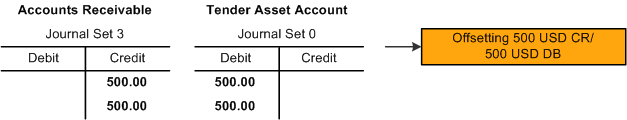

Donor makes a semiannual pledge payment of 500 USD for the previous pledge:
Scenario 3 (2 of 3), in which the pledge payment results in two Accounts Receivable credits of 500.00 USD each and two Tender Asset Account debits of 500.00 USD each

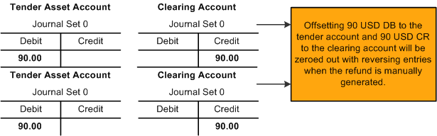

The refund amount is entered to be offset when a refund is generated manually:
Scenario 4 (3 of 4), in which the offsetting 90.00 USD debit to the tender account and the 90.00 USD credit to the clearing account will be zeroed out with reversing entries when the refund is manually generated
