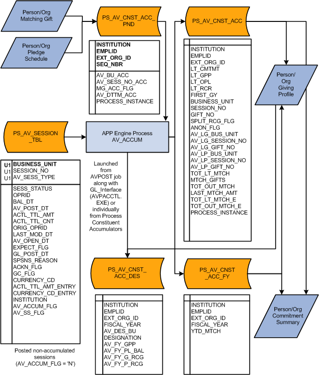

Click to jump to top of pageClick to jump to parent topicUnderstanding the Constituent Accumulators Process
The Constituent Accumulators process builds accumulator tables that summarize data utilized by the Giving Profile and Commitment Summary pages. You can run this process as part of posting any session type using the AVPOST multi-process job, or run it independently through its own run control definition.
Your institution should decide if the information displayed on the Giving Profile and Commitment Summary pages needs to display the latest posted sessions. If so, the Constituent Accumulators process can be run along with the GL Interface in the AVPOST multi-process job. If not, the Constituent Accumulators process can be run independently in an off-peak processing window. Regardless of the run method, the process always attempts to complete all posted and nonaccumulated sessions in the system.
Here is how the process works:
  1. Constituent records are loaded from the Constituent Pending Accumulation table (AV_CNST_ACC_PND) and locked.
  2. Temporary accumulator records are calculated and updated from temporary tables.
  3. Locks on constituent records are released.
  4. Related constituent records from posted, nonaccumulated sessions are loaded and locked.
  5. Temporary accumulator records are calculated and updated from temporary tables.
  6. Locks on constituent records are released.
  7. The accumulator flag on the session table (AV_SESSION_TBL.AV_ACCUM_FLG) is set to 'Y'.
Note. If a session does not accumulate because a constituent accumulator record is locked by another accumulator process, the system skips the session and processes it the next time the accumulator process runs. The locked constituent and the locking process instance is indicated in the Service Operations Monitor Log.
Note. If locking problems persist and the constituent accumulator record is locked by a process that is no longer running, check the constituent accumulator table (PS_AV_CNST_ACC) for records where the PROCESS_INSTANCE field is not equal to zero. Add all constituent records with a nonzero, nonprocessing PROCESS_INSTANCE to the pending accumulation table (PS_CNST_ACC_PND) and reset the locking records PROCESS_INSTANCE to zero. Re-run the process. After the process runs, the pending accumulation table should be empty, and all posted sessions should be processed.
The following graphic illustrates the Constituent Accumulators process flow, from the person or organization's matching gift or pledge schedule, through to the person or organization's commitment summary, including all of the tables affected during processing:

Access the Constituent Accumulators page (Contributor Relations, Session Management, Process Sessions, Constituent Accumulators).
If you process sessions using the AVPOST multi-process job, the system runs the processes automatically as part of that routine. If you run the GL Interface independently, run this process to provide current accumulated data on the Giving Profiles and Commitment Summary pages.
Business Unit
Select the business unit associated with the sessions for which to run the Accumulate Constituent Totals process.
If the process is set up, when you click the Run button, Process Scheduler runs the Accumulate Constituent Totals process at user-defined intervals.

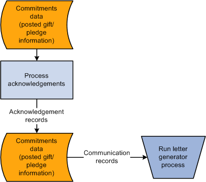

In Contributor Relations, acknowledgement letters and receipts are either queued automatically based on parameters you define when you set up your system or queued manually. After they are queued, communications are generated using the letter generator process.
Before you run the acknowledgement process you must first define the acknowledgement and letter setup for the institution and establish joint relationships. All gifts and pledges to be acknowledged must be posted through the GL Interface process.
The following diagram represents the way acknowledgement information feeds into the joint letter generation process:
Acknowledgement process into letter generation
The 3Cs Engine generates joint communications for acknowledgement letters and receipts. After the communications record exists, you can run the Letter Generator process (CCLTRGEN). The 3C Engine runs through a series of rules to determine which records are joined and should receive joint communications. Any remaining unjoined records receive individual communications. The Letter Generator creates a Comma Separated Values (.csv) file containing data needed to generate both joint and individual letters. The .csv file can be merged with a Microsoft Word template to produce actual letters.
