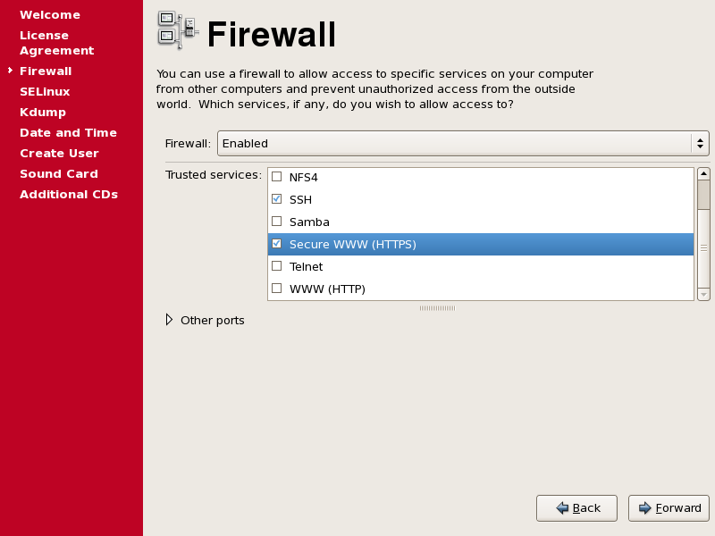

Use the screen shown in Figure 2-2 to allow only secure WWW (HTTPs) and SSH traffic. Be aware that, by default, SSH traffic is enabled, but secure WWW (HTTPS) traffic is not. Note that, when prompted with a warning about not setting the firewall, click Yes.

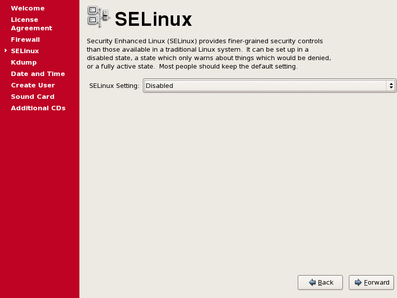

Use the screen shown in Figure 2-3 to disable Security Enhanced Linux (SELinux). Click Forward. Note that you are prompted with a warning that changing the SELinux setting requires rebooting the system so that the entire system can be relabeled. Click Yes.
Important:
Security Enhanced Linux (SELinux) must be disabled for correct operation of RUEI.Accept the default setting on the Kdump screen (disabled), and click Forward.

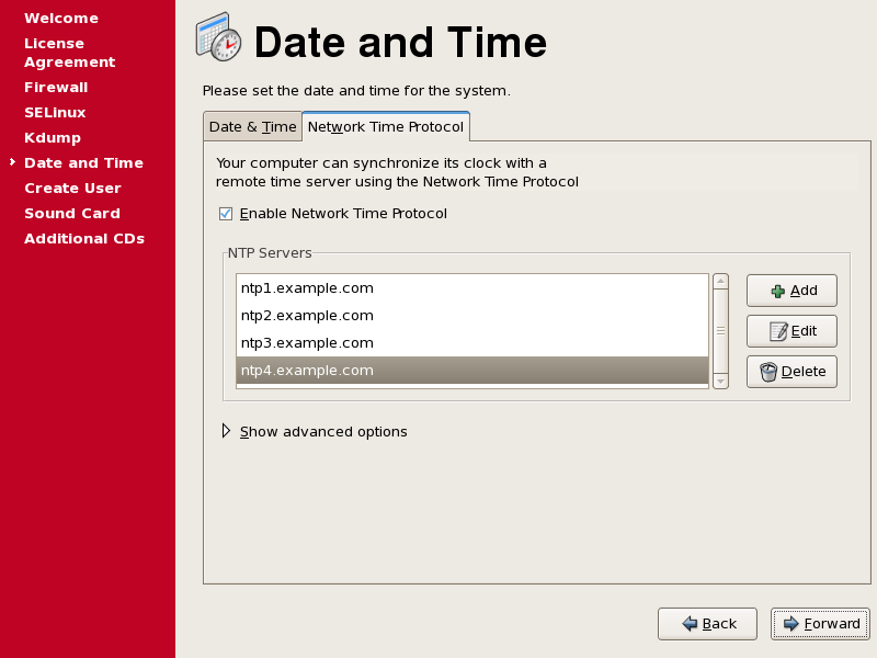

Adjust the date and time settings using the screen shown in Figure 2-4. The use of NTP is strongly recommended, and is required in a split-server deployment. Click OK.
