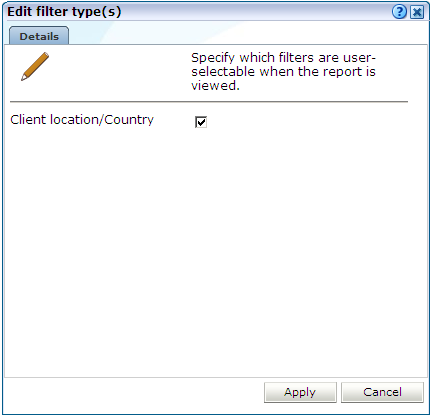

  4. Highlight the filter by placing the mouse pointer over it, and select Edit filter type from the menu. A dialog similar to the one shown in Figure 3-14 appears.
    Figure 3-14 Edit Filter Type(s) Dialog
    Description of Figure 3-14 follows
    Description of "Figure 3-14 Edit Filter Type(s) Dialog"
  5. Use the check box(s) shown in the Edit filter type(s) dialog to control which filters can be selected by a user when the report is opened. There will be a check box for each defined report filter. When ready, click Apply.
  6. Save the report, as described in Section 2.9, "Creating New Reports".
