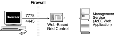

Firewalls Between Your Browser and the Grid Control Console
Connections from your browser to the Oracle Enterprise Manager 10g Grid Control Console are performed over the default port used for your Oracle HTTP Server.
For example, the default, non-secure port for the Oracle HTTP Server is usually port 7778. If you are accessing the Grid Control Console using the following URL and port, then you must configure the firewall to allow the Grid Control Console to receive HTTP traffic over port 7778:
http://mgmthost.acme.com:7778/em
On the other hand, if you have enabled security for your Oracle HTTP Server, you are likely using the default secure port for the server, which is usually port 4443. If you are accessing the Grid Control Console using the following URL and port, then you must configure the firewall to allow the Grid Control Console to receive HTTPS traffic over port 4443:
https://mgmthost.acme.com:4443/em
See also:
Oracle Application Server 10g Security Guide
Figure 19-2 shows the typical configuration of a firewall between your browser and the Grid Control Console Web-based console that is rendered by the Management Service.
Figure 19-2 Firewall Between Your Browser and the Grid Control Console
Description of Figure 19-2 follows
Description of "Figure 19-2 Firewall Between Your Browser and the Grid Control Console"
Figure 19-3 Firewall Between Your Browser and the Grid Control Console
Description of Figure 19-3 follows
Description of "Figure 19-3 Firewall Between Your Browser and the Grid Control Console "

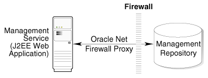

Firewalls Between the Management Service and the Management Repository
Secure connections between the Management Service and the Management Repository are performed using features of Oracle Advanced Security. As a result, if the Management Service and the Management Repository are separated by a firewall, you must configure the firewall to allow Oracle Net firewall proxy access.
See Also:
"Configuring Secure Sockets Layer Authentication" in the Oracle Database Advanced Security Administrator's Guide
Figure 19-8 shows a typical configuration of a firewall between the Management Service and the Management Repository.
Figure 19-8 Firewall Between the Management Service and the Management Repository
Description of Figure 19-8 follows
Description of "Figure 19-8 Firewall Between the Management Service and the Management Repository"

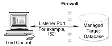

Firewalls Between the Grid Control and a Managed Database Target
When you are using the Grid Control Console to manage a database, you must log in to the database from the Grid Control Console in order to perform certain monitoring and administration tasks. If you are logging in to a database on the other side of a firewall, you will need to configure the firewall to allow Oracle Net firewall proxy access.
Specifically, to perform any administrative activities on the managed database, you must be sure that the firewall is configured to allow the Oracle Management Service to communicate with the database through the Oracle Listener port.
You can obtain the Listener port by reviewing the Listener home page in the Grid Control Console.
See Also:
Figure 19-9 shows a typical configuration of a firewall between the Management Service and the Management Repository.
Figure 19-9 Firewall Between the Grid Control and a Managed Database Target
Description of Figure 19-9 follows
Description of "Figure 19-9 Firewall Between the Grid Control and a Managed Database Target"
Figure 19-10 Firewall Between Grid Control and Managed Database Target
Description of Figure 19-10 follows
Description of "Figure 19-10 Firewall Between Grid Control and Managed Database Target"

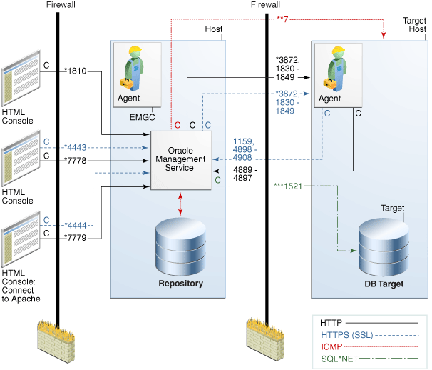

Firewalls Used with Multiple Management Services
Enterprise Manager supports the use of multiple Management Services that communicate with a common Management Repository. For example, using more than one Management Service can be helpful for load balancing as you expand your central management capabilities across a growing e-business enterprise.
When you deploy multiple Management Services in an environment protected by firewalls, be sure to consider the following:
  • Each Management Agent is configured to upload data to one Management Service. As a result, if there is a firewall between the Management Agent and its Management Service, you must configure the firewall to allow the Management Agent to upload data to the Management Service using the upload URL.
  • In addition, each Management Service must be able to contact any Management Agent in your enterprise so it can check for the availability of the Management Agent. As a result, you must be sure that your firewall is configured so that each Management Service you deploy can communicate over HTTP or HTTPS with any Management Agent in your enterprise.
    Otherwise, a Management Service without access to a particular Management Agent may report incorrect information about whether or not the Management Agent is up and running.

Enabling ICMP Echo Requests on Firewalls
The Management Service uses the ICMP Echo Request to check the status of the machine. If the ICMP Echo Request is blocked by the firewall, the machine will be appear to be down. To determine the status of any machine in the environment, ICMP Echo Requests must be enabled on the firewall. If the ICMP Echo Request is enabled, the ping command can be issued by the Management Service to check the status of the machine.
