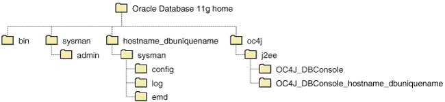

Figure 18-1 shows some of the important directories you should be familiar with in a typical Grid Control installation. You can use this information as you begin to maintain, troubleshoot, and configure the Oracle Management Service installation.
Figure 18-1 Directory Structure in the Management Service Home
This figure shows the directories installed with Grid Control 11.1.
Table 18-1 describes in more detail the Oracle Management Service directories shown in Figure 18-1. In the table, ORACLE_HOME refers to the Oracle Management Service home directory in which the Oracle Management Service is installed and deployed.
