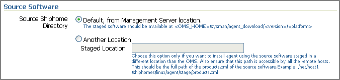

On the Installation Details page, in the Source Software section, do the following:
Select Default, from Management Server location if the Management Agent software is available in the default directory that exists within the OMS.
For example, <OMS_HOME>/sysman/agent_download/<version>/<platform>
Select Another Location if the Management Agent software is available in a non-default or custom location. Specify the full path to that location, and ensure that the path you specify leads up to the product.xml file. Also ensure that this location (shared or non-shared) is accessible from all the remote hosts and you have read permission on it.
For example, /shared/products/shiphomes/linux/agent/stage/products.xml.

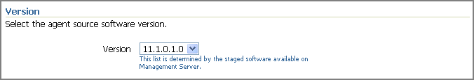

In the Version section, select the version of the Management Agent that you want to install. The values available in this list depend on the software staged on the OMS host.

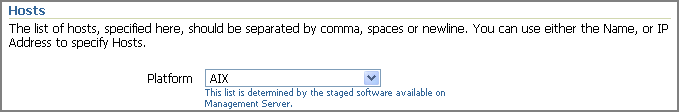

In the Hosts section, do the following:
From the Platform list, select the platform (operating system) on which you want to install the Management Agent.

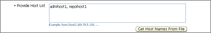

For Provide Host List, specify the host names or IP addresses of the hosts on which you want to install the Management Agent.You can use a comma (,) or a white space as a separator when specifying multiple hosts.
Alternatively, if you already have a list maintained in a file, then click Get Host Names From File and select that file.
For information about host list file, see What Is a Host List File?.

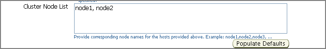

For Cluster Node List, specify the cluster nodes on which you want to install the Management Agent. For more information, see Overview.
For Cluster Name, specify a unique name for the cluster. If you are extending a cluster, specify the name of the existing cluster. The cluster name that you specify here identifies that cluster in the Grid Control console.

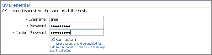

In the OS Credentials section, do the following:
Specify the appropriate operating system user credentials. The operating system credentials you specify here must be the same for all the selected hosts.
Select Run root.sh (for UNIX) if you want the application to run this script.
The root.sh script runs after the configuration assistants are run and before the postinstallation scripts (if any) are run. If you do not select this option here, you must run root.sh on each node manually.

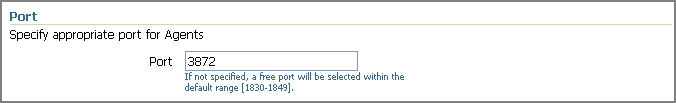

In the Port section, specify the port on which the Management Agent will communicate. The default port is 3872. Ensure that the port you specify is not busy, otherwise the prerequisite check fails.
If you are not sure, leave this field blank. The application automatically picks up the first available free port within the range of 1830 - 1849.

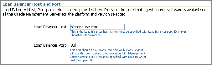

In the Load Balancer Host and Port section, specify the name of the host and port where the Server Load Balancer is set up so that communication between the Management Agent and the host running the Server Load Balancer can be enabled. This is required only if you are deploying the Management Agent in an environment that has multiple OMSes managed by a Server Load Balancer.
Note: If your Server Load Balancer is not functional for some reason, then you can optionally specify the host name and port of the OMS that is being managed by the Server Load Balancer. This is however not recommended, so use this option only if your Server Load Balancer has a problem. |

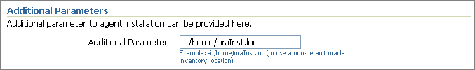

In the Additional Parameters section, specify any additional parameters that you want to pass during installation.
The additional parameters you specify here depend on the software source location that you have selected in Step (4).
If you selected Default, from Management Server location, then specify the additional parameters listed in Table F-1.
If you selected Another Location, then specify the additional parameters listed in Table F-2.
Oracle recommends you to specify only those parameters that you want to run in addition to the general parameters you have already provided on this page for installation. For example, in Step (8), you are specifying the installation base directory. Therefore, for Additional Parameters, try to avoid specifying the installation base directory again. If you still do so, then the value you specified in Step (8) will be ignored and the value you specified here will be used instead.
And note that if you are specifying more than one parameter, then separate them with a white space. For example, -i /etc/oraInst.loc -p /home/config/staticports.ini.

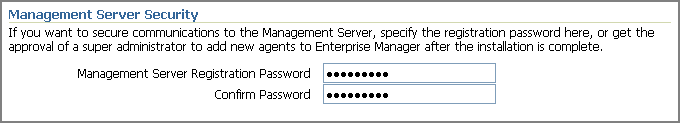

In the Management Server Security section, specify a password that can be used for authenticating new Management Agents that join the Enterprise Manager Grid Control system, and for permitting only secure Management Agents to communicate with the OMS, which is in locked state, via HTTPS protocol.
Alternatively, after the installation is complete, the super administrator can approve the addition of new Management Agents to the Enterprise Manager Grid Control system.
Note: For security reasons, Oracle strongly recommends you to change the OMS password specified here After the installation is complete. |

(Only for UNIX Operating Systems) If you had NOT selected Run Root.sh in the OS Credentials section of the Installation Details page, then manually run the following scripts as a root user from each of the hosts where the installation was done. If you do not have SUDO privileges, then request your Administrator who has the privileges to run these scripts.
If this is the first Oracle product you just installed on the host, then run the oraInstRoot.sh script from the inventory location specified in the oraInst.loc file that is available in the Oracle home of the Management Agent.
For example, if the inventory location specified in the oraInst.loc file is $HOME/oraInventory, then run the following command:
$HOME/oraInventory/oraInstRoot.sh
If you are not a root user, then use SUDO to change to a root user. For example, run the following command:
/usr/local/bin/sudo $HOME/oraInventory/oraInstRoot.sh
Run the root.sh script from the Oracle home of the Management Agent:
<Oracle_Home>/root.sh
/usr/local/bin/sudo /scratch/OracleHomes/agent11g/root.sh
