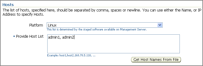

  4. In the Hosts section, do the following:
    Hosts
    1. From the Platform list, select the platform (operating system) on which you want to install the Management Agent.
    2. For Provide Host List, specify the host names or IP addresses of the hosts on which you want to install the Management Agent.You can use a comma (,) or a white space as a separator when specifying multiple hosts.
      Alternatively, if you already have a list maintained in a file, then click Get Host Names From File and select that file.
      For information about host list file, see What Is a Host List File?.

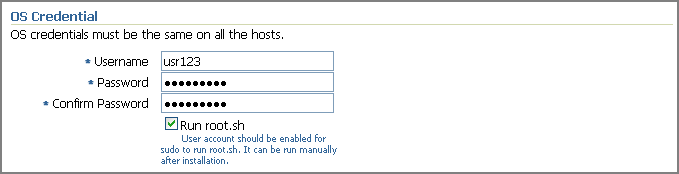

  5. In the OS Credentials section, do the following:
    OS Credentials
    1. Specify the appropriate operating system user credentials of the destination hosts. The OS credentials that you specify here must be the same for all the selected hosts
    2. Select Run root.sh (on UNIX machines only) if you want the application to run this script.
      The root.sh script runs after the configuration assistants are run and before the postinstallation scripts (if any) are run. If you do not select this option here, you must manually run root.sh on each node.

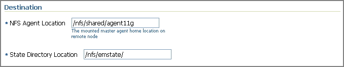

  6. In the Destination section, do the following:
    Destination
    1. For NFS Agent Location, specify the complete path to the shared, mounted, shared directory where the Management Agent software is available. This location must be visible on all remote hosts.
    2. For State Directory Location, specify the complete path to an appropriate EMSTATE directory for storing configuration files such as emd.properties, targets.xml, log files, and so on, on each host. Every host that shares the Management Agent has its own EMSTATE directory.
      For information about EMSTATE directory, see What Is EMSTATE Directory?.
