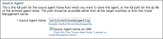

  4. On the Installation Details page, in the Source Agent section, do the following:
    Source Agent
    1. For Source Agent Home, specify the location where the Management Agent to be cloned is available.
      The location can be one of the following:
      Full path to the Oracle home of the Management Agent that you want to clone In this case, the Oracle home can be on the host where OMS is running. For example, /home/john/Oraclehomes/agent11g/. Alternatively, it can be on a shared, mounted location. For example, /net/host/OracleHomes/agent11g.
      While specifying the path, ensure that the path leads to the Oracle home directory (agent11g).
      In this case, the Agent Cloning Wizard automatically excludes the directories mentioned in the following file present in the Oracle home of the OMS:
      $<ORACLE_HOME>/sysman/prov/agentpush/resources/scripts/exclude.lst
      Full path to the location where the archived format (ZIP file) is available, that is, if you have already archived the Oracle home of the Management Agent The archived ZIP file can be on the host where OMS is running. For example, /home/john/Oraclehomes/agent11g.zip. Alternatively, it can be on a shared, mounted location. For example, /net/host/OracleHomes/agent11g.zip. While specifying the path, ensure that the path leads to the archived ZIP file name.
      Ensure that the ZIP file contains the contents of the Oracle home. To ensure this, when you create the ZIP file, create it from the parent directory of the Oracle home. Also note that, in this case, the Agent Cloning Wizard does not automatically exclude the directories mentioned in the exclude.lst file present in the Oracle home of the OMS, and therefore, while archiving the Oracle home of the Management Agent, you must manually pass this file in the ZIP command.
      For example, to ZIP the contents from /scratch/oraclehome/agent/agent11g, navigate to /scratch/oraclehome/agent directory first, and then run the following command:
      # zip -r agent11g.zip agent11g -x@<ORACLE_HOME>/sysman/prov/agentpush/resources/scripts/exclude.lst
      If this Oracle home of the Management Agent or the archived ZIP file is on the host where OMS is running, then ensure that the user account that was used to install that OMS has read access to that Oracle home or the archived ZIP file, respectively.
      However, if this Oracle home of the Management Agent or the archived ZIP file is on a shared, mounted location, then ensure that the user account that you want to use for cloning the Management Agent has read access to that Oracle home or the archived ZIP file, respectively.
    2. Select Source Agent Home on OMS if the location you specified for Source Agent Home (above) is available on the host where OMS is running.

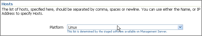

    • From the Platform list, select the platform of the host on which you want to clone. Ensure that the platform you select here matches with the platform of the Source Agent Home.

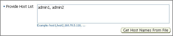

    • For Provide Host List, specify the hosts where you want to clone the Management Agent. You can specify either the name of the host or its IP address. Separate them by a comma or white space. For example, host1.example.com,host2.example.com
      Host List
      You can specify either physical hosts or virtual hosts, but not a combination of the two. If you are specifying virtual hosts, then select All are Virtual Hosts.
      If you have a file that contains a list of all required host names, then click Get Host Names From File and select the file. Ensure that the file format is similar to /etc/hosts file.
      For information about host list file, see What Is a Host List File?.

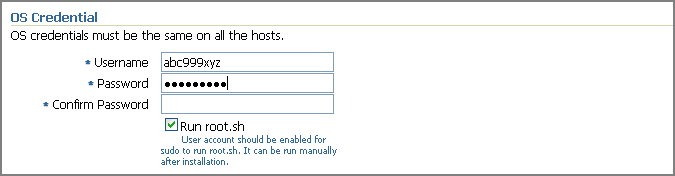

    1. Specify the user name and password to access the destination hosts where you want to clone the Management Agent. If you are cloning on multiple hosts, then ensure that the credentials are the same for all the hosts.
    2. Select Run root.sh if you want Grid Control to run this script.
