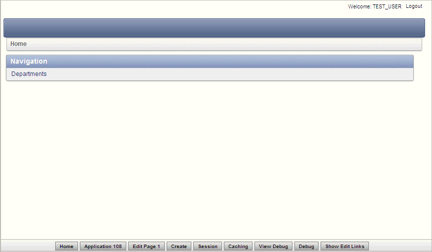

The Home page of your application appears.
Notice that a link to the Departments page appears on the Home page because you set up that hierarchy.
Also notice the Developer toolbar at the bottom of the page. These links appear when you run an application within the development environment. The Developer toolbar offers a quick way to edit the current page, create a page, region, or page control, view session state, or toggle in and out of Debug mode.
Click the Departments link.

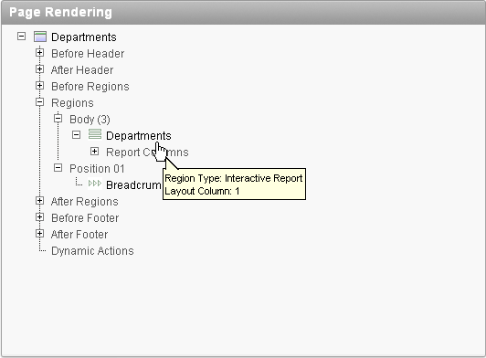

The Page Definition for Page 2 appears.
A page is the basic building block of an application. Pages contain user interface elements such as tabs, lists, buttons, items, and regions. To see the definition of each page belonging to your application, you use the Page Definition page. For more information, see "What Is Application Builder?".
Under Page Rendering, locate Regions.
Expand Region and locate Departments.
Right-click Departments and select Edit.
Tip:
You can also double-click Departments.The Region Definition appears.

In this exercise, you add a link on the Home page to take users to the Employees report. This link appears in the Navigation region on the left side of the Home page.
To add a link on the Home page to the Employees report:
Navigate to the Page Definition for the Home page, page 1:
Click the Application ID link on the Developer toolbar (at the bottom of the page).
On the Application home page, click 1 - Home.
Under Regions, right-click Navigation and select Edit List.
On the Entries by List page, click the Create List Entry button.
On the Create/Edit List page, edit the following:
Sequence - Change to 20.
List Entry Label - Enter Employees
Page - Select 3.
Click Create.
Run the page.
Notice that your Home page now includes a link to Employees.
Click Employees to test the link.
The Employees report appears.

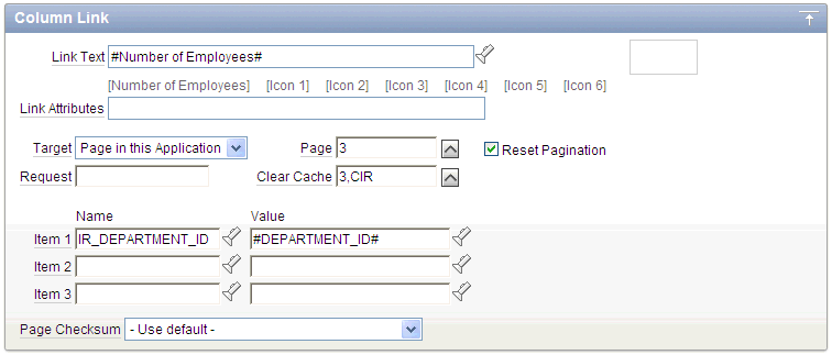

To make this change, you edit the report attributes on the Departments report to change the value for the Number of Employees column to a link.
To change the column value to a link:
Click the Application ID link on the Developer toolbar.
Click 2 -Departments.
Under Regions, right-click Departments and select Edit Report Attributes.
The Report Attributes page appears.
Locate the Column Attributes section.
In the Column Attributes section, click the Edit icon next to Number of Employees.
Scroll down to the Column Link section.
Under Column Link, make these changes:
Page - Enter 3.
Select the Reset Pagination check box.
Clear Cache - Enter:
3,CIR
The 3 means the cache for page 3 is cleared and the string CIR clears the Employees interactive report of any filters, control breaks, highlights, aggregates, computed columns, chart settings or flashback settings when the report is displayed.
If you want to reset the interactive report to the default report settings instead of clear the report, replaceCIR with RIR. The last saved default report settings are applied to the interactive report.Item 1, Name - Enter IR_DEPARTMENT_ID
By prefixing the item name with IR_, the URL item will be associated with an interactive report column rather than an item on the page.
Item 1, Value - Select #DEPARTMENT_ ID#
The Column Link section shows all the options you selected.
In summary, these options enable the following behavior when the end user clicks the link:
The end user is navigated to page 3 of the Employees report.
On the Employees report, the selected department is in focus.
The Employees report is cleared. This means any filters, control breaks, highlights, aggregates, computed columns, chart settings or flashback settings are removed.
The user is returned to the first set of employee records when the user selects another department.
Click Apply Changes.
Note that in the Column Attributes section, the Number of Employees row contains a check mark in the Link column, reflecting the change you just made.
Now, run the report and test the Number of Employees column link from the Departments report. The Employees report is displayed showing all employees that belong to the selected department.
Click the Run Page 2 icon.
The Departments report is displayed. Note that end users can now drill down on the data in the Number of Employees column.
In the Number of Employees column, click the 3 for the Executive row.
All employees that belong to the Executive department appear in the Employees report.
The Department Id filter is displayed because this report is filtered by the Department Id value for the Executive department, 90, passed to this report from the Departments report. Notice the Clear Interactive Report command is included at the end of the URL in your browser, as shown in this example:
f?p=9257:3:3672543193352902::NO:RP,3,CIR:IR_DEPARTMENT_ID:90

To change the column link for Number of Employees:
Click the Application ID breadcrumb.
Click 2 - Departments.
Click the Edit icon for Number of Employees.
Scroll down to Column Link.
For Item 1, select P3_DEPARTMENT_ID.
