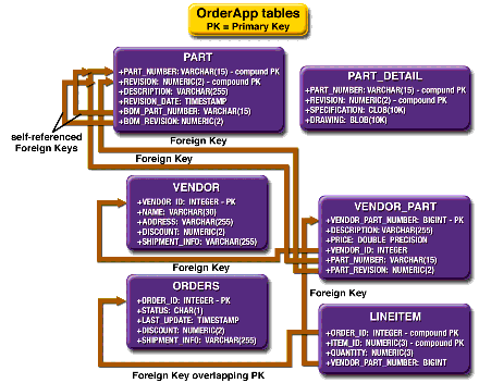

OrderAppconsists of three modules:DataRegistryJAR, an enterprise bean JAR file containing the entity beans, the support classes, and the database schema file;RequestJAR, an enterprise bean JAR containing a stateful session bean that accesses the data in the entity beans; andOrderAppClient, the application client that populates the entity beans with data and manipulates the data, displaying the results in a terminal.Figure 27-10 shows
OrderApp's database tables.
Figure 27-10 Database Tables in

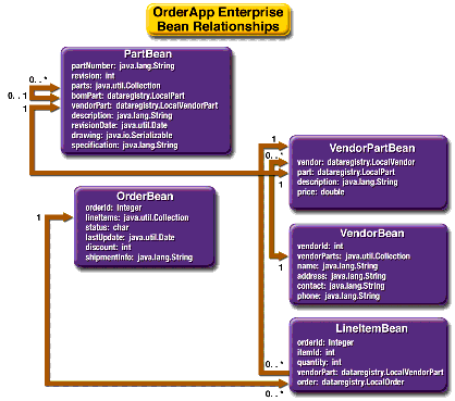

OrderAppBean Relationships in OrderApp
The
RosterAppexample application shows how to set up one-to-many and many-to-many relationships between entity beans.OrderAppdemonstrates two additional types of entity bean relationships (see Figure 27-11): one-to-one and self-referential relationships.
Figure 27-11 Relationships between Entity Beans in
OrderAppSelf-Referential Relationships
A self-referential relationship is a relationship between container-managed relationship fields (CMR) in the same entity bean.
PartBeanhas a CMR fieldbomPartthat has a one-to-many relationship with the CMR fieldparts, which is also inPartBean. That is, a part can be made up of many parts, and each of those parts has exactly one bill-of-material part.The primary key for
PartBeanis a compound primary key, a combination of thepartNumberandrevisionfields. It is mapped to thePART_NUMBERandREVISIONcolumns in thePARTtable.One-to-One Relationships
PartBeanhas a CMR field,vendorPart, that has a one-to-one relationship withVendorPartBean's CMR fieldpart. That is, each part has exactly one vendor part, and vice versa.One-to-Many Relationship Mapped to Overlapping Primary and Foreign Keys
OrderBeanhas a CMR field,lineItems, that has a one-to-many relationship withLineItemBean's CMR fieldorder. That is, each order has one or more line item.
LineItemBeanuses a compound primary key that is made up of theorderIdanditemIdfields. This compound primary key maps to theORDER_IDandITEM_IDcolumns in theLINEITEMdatabase table.ORDER_IDis a foreign key to theORDER_IDcolumn in theORDERStable. This means that theORDER_IDcolumn is mapped twice: once as a primary key field,orderId; and again as a relationship field,order.Unidirectional Relationships
LineItemBeanhas a CMR field,vendorPart, that has a unidirectional many-to-one relationship withVendorPartBean. That is, there is no CMR field in the target entity bean in this relationship.Primary Keys in OrderApp's Entity Beans

PartBean's fields map to more than one database table:PARTandPART_DETAIL. ThePART_DETAILtable holds the specification and schematics for the part. When you set up the container-managed fields and relationships indeploytool, you will addPART_DETAILas a secondary table forPartBean.Finder and Selector Methods

PART_DETAILtable in the database has a column,DRAWING, of typeBLOB.BLOBstands for binary large objects, which are used for storing binary data such as an image. TheDRAWINGcolumn is mapped to the container-managed fieldPartBean.drawingof typejava.io.Serializable.
PART_DETAILalso has a column,SPECIFICATION, of typeCLOB.CLOBstands for character large objects, which are used to store string data too large to be stored in aVARCHARcolumn.SPECIFICATIONis mapped to the container-managed fieldPartBean.specificationof typejava.lang.String.
