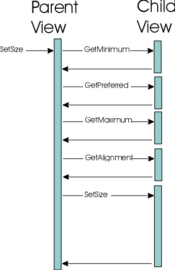

A view has the following responsibilities:
Participate in layout.
The view has a setSize method which is like doLayout and setSize in Component combined. The view has a preferenceChanged method which is like invalidate in Component except that one can invalidate just one axis and the child requesting the change is identified.
A View expresses the size that it would like to be in terms of three values, a minimum, a preferred, and a maximum span. Layout in a view is can be done independently upon each axis. For a properly functioning View implementation, the minimum span will be <= the preferred span which in turn will be <= the maximum span.
The minimum set of methods for layout are:
The setSize method should be prepared to be called a number of times (i.e. It may be called even if the size didn't change). The setSize method is generally called to make sure the View layout is complete prior to trying to perform an operation on it that requires an up-to-date layout. A view's size should always be set to a value within the minimum and maximum span specified by that view. Additionally, the view must always call the preferenceChanged method on the parent if it has changed the values for the layout it would like, and expects the parent to honor. The parent View is not required to recognize a change until the preferenceChanged has been sent. This allows parent View implementations to cache the child requirements if desired. The calling sequence looks something like the following:
The exact calling sequence is up to the layout functionality of the parent view (if the view has any children). The view may collect the preferences of the children prior to determining what it will give each child, or it might iteratively update the children one at a time.
