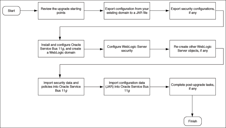

Figure 1-1 illustrates the Oracle Service Bus upgrade process. Review this chart to get familiar with the steps you will be required to take, based on your existing environment.
Figure 1-1 Flow Chart of the Oracle Service Bus Upgrade Process
Table 1-1 describes each of the steps in the upgrade process flow chart, which is shown in Figure 1-1. The table also provides information on where to get more information on each step in the process.
Table 1-1 Table Describing the Steps in the Oracle Service Bus Upgrade Process for 11g
