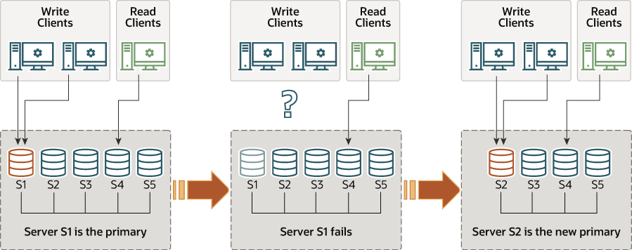

When a new primary server is elected (automatically or manually), it is automatically set to read/write, and the other group members remain as secondaries, and as such, read-only. The following diagram shows this process:
Figure 20.4 New Primary Election
Five server instances, S1, S2, S3, S4, and S5, are deployed as an interconnected group. Server S1 is the primary. Write clients are communicating with server S1, and a read client is communicating with server S4. Server S1 then fails, breaking communication with the write clients. Server S2 then takes over as the new primary, and the write clients now communicate with server S2.
