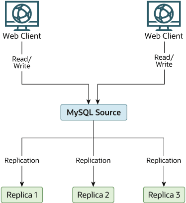

      mysqld. Assume that you have the structure
      shown in Figure 19.4, “Redundancy Using Replication, Initial Structure”.
      In this diagram, the Source holds the source
      database, the Replica* hosts are replicas, and
      the Web Client machines are issuing database
      reads and writes. Web clients that issue only reads (and would
      normally be connected to the replicas) are not shown, as they do
      not need to switch to a new server in the event of failure. For a
      more detailed example of a read/write scale-out replication
      structure, see Section 19.4.5, “Using Replication for Scale-Out”.

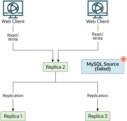

      Once the new replication setup is in place, you need to tell each
      Web Client to direct its statements to
      Replica 1. From that point on, all updates sent
      by Web Client to Replica 1
      are written to the binary log of Replica 1,
      which then contains every update sent to Replica
      1 since Source became unavailable.
The resulting server structure is shown in Figure 19.5, “Redundancy Using Replication, After Source Failure”.
