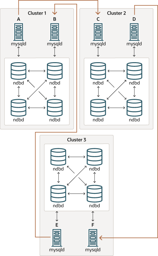

This type of circular replication setup is shown in the following diagram:
In this scenario, SQL node A in Cluster 1 replicates to SQL node C in Cluster 2; SQL node C replicates to SQL node E in Cluster 3; SQL node E replicates to SQL node A. In other words, the replication line (indicated by the curved arrows in the diagram) directly connects all SQL nodes used as sources and replicas.

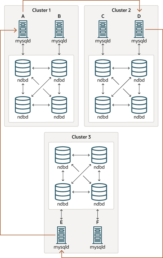

It should also be possible to set up circular replication in which not all source SQL nodes are also replicas, as shown here:
In this case, different SQL nodes in each cluster are used as
sources and replicas. However, you must not
start any of the SQL nodes with the
log_replica_updates system
variable enabled. This type of circular replication scheme for NDB
Cluster, in which the line of replication (again indicated by the
curved arrows in the diagram) is discontinuous, should be
possible, but it should be noted that it has not yet been
thoroughly tested and must therefore still be considered
experimental.
