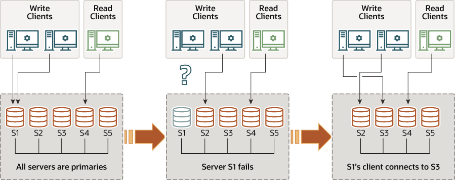

If a member stops accepting write transactions, for example, in the event of an unexpected server exit, clients connected to it can be redirected, or failed over, to any other member that is in read/write mode. Group Replication does not handle client-side failover itself, so you need to arrange this using a middleware framework such as MySQL Router 26.7, a proxy, a connector, or the application itself. Figure 20.5, “Client Failover” shows how clients can reconnect to an alternative group member if a member leaves the group.
Figure 20.5 Client Failover
Five server instances, S1, S2, S3, S4, and S5, are deployed as an interconnected group. All of the servers are primaries. Write clients are communicating with servers S1 and S2, and a read client is communicating with server S4. Server S1 then fails, breaking communication with its write client. This client reconnects to server S3.
