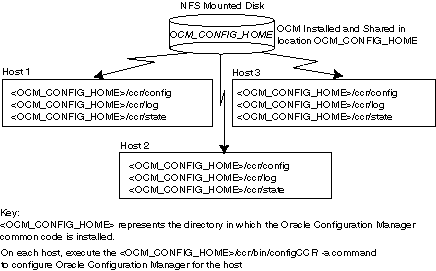

When the configuration is a single installation on multiple hosts, Oracle Configuration Manager is installed into the <ocm_install_root> directory. There is a set of common files and directories (shared home) and a set of installation-specific directories (log, state, config).
A directory is created for each host in <ocm_install_root>/ccr/hosts to store the installation-specific data.
Once installed and configured, Oracle Configuration Manager can collect configuration data for the <ocm_install_root> directory and the hosts on which it is installed.
In addition to collecting and uploading configuration data, Oracle Configuration Manager also checks if any software updates are available for the Oracle Configuration Manager. If updates are available, Oracle Configuration Manager downloads the updates and refreshes the Oracle Configuration Manager software installed in the <ocm_install_root> directory.
One common practice with this type of shared homes is to install software binaries on a writable (read/write) network file system on a master host. All hosts refer to this network resource for accessing the software. See Figure A-2.
Oracle Configuration Manager release 10.2.7 and later supports this type of shared home.

Another common practice with shared homes is to install software binaries on a network file system on a master host. These files are then locked down and exported for read-only access and shared between hosts. All hosts refer to this network resource for accessing the software. You must set up ORACLE_CONFIG_HOME to take advantage of this functionality.
Figure A-3 Single Software Installation on Multiple Hosts (Read Only)
Oracle Configuration Manager release 10.2.7 and later supports this type of shared home. However, because the binary directory is read-only, the automatic update feature of Oracle Configuration Manager must be disabled. Any subsequent updates must be performed manually.
