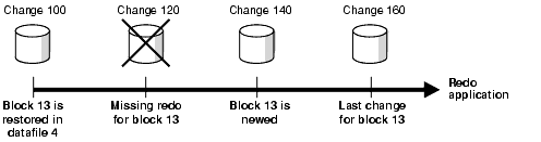

Assume that media recovery is performed on block 13 as depicted in the following figure.
Figure 19-1 Performing RMAN Media Recovery
After block recovery begins, RMAN discovers that change 120 is missing from the redo stream, either because the log block is corrupt or because the log cannot be found. RMAN continues recovery in the hope that block 13 will be newed later in the redo stream. Assume that in change 140 a user drops the table employees stored in block 13, allocates a new table in this block, and inserts data into the new table. At this point, the database formats block 13 as a new block. Recovery can now proceed with this block even though some redo preceding the newing operation was missing.
