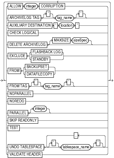

This subclause specifies various recovery options. Refer to recoverOptionList::= for the syntax diagram.
| Syntax Element | Description |
ALLOW integer CORRUPTION |
Specifies the number of corrupt blocks that can be tolerated while allowing recovery to proceed.You can set this parameter in case of redo log corruption. |
ARCHIVELOG TAG tag_name |
Specifies the tag for an archived log backup to be used during recovery. Tag names are not case sensitive and display in all uppercase. If the tagged backup does not contain all the necessary archived redo log files for recovery, then RMAN uses logs or incremental backups as needed from whatever is available. |
AUXILIARY DESTINATION'location' |
Specifies a location where auxiliary set datafiles, control files, and online redo logs are created during TSPITR if another location for an individual file is not explicitly specified.
If you do not specify See also: The chapter on TSPITR in Oracle Database Backup and Recovery User's Guide for more details about the auxiliary destination |
CHECK LOGICAL |
Tests data and index blocks that pass physical corruption checks for logical corruption, for example, corruption of a row piece or index entry. If RMAN finds logical corruption, then it logs the block in the alert.log and server session trace file.
The If the total number of physical and logical corruptions detected for a file is less than its |
DELETE ARCHIVELOG |
Deletes archived redo log files restored from backups or copies that are no longer needed. RMAN does not delete archived redo log files that were already on disk before the RESTORE command started. If you do not specify MAXSIZE, then RMAN deletes restored archived redo log files as they are applied.
Note: If archived redo log files are restored to the fast recovery area, then the |
MAXSIZE sizeSpec |
Does not use more than sizeSpec amount of disk space for restored archived redo log files. If recovery requires the restore of a log larger than the MAXSIZE value, then RMAN reports an error indicating that you should increase the MAXSIZE value. If MAXSIZE is smaller than the backup set containing the logs, then RMAN must read the backup set more than once to extract the logs. In this situation, RMAN issues a warning that MAXSIZE should be increased. |
EXCLUDE FLASHBACK LOG |
Specifies that the flashback logs should not be searched for blocks to restore. By default, RMAN searches the flashback logs if Flashback Database is enabled. |
EXCLUDE STANDBY |
Specifies that a physical standby database should not be searched for blocks to restore. By default, in a Data Guard environment RMAN searches the blocks from a physical standby database. |
FROM BACKUPSET |
Specifies that only backup sets should be restored. |
FROM DATAFILECOPY |
Specifies that only datafile image copies should be restored. |
FROM TAG tag_name |
Specifies the tag for an incremental backup to be used during recovery. If the tagged backup does not contain all the necessary incrementals for recovery, then RMAN uses logs or incremental backups as needed from whatever is available. Tag names are not case sensitive and display in all uppercase.
See Also: |
NOPARALLEL |
Specifies that media recovery should not be performed in parallel. Parallel execution is the default for RECOVER (see the description of the RECOVER ... PARALLEL option). |
NOREDO |
Suppresses the application of redo logs during recovery. Only incremental backups are applied.
One use of this option is to use incremental backups to update full backups of Note: Incremental backups of Another use is to update standby or duplicate databases. Incremental backups created with the |
PARALLEL |
Specifies parallel recovery (default).
By default, the database uses parallel media recovery to improve performance of the roll forward phase of media recovery. To override the default behavior of performing parallel recovery, use the In parallel media recovery, the database uses a "division of labor" approach to allocate different processes to different data blocks while rolling forward, thereby making the operation more efficient. The number of processes is derived from the Typically, recovery is I/O-bound on reads from and writes to data blocks. Parallelism at the block level may only help recovery performance if it increases total I/Os, for example, by bypassing operating system restrictions on asynchronous I/Os. Systems with efficient asynchronous I/O see little benefit from parallel media recovery. Note: The See Also: The description of the |
integer |
Specifies the integer degree of parallelism.
Each parallel thread may use one or two parallel execution servers. Typically, it is not necessary for you to specify the degree of parallelism. |
SKIP READONLY |
Omits read-only files from the recovery. |
TEST |
Initiates a trial recovery.
A trial recovery is useful if a normal recovery procedure has encountered a problem. It enables the database to look ahead into the redo stream to detect possible problems. The trial recovery applies redo in a way similar to normal recovery, but it does not write changes to disk and it rolls back its changes at the end of the trial recovery. Note: You can use this clause only if you have restored a backup taken since the last |
UNDO TABLESPACEtablespace_name |
Specifies a list of tablespaces with undo segments at the target time. Only for use with RECOVER TABLESPACE.
During TSPITR, RMAN needs information about which tablespaces had undo segments at the TSPITR target time. This information is usually available in the recovery catalog, if one is used. If there is no recovery catalog, or if the information is not found in the recovery catalog, then RMAN proceeds assuming that the set of tablespaces with undo segments at the target time is the same as the set of tablespaces with undo segments at the present time. If this assumption is not correct, TSPITR fails with an error. In such a case, you can use |
VALIDATE HEADER |
Reports and validates—but does not restore—the backups that RMAN could use to restore files needed for the recovery.
When you run See Also: The description of the |
