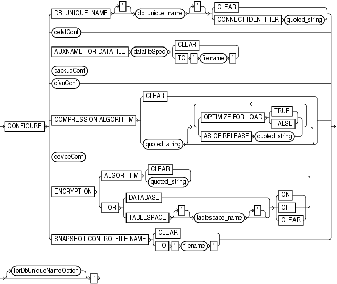

Syntax
configure::=
(datafileSpec::=, backupConf::=, cfauConf::=, deviceConf::=, forDbUniqueNameOption::=)

| Syntax Element | Description |
DB_UNIQUE_NAMEdb_unique_name{CLEAR | CONNECT IDENTIFIER'connect_string'} |
Specifies the net service name for the physical standby database specified by DB_UNIQUE_NAME. The CONNECT IDENTIFIER string must not include the database user name and password.
RMAN must also be connected to the primary database as When you run the Note: When the target database needs to connect to other standby or primary databases, it connects as the Suppose that you recently connected RMAN as Note: If the database specified by |
delalConf |
Configures an archived redo log deletion policy. |
AUXNAME FOR DATAFILEdatafileSpec TO 'filename' |
Configures the auxiliary filename for the specified target datafile to 'filename' (see Example 2-45). Specify CLEAR to unspecify the auxiliary filename.
If you are performing TSPITR or using For example, use this command during TSPITR if the datafiles are on raw disk and you must restore auxiliary datafiles to raw disk for performance reasons. Typically, you set the When renaming files with the See Also: Oracle Database Backup and Recovery User's Guide to learn how to perform RMAN TSPITR, and Oracle Database Backup and Recovery User's Guide to learn how to duplicate a database with RMAN |
backupConf |
Configures default backup options such as duplexing, optimization, excluding tablespaces, backup set sizes, and retention policies. |
cfauConf |
Configures control file autobackup settings. |
COMPRESSION ALGORITHM'algorithm_name' |
Specifies the algorithm that RMAN uses to create compressed backup sets.
The default compression algorithm setting is If, however, you have enabled the Oracle Database 11g Release 2 Advanced Compression Option, you can choose from the following compression levels:
Note: The compression ratio generally increases from LOW to HIGH, with a trade-off of potentially consuming more CPU resources. Since the performance of the various compression levels depends on the nature of the data in the database, network configuration, system resources and the type of computer system and its capabilities, Oracle cannot document universally applicable performance statistics. The decision as to which level is best must factor in on how balanced your system is regarding bandwidth into the CPU as well as the actual speed of the CPU. It is highly recommended that you run tests with the different compression levels on the data in your environment. Choosing a compression level based on your environment, network traffic characteristics (workload) and dataset is the only way to ensure that the backup set compression level can satisfy your organization's performance requirements and any applicable service level agreements. Note: The See Also: Oracle Database Reference entry for |
OPTIMIZE FOR LOAD
Specifies whether Oracle performs pre-compression block processing when compressed backups have been requested. TRUE is the default and FALSE enables pre-compression processing. The default behavior is not to perform pre-compression block processing. Such processing can consume extra CPU resources, and is not needed for blocks that contain all originally loaded data, and have never been the subject of single-row inserts and deletes. Specifying FALSE uses additional CPU resources to perform pre-compression block processing which consists of internal block cleanups and defragmentation that can result in improved levels of binary compression.
See Also: Oracle Database Backup and Recovery User's Guide to learn more about this option. |
AS OF RELEASE
'version' |
Specifies the release version. The version number uses the release number format and may use as many as 5 numbers to fully qualify the release. For example, 10.2.0.3.0 and 11.2 are acceptable values. This option ensures compression algorithm stability across future releases. |
deviceConf |
Configures default backup settings for devices, such as the default backup device, channel configurations for devices, default backup types for each device, and parallelism. |
ENCRYPTION |
Specifies transparent-mode encryption settings for the database or tablespaces.
This configuration applies unless overridden with the See Also: "Encryption of Backup Sets" to learn about the different modes of backup encryption, and Oracle Database Advanced Security Administrator's Guide to learn about transparent data encryption |
ALGORITHM 'algorithm_name' |
Specifies the default algorithm to use for encryption when writing backup sets. Possible values are listed in V$RMAN_ENCRYPTION_ALGORITHMS. The CLEAR option resets the database to the default value. |
FOR DATABASE [ON | OFF | CLEAR] |
Specifies whether to enable transparent encryption for the entire database. The options are as follows:
Note: You must use the |
FOR TABLESPACE tablespace_name [ON | OFF | CLEAR] |
Specifies whether to enable transparent encryption for one or more tablespaces. Configured settings for a tablespace always override configuration set at the database level. The options are as follows:
SNAPSHOT CONTROLFILENAME TO 'filename' |
Configures the snapshot control file name and location to 'filename'. If you run CONFIGURE SNAPSHOT CONTROLFILE NAME CLEAR, then RMAN sets the snapshot control file name to its default.
The default value for the snapshot control file name is platform-specific and dependent on Oracle home. For example, the default on some UNIX systems is The snapshot control file name is valid for this database only. Assume that you configure the snapshot control file name to a nondefault value on the primary database. If you use See Also: Oracle Database Backup and Recovery User's Guide for more information about snapshot control files |
forDbUniqueNameOption |
Creates an RMAN configuration in the recovery catalog for the database in a Data Guard environment specified by DB_UNIQUE_NAME. You can specify a single database with db_unique_name or use ALL for all databases in the recovery catalog that share the DBID of the target database (or DBID specified by the SET DBID command).

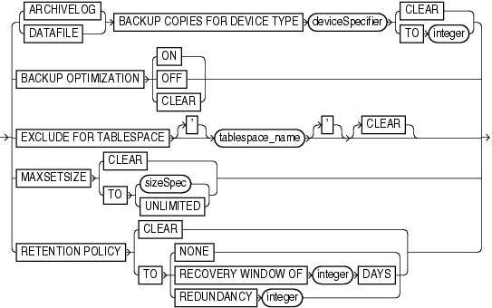

This subclause manages persistent configurations relating to the BACKUP command. One configuration is backup optimization. If you enable backup optimization, then RMAN does not back up a file to a device type if the identical file is already backed up on the device type.
Table 2-3 explains the criteria used by backup optimization to determine whether a file is identical and can potentially be skipped. The table also explains the algorithm that RMAN uses when backup optimization is enabled and it needs to determine whether to skip the backup of an identical file. If RMAN does not skip a backup, then it makes the backup exactly as specified.
Table 2-3 Backup Optimization Algorithm
{ARCHIVELOG | DATAFILE}BACKUP COPIES FOR DEVICE TYPEdeviceSpecifier TO integer |
Specifies the number of copies of each backup set for DATAFILE (both datafiles and control files) or ARCHIVELOG files on the specified device type (see Example 2-42). You can create from 1 (default) to 4 copies.
RMAN can duplex backups to either disk or tape, but cannot duplex backups to tape and disk simultaneously. When backing up to tape, ensure that the number of copies does not exceed the number of available tape devices. Also, if Control file autobackups are never duplexed. Also, duplexing is not permitted in the fast recovery area. If duplexing is specified in the |
BACKUP OPTIMIZATION[ON | OFF | CLEAR] |
Toggles backup optimization ON or OFF (default). Specify CLEAR to return optimization to its default value of OFF.
Backup optimization is enabled when all of the following conditions are met:
Optimization prevents RMAN from backing up a file to a device type if the identical file is already backed up on the device type. RMAN does not signal an error if backup optimization causes all files to be skipped during a backup. Note that the backup retention policy has an effect on which files backup optimization skips. For two files to be identical, their content must be exactly the same, as described in Table 2-3. Note that when you create backup pieces on disk or on media managed by Oracle Secure Backup, optimization excludes undo data from the backup when the data does not belong to an active transaction. Note: Note: You can override backup optimization with the See Also: Oracle Database Backup and Recovery User's Guide for a description of how RMAN determines that it can skip the backup of a file |
EXCLUDE FOR TABLESPACEtablespace_name [CLEAR] |
Excludes the specified tablespace from BACKUP DATABASE and RESTORE DATABASE commands (see Example 2-44). Note that you cannot exclude the SYSTEM tablespace.
The BACKUP command default does not exclude tablespaces. You must declare the option in order to use it. The exclusion is stored as an attribute of the tablespace and not to the individual datafiles. In this manner, the exclusion applies not only to the present set of datafiles but also to any files that are added to this tablespace in the future. If you run You can still back up an excluded tablespace by explicitly specifying it in a |
MAXSETSIZE |
Specifies the maximum size of each backup set created on a channel. Use the CLEAR option to return MAXSETSIZE to the default value of UNLIMITED.
Note: This option is ignored by |
TO sizeSpec |
Specifies the maximum size of each backup set as integer gigabytes, kilobytes, or megabytes. |
TO UNLIMITED |
Specifies no size limit for backup sets. |
RETENTION POLICY |
Specifies a persistent, ongoing policy for backup sets and copies that RMAN marks as obsolete, that is, not needed and eligible for deletion.
As time passes, RMAN marks backup sets and copies as obsolete according to the criteria specified in the retention policy. RMAN automatically deletes obsolete backup sets and copies in the fast recovery area when space is needed. RMAN does not automatically delete obsolete files outside the fast recovery area: you must manually execute For backups, the basic unit of the retention policy is a backup set (not a backup piece) or image copy. For example, Note: Use the |
TO NONE |
Disables the retention policy feature. RMAN does not consider any backup sets or copies as obsolete. |
TO RECOVERY WINDOW OF integer DAYS |
Specifies a time window in which RMAN should be able to recover the database.
The window stretches from the current time ( Note: The |
TO REDUNDANCY integer |
Specifies that RMAN should retain integer full or level 0 backups of each datafile and control file. The default retention policy setting is REDUNDANCY 1.
If more than The following scenario illustrates how redundancy works in an incremental backup strategy. Assume that the redundancy level is 1. You run a level 0 database backup at noon Monday, a level 1 cumulative backup at noon on Tuesday and Wednesday, and a level 0 backup at noon on Thursday. Immediately after each daily backup you run a Note: The |
