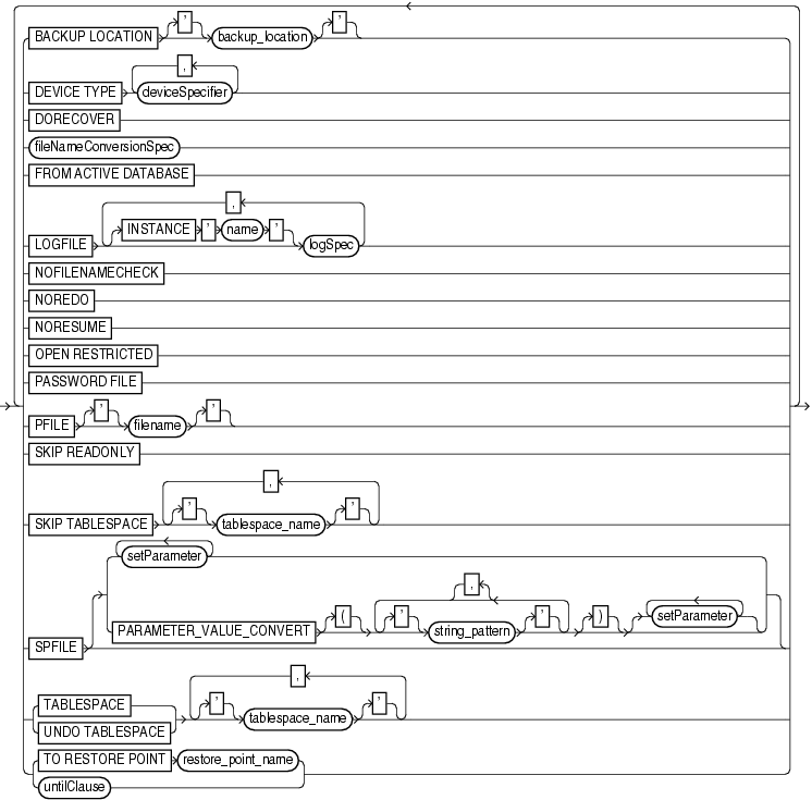

Syntax
duplicate::=
(deviceSpecifier::=, fileNameConversionSpec::=, logSpec::=, setParameter::=, untilClause::=)
setParameter::=
logSpec::=
sizeSpec::=
Semantics
This clause enables you to duplicate a database or tablespace. Refer to the duplicate::= diagram for the syntax.

INSTANCE 'inst_name' |
Creates online redo logs for the specified instance in a Real Applications Cluster (Oracle RAC) database. The instance name is a string of up to 80 characters.
RMAN automatically uses the thread mapped to the specified instance. If no This clause is relevant when you use |
logSpec |
Specifies the filenames and groups for the online redo log files.
See Also: |
NOFILENAMECHECK |
Prevents RMAN from checking whether the datafiles and online redo logs files of the source database are in use when the source database files share the same names as the duplicate database files. You are responsible for determining that the duplicate operation will not overwrite useful data.
This option is necessary when you are creating a duplicate database in a different host that has the same disk configuration, directory structure, and filenames as the host of the source database. For example, assume that you have a small database located in the /oracle/dbs/system_prod1.dbf /oracle/dbs/users_prod1.dbf /oracle/dbs/rbs_prod1.dbf Assume that you want to duplicate this database to If duplicating a database on the same host as the source database, then make sure that RMAN-10035: exception raised in RPC: ORA-19504: failed to create file "/oracle/dbs/tbs_01.f" ORA-27086: skgfglk: unable to lock file - already in use SVR4 Error: 11: Resource temporarily unavailable Additional information: 8 RMAN-10031: ORA-19624 occurred during call to DBMS_BACKUP_RESTORE.RESTOREBACKUPPIECE |
NOREDO |
Specifies that no archived redo log files should not be applied when recovering a consistent backup in any of the following scenarios:
NORESUME |
Disables the ability for RMAN to automatically recover from a failed duplication operation. using NORESUME in the first invocation of duplicate permanently prevents any subsequent duplicate command for the new database from using this automatic optimization.
See Also: Oracle Database Backup and Recovery User's Guide to learn more about the automated recovery from a failed |
OPEN RESTRICTED |
Enables a restricted session in the duplicate database by issuing the following SQL statement: ALTER SYSTEM ENABLE RESTRICTED SESSION. RMAN issues this statement immediately before the duplicate database is opened. |
PASSWORD FILE |
Specifies that RMAN should use the password file on the source database to overwrite the password file currently used by the auxiliary instance (see Example 2-72). This option is only valid when FROM ACTIVE DATABASE is specified; otherwise, RMAN signals an error.
If |
PFILE filename |
Specifies a text-based initialization parameter file used by the auxiliary instance (see Example 2-75). RMAN automatically shuts down and restarts the auxiliary instance during duplication. If the auxiliary does not use a server parameter file in the default location, then you must specify the text-based initialization parameter file that RMAN should use when starting the auxiliary instance. The initialization parameter file must reside on the same host as the RMAN client used to perform the duplication.
If the auxiliary instance uses a server parameter file in the default location, then you do not need to specify |
SKIP READONLY |
Excludes datafiles in current read-only tablespaces from the duplicate database. By default RMAN duplicates current read-only tablespaces.
If a tablespace is currently read/write, but you use Note: A record for the skipped read-only tablespace still appears in |
SKIP TABLESPACE tbs_name |
Excludes the specified tablespace from the duplicate database (see Example 2-75).
Note: You must not exclude SYS-owned objects or tablespaces with rollback segments, nor tablespaces containing materialized views. The set of tablespaces to be duplicated must be self-contained. If you need to duplicate a database when some backups of the source database do not exist, then
SPFILE |
Copies the server parameter file from the source database to the duplicate database. |
setParameter |
Sets the specified initialization parameters to the specified values. Refer to setParameter. |
PARAMETER_VALUE_CONVERT string_pattern [setParameter] |
Replaces the first string with the second string in all matching initialization parameter values. Refer to the description of PARAMETER_VALUE_CONVERT in dupOptionList. |
TABLESPACE tablespace_name |
Specifies which tablespaces should be included in the specified database. Unlike SKIP TABLESPACE, which specifies which tablespaces should be excluded from the duplicate database, this option specifies which tablespaces should be included and then skips the remaining tablespaces.
Note: RMAN automatically includes the |
UNDO TABLESPACE tablespace_name |
Specifies the names of the tablespaces with undo segments. This option is only required when a subset of tablespaces are being duplicated with the SKIP TABLESPACE and TABLESPACE clauses. You must provide the list of tablespaces with undo segments in the following cases:
TO RESTORE POINTrestore_point_name |
Specifies a restore point for backup-based duplication, with the SCN at which the restore point was created as the upper, inclusive limit. Because the limit is inclusive, RMAN selects only files that can be used to duplicate a database up to and including the corresponding SCN.
Note: The same restrictions that apply to |
untilClause |
Sets the end time, SCN, or log sequence number for point-in-time recovery in backup-based duplication (see Example 2-75). The UNTIL clause is not supported in active database duplication.
You can achieve the same result by running
This subclause specifies server parameter file values.
| Syntax Element | Description |
SET identifier string |
Sets the specified initialization parameters to the specified values (see Example 2-73). You can use SET to adjust for differences in memory, turn off replication options, and set other options for the duplicate database.
This RMAN processes Note: If |
COMMENT 'string' |
Specifies an optional comment for the parameter setting. |
RESET identifier string |
Deletes specified initialization parameters from the parameter file. You can use RESET to remove unneeded initialization parameters.
This |
This subclause specifies the online redo logs when creating a duplicate database that is not a standby database. Refer to the logSpec::= diagram for the syntax diagram.
If you do not specify LOGFILE, then RMAN uses LOG_FILE_NAME_CONVERT if it is set. If neither LOGFILE nor LOG_FILE_NAME_CONVERT is set, then RMAN uses the original redo log filenames of the source database for redo log files of the duplicate database. You must specify the NOFILENAMECHECK option in this case.
'filename' SIZE sizeSpec |
Specifies the filename of the online redo log member and the size of the file in kilobytes (K) or megabytes (M). The default is in bytes. |
REUSE |
Allows the database to reuse an existing file. If the file already exists, then the database verifies that its size matches the value of the SIZE parameter. If the file does not exist, then it is created. |
GROUP integer('filename', ...)SIZE sizeSpec |
Specifies the group containing the online redo log members, the filename of the online redo log member, and the size of the file in kilobytes (K) or megabytes (M). The default is in bytes. |
REUSE |
Allows the database to reuse an existing log. |
