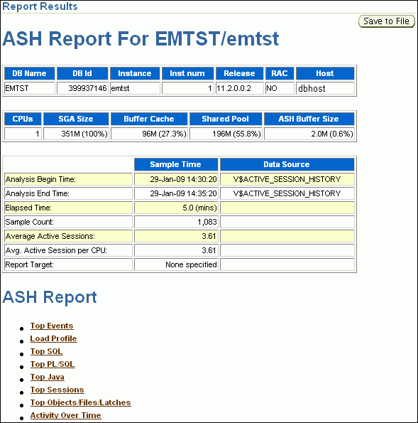

This section describes how to generate ASH reports using Oracle Enterprise Manager (Enterprise Manager).
On the Performance page, under Average Active Sessions, click Run ASH Report.
The Run ASH Report page appears.
Enter the date and time for the start and end of the time period when the transient performance problem occurred.
In this example, database activity increased between 2:30 p.m. and 2:35 p.m., so an ASH report should be created for that time period.
Click Generate Report.
The Processing: View Report page appears while the report is being generated.
After the report is generated, the ASH report appears under Report Results on the Run ASH Report page.
Optionally, click Save to File to save the report in HTML format for future analysis.
You can use an ASH report to identify the source of transient performance problems. The report is divided into titled sections. The following sections of the ASH report are useful places to begin the investigation:

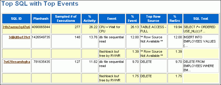

The Top SQL section of the report describes the top SQL statements of the sampled session activity. Use this information to identify high-load SQL statements that may be the cause of the transient performance problem. The Top SQL with Top Events subsection lists the SQL statements that accounted for the highest percentages of sampled session activity. The Sampled # of Executions column shows how many distinct executions of a particular SQL statement were sampled. To view the text of the SQL statements, click the SQL ID link.
Figure 7-4 shows that over half of DB time is consumed by three DML statements. These statements were run in the SQL*Plus module shown in Figure 7-3. The Top Sessions section should be analyzed to identify the sessions running these statements.

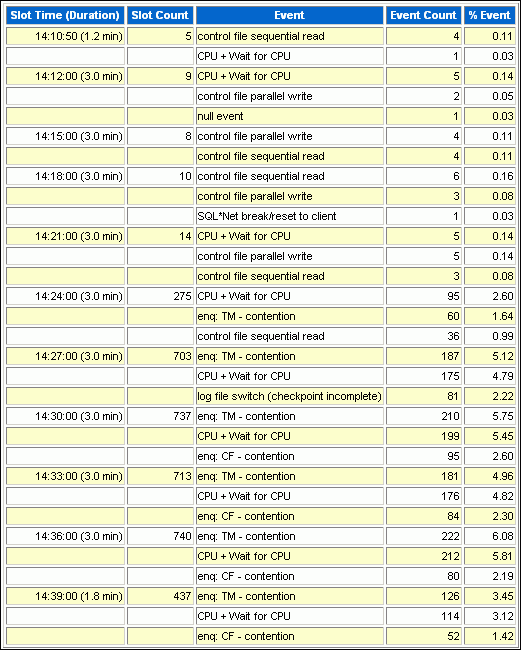

The Activity Over Time section of the ASH report is particularly useful for longer time periods because it provides in-depth details about activities and workload profiles during the analysis period. The Activity Over Time section is divided into time slots. The ASH report time span is divided into 10 time slots unless the time period is short or the data is sparse.
Figure 7-8 shows an activity report for the period between 2:10 p.m. and 2:40 p.m. The report indicates that the number of sampled sessions rose sharply in the fifth inner slot (2:24 p.m.) and stayed up. During this period CPU activity and lock enqueue waits increased dramatically.
Each time slot contains session and wait event activity, as described in Table 7-1.
Table 7-1 Activity Over Time
| Column | Description |
Slot Time (Duration) |
Duration of the slot |
Slot Count |
Number of sampled sessions in the slot |
Event |
Top three wait events in the slot |
Event Count |
Number of ASH samples waiting for the wait event |
% Event |
Percentage of ASH samples waiting for wait events in the entire analysis period |
All inner slots are the same number of minutes each for easy comparison. The first and last slots, called outer slots, are odd-sized because they do not have a fixed slot time.
In Figure 7-8, the first outer slot has a duration of 1.2 minutes, whereas the last outer slot has a duration of 1.8 minutes. The duration of each inner slot is 3.0 minutes.
When comparing the inner slots, perform a skew analysis by identifying spikes. A spike in the Slot Count column indicates an increase in active sessions and a relative increase in database workload. A spike in the Event Count column indicates an increase in the number of sampled sessions waiting for an event. Typically, when the number of active session samples and the number of sessions associated with a wait event increase, the slot may be the cause of the transient performance problem.
