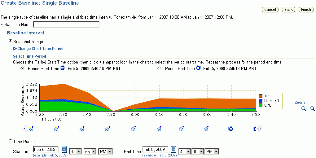

The Create Baseline: Single Baseline page appears.
In the Baseline Name field, enter a name for the baseline.

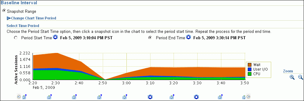

Under Baseline Interval, select whether to use a snapshot range or a time range for the baseline. Do one of the following:
To use a range, select Snapshot Range. Complete the following steps:
Under Select Time Period, select a start time for the baseline by selecting Period Start Time and the snapshot icon below the Active Sessions chart that corresponds to the desired start time.
Select an end time for the baseline by selecting Period End Time and the snapshot icon below the Active Sessions chart that corresponds to the desired end time.
Optionally, to view older snapshots that are not displayed below the Active Sessions chart, expand Change Chart Time Period. Enter the desired start date in the Chart Start Date field and the desired end date in the Chart End Date field, and click Go.
In this example, a snapshot range on February 5, 2009 from 3:10 p.m. to 3:30 p.m. is selected.
To use a time range, select Time Range. Complete the following steps:
In the Start Time fields, select a start time for the baseline.
In the End Time fields, select an end time for the baseline.
In the following example, a time range from 3:10 p.m. to 3:30 p.m. on February 6, 2009 is selected.
Click Finish.
The AWR Baselines page reappears with the newly created baseline displayed.

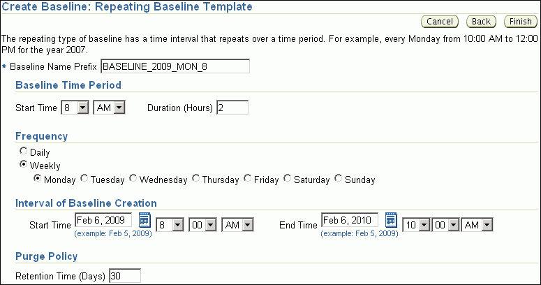

Select Repeating and then click Continue.
The Create Baseline: Repeating Baseline Template page appears.
In the Baseline Name Prefix field, enter a name prefix for the baseline.
Under Baseline Time Period, specify the time of the day that you want the baseline to begin collecting AWR data and the duration of the baseline collection.
Under Frequency, do one of the following:
Select Daily if you want the baseline to repeat on a daily basis.
Select Weekly if you want the baseline to repeat on a weekly basis, and then select the day of the week on which the baseline will repeat.
Under Interval of Baseline Creation, complete the following steps:
In the Start Time fields, select a date and time in the future when the data collection should begin.
In the End Time fields, select a date and time in the future when the data collection should end.
Under Purge Policy, enter the number of days to retain captured baselines.
Click Finish.
A baseline template with the same name as the baseline name prefix will be created. A baseline template is a specification that enables Oracle Database to automatically generate a baseline for a future time period.
This example creates a baseline that repeats weekly on Mondays from 8:00 a.m. to 10:00 a.m. from February 6, 2009 to February 6, 2010. Every captured baseline expires after 30 days.

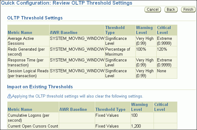

In Workload Profile, select one of the following options, depending on how you are using the database:
Primarily OLTP (pure transaction processing 24 hours a day)
Primarily Data Warehousing (query and load intensive)
Alternating (OLTP during the daytime and batch during the nighttime)
In this example, select Primarily OLTP.
Click Continue.
The Quick Configuration: Review OLTP Threshold Settings page appears.
Review the metric threshold settings and then click Finish.
You are returned to the Baseline Metric Thresholds page, with the Threshold Configuration tab selected. The metric threshold settings are displayed.

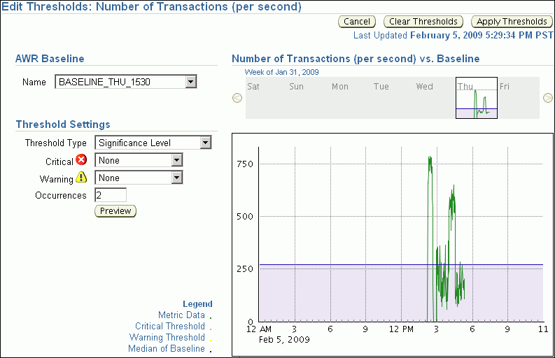

The Edit Thresholds: Number of Transactions (per second) appears.
The charts on this page provide simple and detailed views of metric activity for a 24-hour period. In the top simple chart, click a day to view the value of the metric plotted against a 24-hour period.
Under AWR Baseline, in the Name list, select either the default SYSTEM_MOVING_WINDOW or the name of a baseline created in the AWR Baselines page.
A baseline appears in the AWR Baseline list after you have scheduled statistics computation from the AWR Baselines page and the statistics have finished computing on the static baseline.
In this example, BASELINE_THU_1530 is selected.
The page refreshes to show the charts for the baseline that you selected.
In the Threshold Settings section, complete the following steps to change the settings:
In Threshold Type, leave Significance Level selected.
In Critical, select Extreme.
In Warning, select Very High.
In Occurrences, leave the current value.
Click Apply Thresholds.
You are returned to the Baseline Metric Thresholds page. This page shows the altered metric threshold settings.

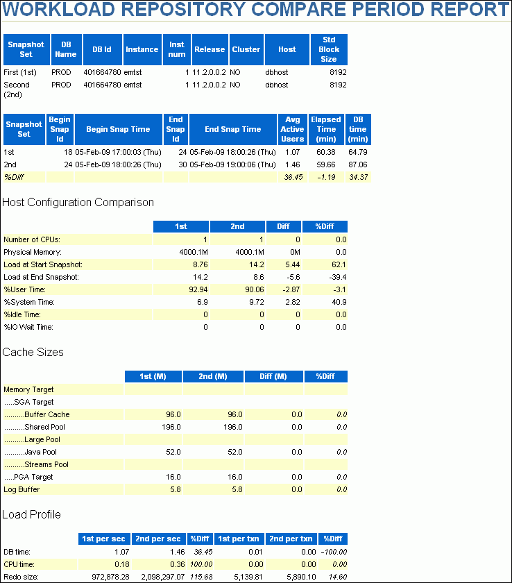

This section describes how to run the AWR Compare Periods reports using Enterprise Manager.
You can use AWR Compare Periods reports to compare the database performance between two time periods by:
When performance degradation occurs over time, you can run the AWR Compare Periods report to compare the degraded performance, captured as a new baseline or a pair of snapshots, to an existing baseline. You must have a baseline that represents the system operating at an optimal level. If an existing baseline is unavailable, then compare database performance between two periods of time using two arbitrary pairs of snapshots, as described in "Comparing Two Pairs of Snapshots".

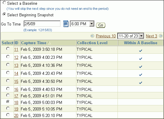

To compare to a pair of snapshots, select Select Beginning Snapshot and the beginning snapshot to use in the second period, and then click Next.
This example selects snapshot 18, taken on February 5, 2009 at 5:00 p.m.
The Compare Periods: Second Period End appears. Proceed to the next step.
Select the ending snapshot for the snapshot period that will be included in the report and then click Next.
In this example, snapshot 24, taken on Feb 5, 2009 at 6:00 p.m., is selected.
The Compare Periods: Review page appears.

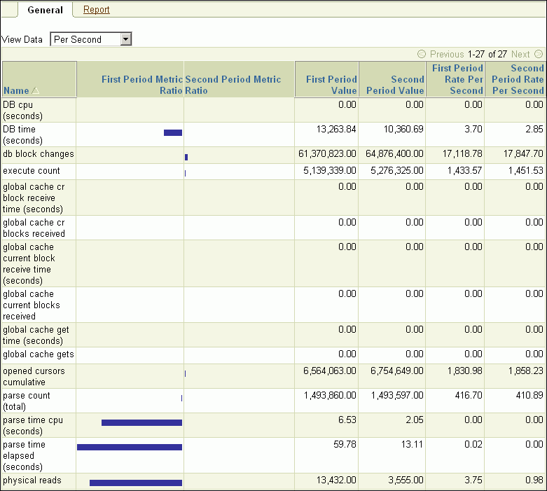

Review the periods to be included in the report and then click Finish.
The Compare Periods: Results page appears.

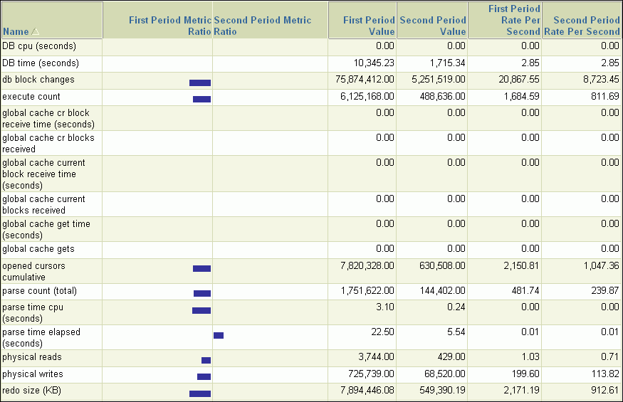

Data from the selected periods appears under the General subpage. You can view data per second or per transaction by selecting an option from the View Data list.
If the time periods have different lengths, then the data is normalized over database time before calculating the difference so that periods of different lengths can be compared.In this example, almost every metric shows that more resources were consumed in the first period. The bar graphs indicate the proportions of the values in the two periods. The absence of bars indicates equivalent values. The report for this example shows significantly more database block changes per second and parse time in the first period than in the second.
Click Report to view the report.
The Processing: View Report page appears while the report is being generated. After it completes, the report will appear. To change periods, click Change Periods. To save the report as an HTML file, click Save to File.

From the Go To Time list, select the time for the starting snapshot and then click Go.
This action filters the snapshots and displays only the snapshot taken at the start of the comparison period. The time in this example is at 2 p.m. on February 5.
Under Select Beginning Snapshot, select the starting point for the first snapshot period to be included in the report.
In this example, snapshot 1 is selected.
From the Actions list, select Compare Periods and click Go.
The Compare Periods: First Period End page appears.
Select the ending point for the first snapshot period to be included in the report and click Next.
In this example, snapshot 8, taken on February 5 at 3:20:10 p.m., is selected.
The Compare Periods: Second Period Start page appears.
Select the starting point for the second snapshot period to be included in the report and click Next. This snapshot is the third of four.
In this example, snapshot 20, taken on February 5 at 5:20 p.m., is selected.
The Compare Periods: Second Period End page appears.
Select the end point for the second period that will be included in the report and click Next.
In this example, snapshot 26, taken on February 5 at 6:20 p.m., is selected.
Review the selected periods to be included in the report and then click Finish.
In the following example, the first period shows more database activity, especially in parse time and physical reads, than the second period.
To view the report, click the Report tab.

Figure 8-1 shows a portion of an AWR Compare Periods report.
The AWR Compare Periods report is divided into the following sections:
The report summary is at the beginning of the AWR Compare Periods report, and summarizes information about the snapshot sets and loads used in the report. The report summary contains the following sections:
The Snapshot Sets section displays information about the snapshot sets used for this report, such as instance, host, and snapshot information.
In the example shown in Figure 8-1, the first snapshot period corresponds to the time when performance was stable on February 5 from 5:00 p.m. to 6:00 p.m. The second snapshot period corresponds to the time when performance degradation occurred on the same day from 6:00 p.m. to 7:00 p.m.
The Load Profile section compares the loads used in the two snapshot sets. Differences in the loads are quantified as percentages in the %Diff column.
In this example, the DB time per second was 36% higher in the second period. CPU time per second was 100% higher.
The Top 5 Timed Events section is one of the most useful sections in the report. This section displays the five timed events or operations that consumed the highest percentage of total DB time in each of the snapshot sets.
In this example, CPU time is about twice as much in the second period than in the first. The number of waits for TM locks in the second period is about eight times the number in the first.
The Host Configuration Comparison section compares the host configurations used in the two snapshot sets. For example, the report compares physical memory and number of CPUs. Differences in the configurations are quantified as percentages in the %Diff column.
The System Configuration Comparison section compares the database configurations used in the two snapshot sets. For example, the report compares the SGA and log buffer size. Differences in the configurations are quantified as percentages in the %Diff column.
