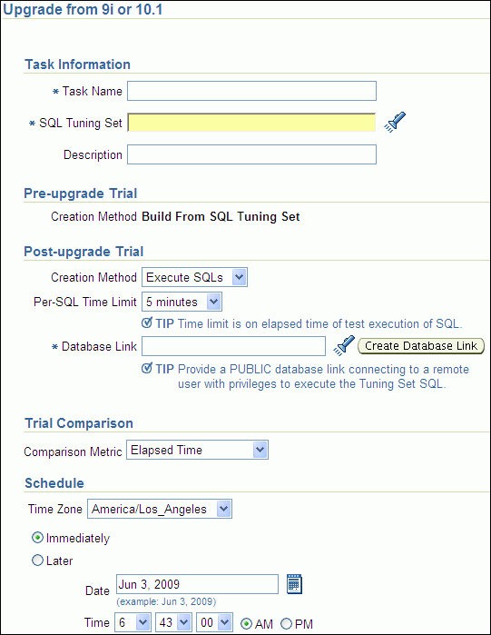

To test a database upgrade from Oracle9i Database or Oracle Database 10g Release 1 using SQL Performance Analyzer:
On the Software and Support page, under Real Application Testing, click SQL Performance Analyzer.
The SQL Performance Analyzer page appears.
Under SQL Performance Analyzer Workflows, click Upgrade from 9i or 10.1.
The Upgrade from 9i or 10.1 page appears.
Under Task Information:
In the Task Name field, enter the name of the task.
In the SQL Tuning Set field, enter the name of the SQL tuning set that was built.
Alternatively, click the search icon to search for the SQL tuning set using the Search and Select: SQL Tuning Set window.
The selected SQL tuning set now appears in the SQL Tuning Set field.
In the Description field, optionally enter a description of the task.
In the Creation Method field, select:
Execute SQLs to generate both execution plans and statistics for each SQL statement in the SQL tuning set by actually running the SQL statements remotely on the test system over a public database link.
Generate Plans to create execution plans remotely on the test system over a public database link without actually running the SQL statements.
In the Per-SQL Time Limit list, determine the time limit for SQL execution during the trial by performing one of the following actions:
Select 5 minutes.
The execution will run each SQL statement in the SQL tuning set up to 5 minutes and gather performance data.
Select Unlimited.
The execution will run each SQL statement in the SQL tuning set to completion and gather performance data. Collecting execution statistics provides greater accuracy in the performance analysis but takes a longer time. Using this setting is not recommended because the task may be stalled by one SQL statement for a prolonged time period.
Select Customize and enter the specified number of seconds, minutes, or hours.
In the Database Link field, enter the global name of a public database link connecting to a user with the EXECUTE privilege for the DBMS_SQLPA package and the ADVISOR privilege on the test system.
Alternatively, click the search icon to search for and select a database link, or click Create Database Link to create a database link using the Create Database Link page.
In the Comparison Metric list, select the comparison metric to use for the comparison analysis:
Elapsed Time
CPU Time
User I/O Time
Buffer Gets
Physical I/O
Optimizer Cost
I/O Interconnect Bytes
Optimizer Cost is the only comparison metric available if you generated execution plans only in the SQL trials.
To perform the comparison analysis by using more than one comparison metric, perform separate comparison analyses by repeating this procedure with different metrics.
Under Schedule:
In the Time Zone list, select your time zone code.
Select Immediately to start the task now, or Later to schedule the task to start at a time specified using the Date and Time fields.
Click Submit.
In the SQL Performance Analyzer Tasks section, the status of this task is displayed. To refresh the status icon, click Refresh. After the task completes, the Status field changes to Completed.

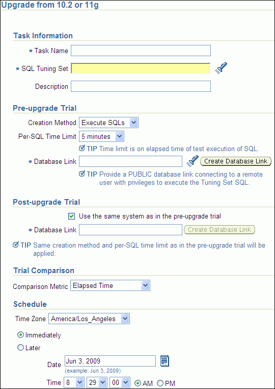

To test a database upgrade from Oracle Database 10g Release 2 or a newer release using SQL Performance Analyzer:
Under SQL Performance Analyzer Workflows, click Upgrade from 10.2 or 11g.
The Upgrade from 10.2 or 11g page appears.
Select 5 minutes.
Select Unlimited.
In the Database Link field, enter the global name of a public database link connecting to a user with the EXECUTE privilege for the DBMS_SQLPA package and the ADVISOR privilege on the pre-upgrade system.
Under Post-upgrade Trial:
Select Use the same system as in the pre-upgrade trial to use the same system for executing both the pre-upgrade and post-upgrade trials.
Oracle recommends using this option to avoid possible errors due to different system configurations. When using this option, you will need to upgrade the test database to the higher database version before the post-upgrade trial is executed.
In the Database Link field, enter the global name of a public database link connecting to a user with the EXECUTE privilege for the DBMS_SQLPA package and the ADVISOR privilege on the post-upgrade system.
Elapsed Time
CPU Time
User I/O Time
Buffer Gets
Physical I/O
Optimizer Cost
Under Schedule:
Click Submit.
