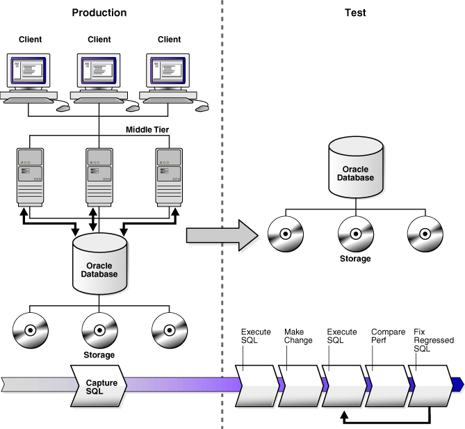

Analyzing the SQL performance effect of system changes using SQL Performance Analyzer involves the following steps, as illustrated in Figure 7-1:
Figure 7-1 SQL Performance Analyzer Workflow
Capture the SQL workload that you intend to analyze and store it in a SQL tuning set, as described in "Capturing the SQL Workload".
If you plan to use a test system separate from your production system, then perform the following steps:
Set up the test system to match the production environment as closely as possible.
Transport the SQL tuning set to the test system.
For more information, see "Setting Up the Test System".
On the test system, create a SQL Performance Analyzer task, as described in "Creating a SQL Performance Analyzer Task".
Build the pre-change SQL trial by test executing or generating execution plans for the SQL statements stored in the SQL tuning set, as described in "Measuring the Pre-Change SQL Performance"
Perform the system change, as described in "Making a System Change"
Build the post-change SQL trial by re-executing the SQL statements in the SQL tuning set on the post-change test system, as described in "Measuring the Post-Change SQL Performance"
Compare and analyze the pre-change and post-change versions of performance data, and generate a report to identify the SQL statements that have improved, remained unchanged, or regressed after the system change, as described in "Comparing Performance Measurements"
Tune any regressed SQL statements that are identified, as described in "Fixing Regressed SQL Statements".
Ensure that the performance of the tuned SQL statements is acceptable by repeating steps 6 through 8 until your performance goals are met.
For each comparison, you can use any previous SQL trial as the pre-change SQL trial and the current SQL trial as the post-change SQL trial. For example, you may want to compare the first SQL trial to the current SQL trial to assess the total change, or you can compare the most recent SQL trial to the current SQL trial to assess just the most recent change.
