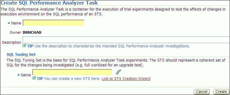

When creating a SQL Performance Analyzer task, you will need to select a SQL tuning set as its input source. The SQL tuning set will be used as the source for test executing or generating execution plans for SQL trials. Thus, performance differences between trials are caused by environmental differences. For more information, see "Creating a SQL Performance Analyzer Task".
This chapter described how to create a SQL Performance Analyzer task and contains the following topics:

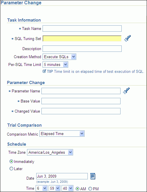

The parameter change workflow enables you to test the performance effect on a SQL workload when you change the value of a single environment initialization parameter. For example, you can compare SQL performance when the sort area size is increased from 1 MB to 2 MB.
After you select a SQL tuning set and a comparison metric, SQL Performance Analyzer creates a task and performs a trial with the initialization parameter set to the original value. SQL Performance Analyzer then performs a second trial with the parameter set to the changed value by issuing an ALTER SESSION statement. The impact of the change is thus contained locally to the testing session. Any regression or change in performance is reported in a system-generated SQL Performance Analyzer report.
To create an analysis task for other types of system changes, use the guided workflow instead, as described in "Using the Guided Workflow".To use the SQL Performance Analyzer parameter change workflow:
On the SQL Performance Analyzer page, under SQL Performance Analyzer Workflows, click Parameter Change.
The Parameter Change page appears.
In the Task Name field, enter the name of the task.
In the SQL Tuning Set field, enter the name of the SQL tuning set that contains the SQL workload to be analyzed.
Alternatively, click the search icon to search for a SQL tuning set using the Search and Select: SQL Tuning Set window.
The selected SQL tuning set now appears in the SQL Tuning Set field.
In the Description field, optionally enter a description of the task.
In the Creation Method list, determine how the SQL trial is created and what contents are generated by performing one of the following actions:
Select Execute SQLs.
The SQL trial generates both execution plans and statistics for each SQL statement in the SQL tuning set by actually running the SQL statements.
Select Generate Plans.
The SQL trial invokes the optimizer to create execution plans only without actually running the SQL statements.
In the Per-SQL Time Limit list, determine the time limit for SQL execution during the trial by performing one of the following actions:
Select 5 minutes.
The execution will run each SQL statement in the SQL tuning set up to 5 minutes and gather performance data.
Select Unlimited.
The execution will run each SQL statement in the SQL tuning set to completion and gather performance data. Collecting execution statistics provides greater accuracy in the performance analysis but takes a longer time. Using this setting is not recommended because the task may be stalled by one SQL statement for a prolonged time period.
Select Customize and enter the specified number of seconds, minutes, or hours.
In the Parameter Change section, complete the following steps:
In the Parameter Name field, enter the name of the initialization parameter whose value you want to modify, or click the Search icon to select an initialization parameter using the Search and Select: Initialization Parameters window.
In the Base Value field, enter the current value of the initialization parameter.
In the Changed Value field, enter the new value of the initialization parameter.
In the Comparison Metric list, select the comparison metric to use for the analysis:
If you selected Generate Plans in Step 5, then select Optimizer Cost.
If you selected Execute SQLs in Step 5, then select one of the following options:
Elapsed Time
CPU Time
User I/O Time
Buffer Gets
Physical I/O
Optimizer Cost
I/O Interconnect Bytes
To perform the comparison analysis by using more than one comparison metric, perform separate comparison analyses by repeating this procedure using different metrics.
In the Schedule section:
In the Time Zone list, select your time zone code.
Select Immediately to start the task now, or Later to schedule the task to start at a time specified using the Date and Time fields.
Click Submit.

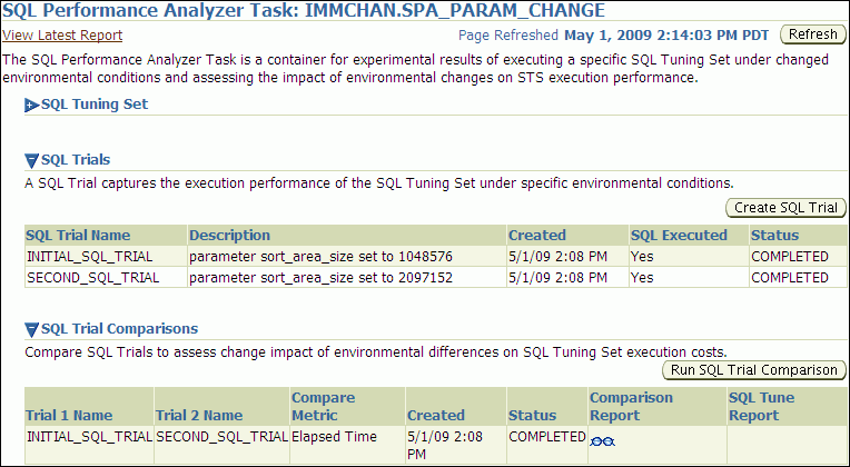

In the SQL Performance Analyzer Tasks section, the status of this task is displayed. To refresh the status icon, click Refresh. After the task completes, the Status field changes to Completed.
In the SQL Performance Analyzer Tasks section, select the task and click the link in the Name column.
The SQL Performance Analyzer Task page appears.
This page contains the following sections:
SQL Tuning Set
This section summarizes information about the SQL tuning set, including its name, owner, description, and the number of SQL statements it contains.
SQL Trials
This section includes a table that lists the SQL trials used in the SQL Performance Analyzer task.
SQL Trial Comparisons
This section contains a table that lists the results of the SQL trial comparisons
Click the icon in the Comparison Report column.
The SQL Performance Analyzer Task Result page appears.
Review the results of the performance analysis, as described in "Reviewing the SQL Performance Analyzer Report Using Oracle Enterprise Manager".
In cases when regression are identified, click the icon in the SQL Tune Report column to view a SQL tuning report.

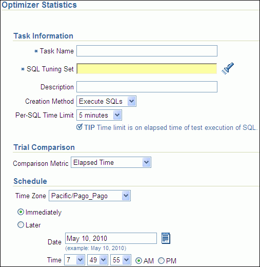

The optimizer statistics workflow enables you to analyze the effects of optimizer statistics changes on the performance of a SQL workload.
SQL Performance Analyzer tests the effect of new optimizer statistics by enabling pending optimizer statistics in the testing session. The first SQL trial measures the baseline SQL tuning set performance; the second SQL trial uses the pending optimizer statistics. You can then run a comparison report for the two SQL trials.
To use the optimizer statistics workflow:
On the SQL Performance Analyzer page, under SQL Performance Analyzer Workflows, click Optimizer Statistics.
The Optimizer Statistics page appears.
Select 5 minutes.
Select Unlimited.
In the Comparison Metric list, select the comparison metric to use for the comparison analysis:
Elapsed Time
CPU Time
User I/O Time
Buffer Gets
Physical I/O
Optimizer Cost
Optimizer Cost is the only comparison metric available if you chose to generate execution plans only in the SQL trials.
To perform the comparison analysis by using more than one comparison metric, perform separate comparison analyses by repeating this procedure with different metrics.
Ensure that pending optimizer statistics are collected, and select Pending optimizer statistics collected.

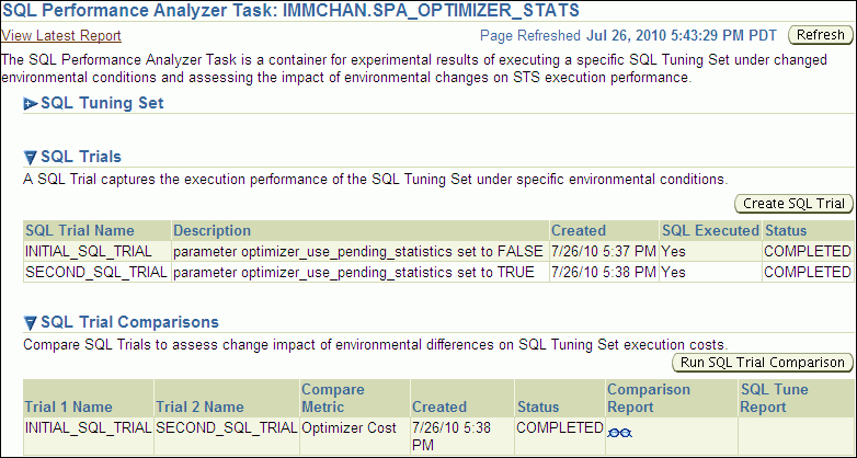

SQL Tuning Set
SQL Trials

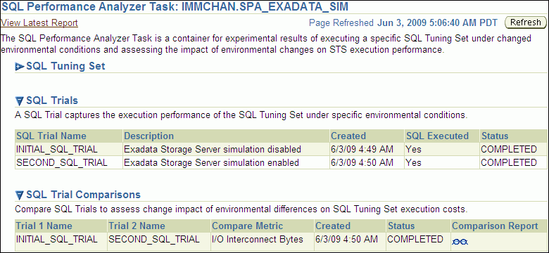

SQL Tuning Set
SQL Trials

To create an analysis task to test database initialization parameter changes, use the simplified parameter change workflow instead, as described in "Using the Parameter Change Workflow".To use the SQL Performance Analyzer task guided workflow:

On the Guided Workflow page, click the Execute icon for the Step 1: Create SQL Performance Analyzer Task based on SQL Tuning Set.
The Create SQL Performance Analyzer Task page appears.
In the Name field, enter the name of the task.
Under SQL Tuning Set, in the Name field, enter the name the SQL tuning set that contains the SQL workload to be analyzed.
Alternatively, click the search icon to select a SQL tuning set from the Search and Select: SQL Tuning Set window.
Click Create.
The Guided Workflow page appears.
The Status icon of this step has changed to a check mark and the Execute icon for the next step is now enabled.

This section describes how to run the Oracle Exadata simulation using APIs. For information about how SQL Performance Analyzer simulates the effects of an Exadata Storage Server installation on the performance of a SQL workload, see "Using the Exadata Simulation Workflow".
To enable Exadata simulation for an analysis task, call the SET_ANALYSIS_TASK_PARAMETER procedure before creating the post-change SQL trial, as shown in the following example:
EXEC DBMS_SQLPA.SET_ANALYSIS_TASK_PARAMETER(task_name => 'my_spa_task', -
parameter => 'CELL_SIMULATION_ENABLED', -
value => 'TRUE');
This will enable Exadata simulation when you create the post-change SQL trial, which can then be compared to the pre-change SQL trial that was created with Exadata simulation disabled.
Alternatively, you can run the Exadata simulation using the tcellsim.sql script:
At the SQL prompt, enter:
@$ORACLE_HOME/rdbms/admin/tcellsim.sql
Enter the name and owner of the SQL tuning set to use:
Enter value for sts_name: MY_STS Enter value for sts_owner: IMMCHAN
The script then runs the following four steps automatically:
Creates a SQL Performance Analyzer task
Test executes SQL statements with Exadata simulation disabled
Test executes SQL statements with Exadata simulation enabled
Compares performance and generates analysis report
