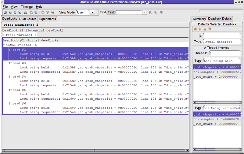

The following screen shot shows the Thread Analyzer's presentation of the deadlock information.
Figure 3-2 Deadlock Detected in din_philo.c
The Thread Analyzer reports two deadlocks for din_philo.c, one potential and the other actual. On closer inspection, you find that the two deadlocks are identical.
The circular chain involved in the deadlock is as follows:

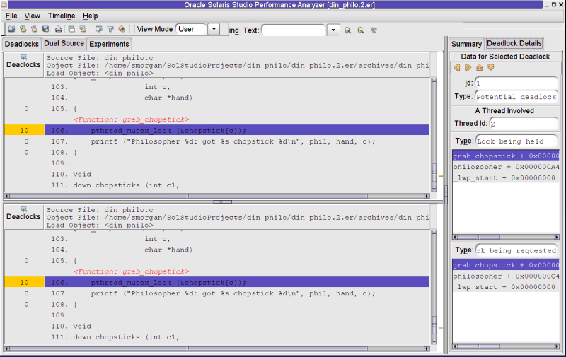

Select the first thread in the chain (Thread #2) and then click on the Dual Source tab to see where in the source code Thread #2 held the lock at address 0x215a0, and where in the source code it requested the lock at address 0x215b8. The following screen shot shows the Dual Source tab for Thread #2. The default metric (Exclusive Deadlocks metric) is shown to the left of each source line. This metric gives a count of the number of times a lock-hold or lock-request operation, which was involved in a deadlock, was reported on that line.
Figure 3-3 Potential Deadlock in din_philo.c

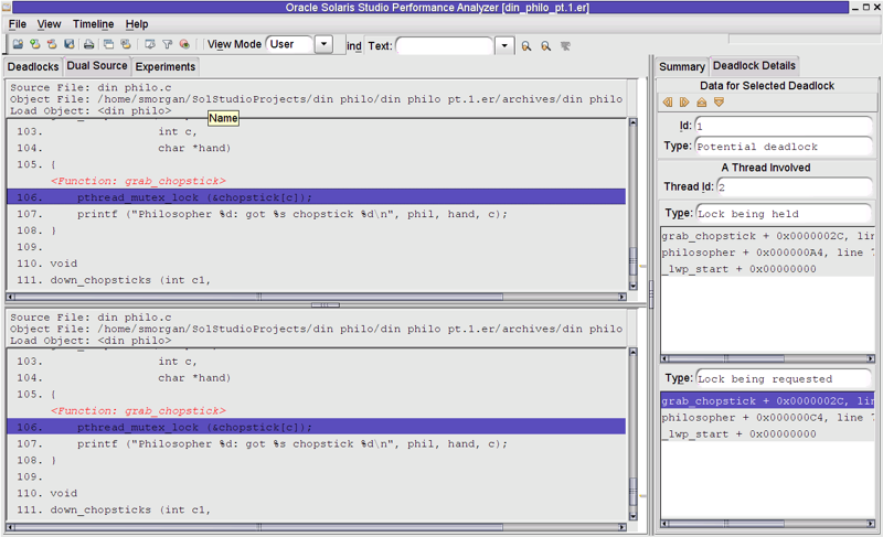

The dining philosophers program can avoid actual deadlock and terminate normally if you supply a large enough sleep argument. Normal termination, however, does not mean the program is safe from deadlocks. It simply means that the locks that were held and requested did not form a deadlock chain during a given run. If the timing changes in other runs, an actual deadlock can occur. The following listing shows a run of the dining philosophers program that terminates normally because of the 40 second sleep time. However, the er_print utility and the Thread Analyzer report potential deadlocks.
% cc -g -o din_philo_pt din_philo.c % collect -r deadlock -o din_philo_pt.1.er din_philo_pt 40 Creating experiment database tha.2.er ... Philosopher 0 is done thinking and now ready to eat. Philosopher 2 is done thinking and now ready to eat. Philosopher 1 is done thinking and now ready to eat. Philosopher 3 is done thinking and now ready to eat. Philosopher 2: got right chopstick 2 Philosopher 3: got right chopstick 3 Philosopher 0: got right chopstick 0 Philosopher 4 is done thinking and now ready to eat. Philosopher 0: got left chopstick 1 Philosopher 0: eating. Philosopher 3: got left chopstick 4 Philosopher 3: eating. Philosopher 0: got left chopstick 1 Philosopher 0: eating. Philosopher 0: got right chopstick 0 Philosopher 2: got left chopstick 3 Philosopher 2: eating. ... Philosopher 4: got right chopstick 4 Philosopher 3: got right chopstick 3 Philosopher 2: got right chopstick 2 Philosopher 4: got left chopstick 0 Philosopher 4: eating. Philosopher 4 is done eating. Philosopher 3: got left chopstick 4 Philosopher 3: eating. Philosopher 0: got right chopstick 0 Philosopher 0: got left chopstick 1 Philosopher 0: eating. Philosopher 3 is done eating. Philosopher 2: got left chopstick 3 Philosopher 2: eating. Philosopher 0 is done eating. Philosopher 2 is done eating. Philosopher 1: got right chopstick 1 Philosopher 1: got left chopstick 2 Philosopher 1: eating. Philosopher 1 is done eating. % Execution terminated normally

The following screen shot shows the potential deadlock information in the Thread Analyzer interface.
Figure 3-4 Potential deadlock in dino_philo.c
