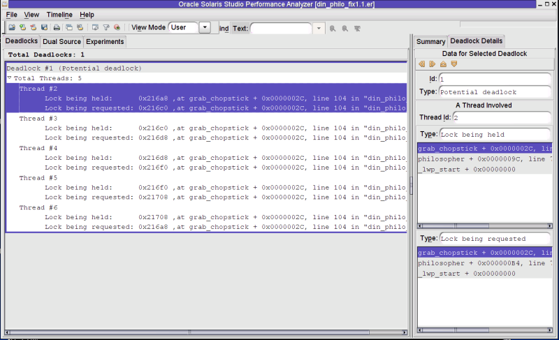

Even when using the system of tokens, the Thread Analyzer reports a potential deadlock for this implementation even though none exists. This is a false positive. Consider the following screen shot which details the potential deadlock.
Figure 3-5 False Positive Report of a Potential Deadlock

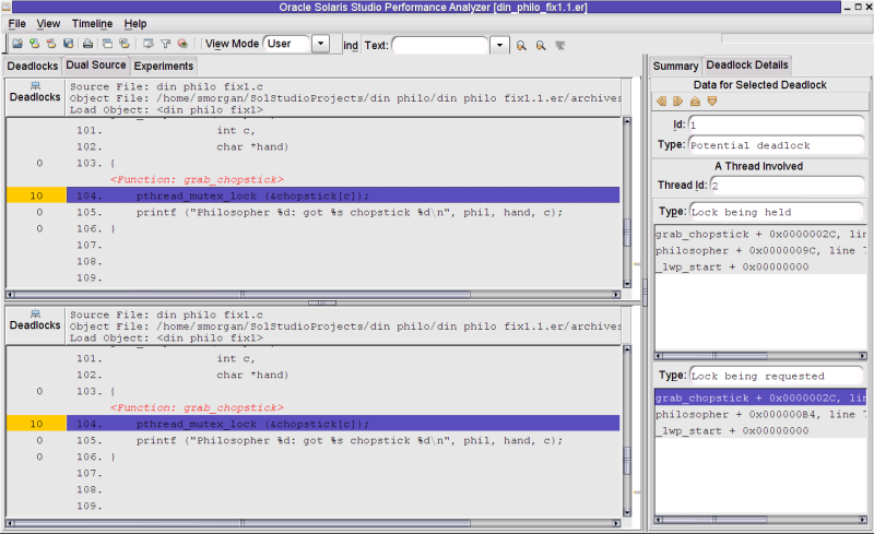

Select the first thread in the chain (Thread #2) and then click on the Dual Source tab to see the source code location in which Thread #2 held the lock at address 0x216a8, and where in the source code it requested the lock at address 0x216c0. The following figure shows the Dual Source tab for Thread #2.
Figure 3-6 False Positive Potential Deadlock's Source
The get_token() function in din_philo_fix1.c uses a while loop to synchronize the threads. A thread will not leave the while loop until it successfully gets a token (this occurs when num_can_eat is greater than zero). The while loop limits the number of simultaneous diners to four. However, the synchronization implemented by the while loop is not recognized by the Thread Analyzer. It assumes that all five philosophers attempt to grab the chopsticks and eat concurrently, so it reports a potential deadlock. The following section details how to limit the number of simultaneous diners by using synchronizations which the Thread Analyzer recognizes.

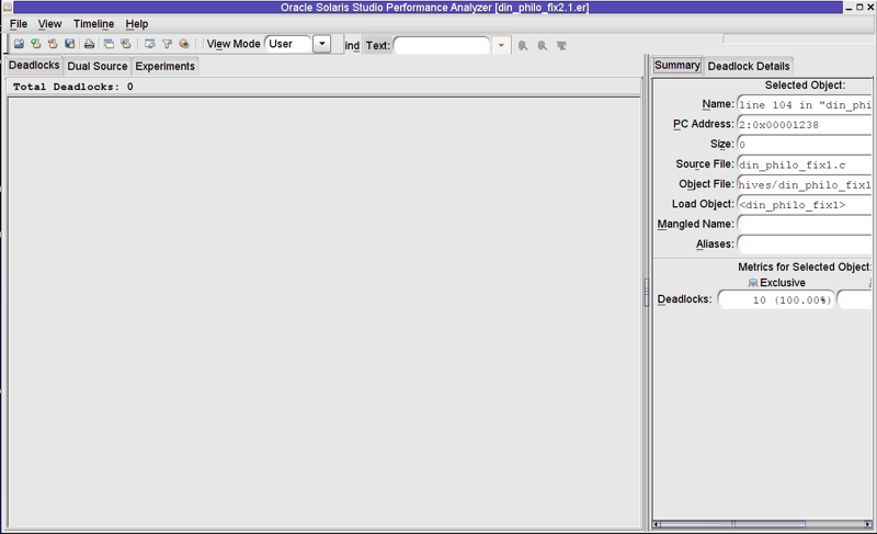

You will find that the Thread Analyzer does not report any actual or potential deadlocks in the din_philo_fix2.1.er experiment, as the following figure shows:
Figure 3-7 Deadlocks Not Reported in dino_philo_fix2.c
