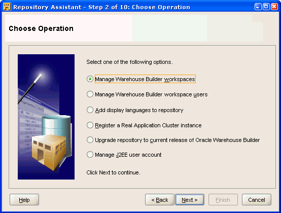

On the Choose Operation screen, select Manage Warehouse Builder Workspaces. Click Next.

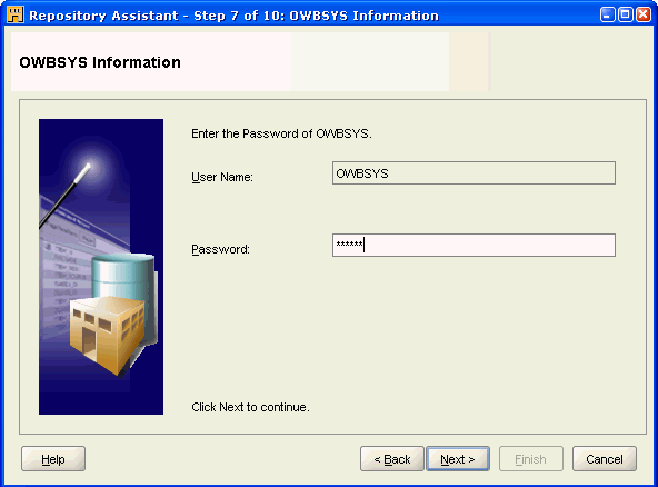

In the OWBSYS Information screen, enter the OWBSYS Password. Click Next.
Note that you need these credentials to seed the OWBSYS schema.

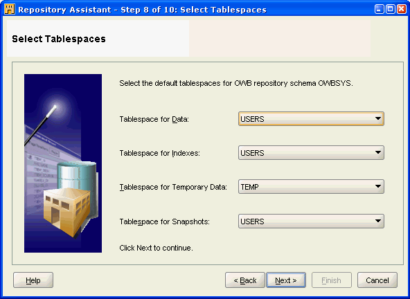

On the Select Tablespaces screen, enter the following information:
Tablespace for Data (USERS, or the name of the desired tablespace)
Tablespace for Indexes (USERS, or the name of the same tablespace)
Tablespace for Temporary Data (TEMP)
Tablespace for Snapshots (USERS, or the name of the same tablespace)
Click Next.
Note that this step allows you to change the default tablespace details. The OWB repository is stored in the OWBSYS schema, but you must identify what tablespaces are used to store OWBSYS and certain other objects, like snapshots. You may choose tablespaces other than USERS, depending on your storage management strategy.

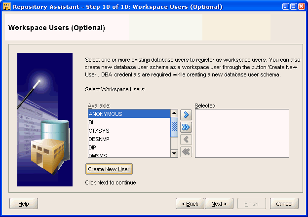

On the Workspace Users (Optional) screen, select the appropriate existing users from the Available list add them to the Selected list.
[Optional] Click Create New User to make new users who can access OWB. This takes you to step 15.
Click Next. This takes you to step 17.
