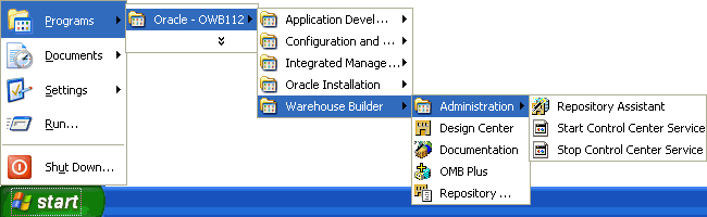

To create a workspace:
Start the repository assistant from the Start menu, selecting Program Files, then Oracle - OWB112, then Warehouse Builder, then Administration, then Repository Assistant.
On the Welcome screen of the Repository assistant, click Next.
