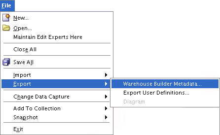

  2. From the File menu, select Export and then Warehouse Builder Metadata.

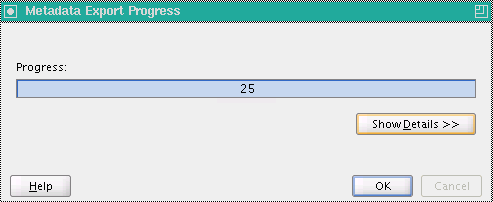

  6. When the export completes successfully (see "Metadata Progress Dialog Box"), in the Metadata Export Dialog box, click OK.

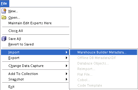

  1. From the Design Center, select File, select Import, and then select Warehouse Builder Metadata.

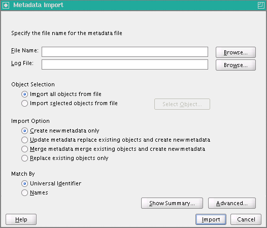

  3. In the Metadata Import dialog box:
    • Click Browse to specify the File Name (name and location) of the import file.
    • Click Browse to specify the Log File (name and location).
    • Under Object Selection, choose either Import all objects from file or Import selected objects from file.
    • Under Import Option, select one of Create new metadata only, Update metadata replace existing objects and create new metadata, Merge metadata merge existing objects and create new metadata, or Replace existing objects only.
    • Under Match by, select one of Universal Identifier or Names.
    • [Optional] Click Show Summary to view a summary of the contents of the export file. See "File Summary Dialog Box".

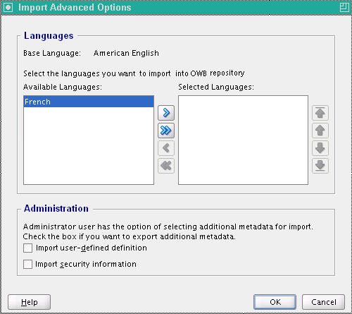

    • [Optional] Click Advanced to import metadata for additional languages, security information, or user-defined properties. See "Import Advanced Options Dialog Box".
    See "Metadata Import Dialog Box".

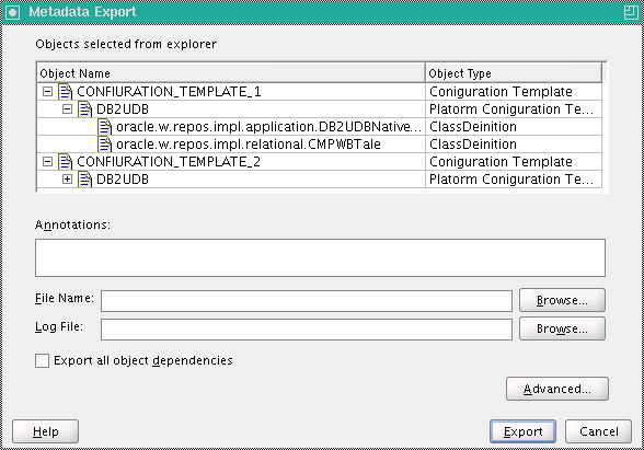

Metadata Export Dialog Box
The Metadata Export dialog box displays the names and the types of the exported objects.
Description of exporting_03.gif follows
The Metadata Export dialog box also contains the following items:
  • Annotations: Use this field to enter any comments about the file that contains the exported objects.
  • File Name: Displays a default path and file name for the export file. You can retain this default or specify a directory and file name. Type the name of the export file to create or click Browse to locate a directory or file. The file name extension commonly used is .mdl.
  • Log File: Use this field to specify the file name and path for the log file that stores diagnostic and statistical information about the export. See "Metadata Loader Log File"
  • Export all object dependencies: Select this option to export all the dependencies of the objects being exported. For example, when you export a table, the location to which the table is deployed is also exported.
    Note that public objects such as locations, public transformations, public experts, public icon sets, or public data rules belong to a project called PUBLIC_PROJECT. You can export the PUBLIC_PROJECT and its objects if the selected exported objects have a dependency on the public objects and if you select the Export all object dependencies option.
  • Advanced: Use the Advanced button to export additional metadata such as user-defined properties, security information, and additional languages. See "Export Advanced Options Dialog Box".
Click Export to export the metadata for the selected objects. The Metadata Export Progress dialog box is displayed. See "Metadata Export Dialog Box" for more information about the contents of this dialog box.

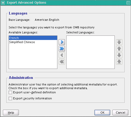

Use the Export Advanced Options dialog box to export any of the following:
  • Additional language metadata
  • User-defined definitions
  • Security information
Description of exporting_04.gif follows
This dialog box contains two sections: Languages and Administration.
Languages
The Base Language field displays the base language of the repository. Warehouse Builder exports and imports data in the base language.
You can specify additional languages to export and import objects that contain translations for their business names and descriptions. The Available Languages list displays the list of languages that are installed in the repository. To export or import additional languages, select the language and click the arrows to move the language from the Available Languages list to the Selected Languages list. You may choose multiple languages at the same time by holding down the Control or Shift key while making your selection.
Note that the Available Languages list contains language entries only if you installed additional languages in the repository. For example, the repository has American English as base language, and additional languages French and Simplified Chinese. While exporting metadata from the repository, you may select French as the additional language. The Metadata Export Utility then exports the base language of the object, American English, and the additional language French for objects that contain a French translation. Note that additional languages are exported for an object only if they contain translations for the business names and descriptions.
Administration
You may export additional metadata if you have administrator privileges. The options you may choose to export additional metadata are as follows:
  • Export user-defined definition: Select this option to export the definitions of user-defined objects and user-defined properties.
  • Export security information: Select this option to include security information such as object privileges or role assignments made to users. See Chapter 13, "Managing Security" for more information about security.
After you specify the options on the Export Advanced Options dialog box, click OK to close this dialog box and return to the Metadata Export dialog box.

Use the Metadata Import dialog box to specify the information required to import metadata in an export file.
Description of importing_03.gif follows
Specify the following information on this dialog box:
  • File Name: Type the name of the MDL file or click Browse to locate the MDL file you want to import.
  • Log File: Type the name of the log file, along with the path, that will store diagnostic and statistical information about the import. You can also click Browse to locate the log file. See "Metadata Loader Log File" for more information about log files.
  • Object Selection: The Metadata Import Utility enables you to select the objects that you want to import from the MDL file. The Object Selection section contains the following options:
    • Import all objects from file: Select this option to import all objects contained in the export file.
    • Import selected objects from file: Select this option to import only some of the objects contained in the MDL file. Click Select Objects to select the objects that you want to import. The Import Object Selection dialog box is displayed.
      The Import Object Selection dialog box is displayed contains two sections: Available and Selected. The Available section contains primary objects such as projects, modules, tables, views, and connections, which are specified in the MDL file. Expand the nodes in this section to view the objects they contain. When you select a node, all the objects that it contains are included in the import. For example, if you select a module node, all the objects contained in the module are imported. Use the shuttle buttons to move the selected objects from the Available section to the Selected section.
      The MDL file that is imported may also contain administrative objects. To import these administrative objects, you must have administrative privileges. If these privileges are absent, the following occurs:
      • The Available section of the Import Object Selection Page dialog box does not display any administrative objects that the MDL file may contain.
      • The Import Utility displays an alert that the user does not have the required administrative privileges to perform the import, provided the MDL file contains only administrative objects.
  • Import Option: Use the Import Option section to select the import mode. You can select one of the following options for the import mode:
    • Create new metadata only: This option, known as create mode, adds new objects to a workspace.
    • Update metadata (replace existing objects and create new metadata): This option, known as update mode, adds new objects to a workspace and also replaces existing objects with those in the MDL file that is imported.
    • Merge metadata (merge existing objects and create new metadata): When you select this option, known as merge mode, the MDL adds new objects and overwrites existing objects in the workspace only if they differ from those in the MDL file. The merge mode does not delete existing objects. Note that you cannot import metadata using the merge mode for mappings, pluggable mappings, and data auditors.
    • Replace existing objects only: This option, known as replace mode, replaces existing objects in your workspace but does not add new objects. In this mode, the Metadata Import Utility overwrites any existing metadata.
    When you import metadata using the update or the replace modes, the import completely replaces the child objects of existing objects, so that the final object is exactly the same as the source object. Any existing children of a repository object that are not replaced or added are deleted. This occurs regardless of whether a child object occurs in a mapping or is a foreign, primary, or unique key column in a table or view.
    For example, in the MDL export file, the CUST table contains three columns with the physical names: last_name, first_name, and middle_init. In the workspace, the same table exists, and contains four columns with the physical names: last_name, first_name, status, and license_ID. During a replace operation, the columns last_name and first_name are replaced, column middle_init is added, and column status and license_ID are deleted. The final result is that the CUST table in the workspace contains the same metadata from the CUST table in the export file.
    Note that using the replace and update modes may cause loss of data constraints, metadata physical property settings, data loading properties, and mapping attribute connections. If you choose to use replace or update modes, ensure that you have the option of restoring the workspace from a backup.
  • Match By: When you use the metadata import utility, it first searches the workspace for metadata objects that exist in the workspace and compares them to those in the import file. To compare metadata in the import file with the existing workspace metadata, it uses the matching criteria. How the comparison is made is determined by the import mode and by the chosen search method.
    The Match By section provides the following options for matching criteria. By default, the import utility searches by UOIDs. Note that MDL import does not support merging existing mappings.
    • Universal Identifier option searches the workspace using the Universal Object Identifiers (UOIDs) of the objects that are imported. The Metadata Import Utility uses the UOIDs to determine whether an object must be created, replaced, or merged during the import operation. Use this method if you want to maintain UOIDs across different workspaces even when object names in the target workspace have changed.
    • Names option searches the workspace using the names of the objects that are imported. Physical names are exported to the export file; the physical name determines whether an object must be created, replaced, or merged during an import operation. Use this method if you want to create new UOIDs for those objects when object names in the target schema change.
Use the Import Advanced Options dialog box to import any of the following:
Description of importing_04.gif follows
Languages
The Base Language displays the base language of the repository. By default, data is imported in the base language.
You can specify additional languages to import. The Metadata Import Utility imports the translations of the object for business name and description. The Available Languages list displays the list of languages that are specified in the MDL file. For example, the MDL file contains the additional languages French and Simplified Chinese, but your repository contains only French as the additional language. Then the Available Languages list displays only French. Select the language you want to import and click the arrow to move the language to the Selected Languages list. See "Import Different Base Languages".
Administration
This option is available only if you have administrator privileges and the metadata exists in the MDL file used for import. The options you may choose to import additional metadata are as follows:
  • User-defined definitions: To import the definitions for the user-defined objects and the user-defined properties, select the Import User-defined definitions option.
  • Security Grants: Select Import security information to import security information such as object privileges and role assignments made to users.
If the MDL file contains any of these objects, then you can import this additional metadata.
When you import an MDL file into a new workspace, if you want to inherit the security information from the old workspace, you must import the security information before you import other objects. To do this you need to be connected to the workspace as a user with administrator privileges.
After you make your selections on the Import Advanced Options dialog box, click OK to save your selections and return to the Metadata Import dialog box.
The Metadata Progress dialog box is titled either Metadata Export Progress, Metadata Import Progress, or Metadata Upgrade Progress. It displays a progress bar that indicates the relative completeness (as a percentage) of the metadata export, import, or upgrade activity. If the operation is successful, a message indicating this displays above the progress bar; it may also display that an error occurred.
Description of exporting_05.gif follows
To view detailed information about the metadata export or import, click Show Details. The message log is displayed. The message log contains the following information:
  • Start time of the export or import
  • Names and types of objects exported or imported
  • Warning or error messages
  • End time of the export or import
  • Location of the export or import log file
  • Total export or import time in hh:mi:ss or milliseconds
You can hide the message log by clicking Hide Details.
To view details about the exported or imported objects, click Show Statistics. The Metadata Results dialog is displayed. See "About Metadata Loader Results".
Note that you can cancel an in-progress Metadata Export or Import by clicking Cancel.
Once the export or import completes, click OK in the Metadata Progress dialog.
