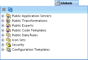

About the Security Service
Only users with administrative privileges can access the security service under Globals Navigator to manage users and roles of the security policy in Warehouse Builder.
When you install Warehouse Builder and then use the Repository Assistant to create a design repository, Warehouse Builder makes the design repository owner the default administrator. The first time you start the Design Center after installation, you must log in as the design repository owner. You can then define additional administrators or other users as necessary.
When you log into the Warehouse Builder Design Center as the design repository owner, it displays the Globals Navigator.
This illustration is described in the surrounding text.

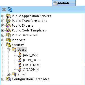

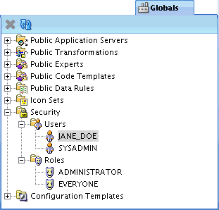

To view default security settings:
  1. In Globals Navigator, expand Security.
  2. Expand Users, and then expand Roles.
    Description of security_01.gif follows
  3. Notice that there are two predefined roles, ADMINISTRATOR and EVERYONE.
  4. The one predefined user is the design repository owner; it is assigned the ADMINISTRATOR role by default.

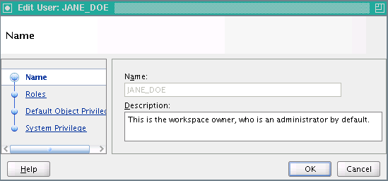

    To view or edit the details for a user, in the globals Navigator, under Security and then under Users, select that and double-click the user. The Edit User screen appears.
    Description of security_02.gif follows

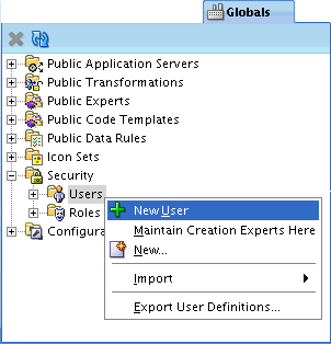

  1. In the Globals Navigator, under Security, right-click Users and select New User.

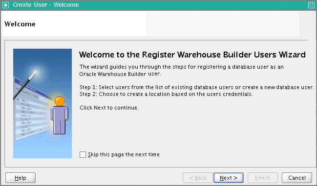

    The Create User: Welcome screen appears.
  2. On the Create User Welcome screen, click Next.

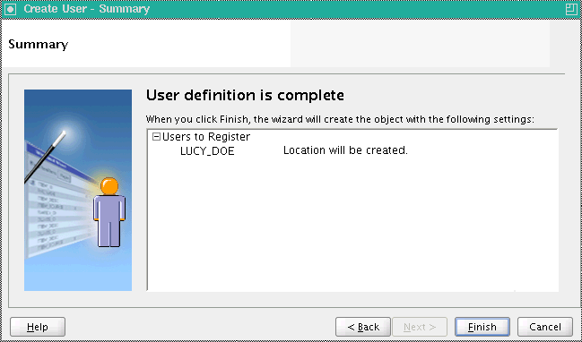

  5. On the Summary screen, review the new user definition.
    Click Finish.

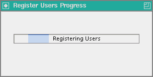

  6. The Register Users Progress appears. It disappears when registration is complete.
    Description of new_user_06.gif follows

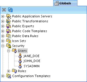

  7. Note that your new user is now listed under Users.
    Description of new_user_07.gif follows

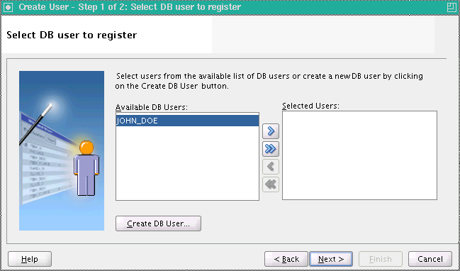

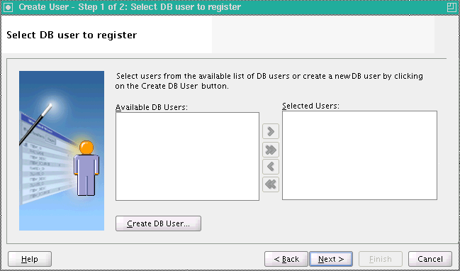

  3. On the Select DB user to register screen, click Create DB User.
    Description of new_user_08.gif follows

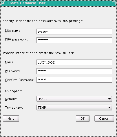

  4. On the Create Database User screen, enter the DBA password, and the Name and Password (with confirmation) of the new user.
    Click OK.
    Note that you must specify a valid user name and password, and adhere to the security standard implemented on the Oracle Database. For more information about user names, passwords, and password complexity verification routines, refer to Oracle Database Security Guide.
    Description of new_user_09.gif follows
  5. Note that on the Select DB user to register screen, the new user is automatically added to the Selected Users list.
    Click Next.

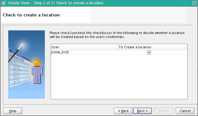

  6. On the Check to create a location screen, check Create option next to the user you are registering.
    Click Next.

  8. The Register Users Progress appears. It disappears when registration is complete.

Editing User Profiles
For each user, you can enter an optional description, assign the user to existing Roles, specify the Default Object Privilege and the System Privileges.
These are Oracle Database users, so you cannot rename a user in OWB; you must do that trough Oracle Database.
Note that the granting or revoking of roles and privileges only takes effect in the next session OWB.
To edit a user profile:
  1. In the Globals navigator, expand Security.
  2. Expand Users.
  3. Select the name of the user for editing. Right-click the user name, and select Open.

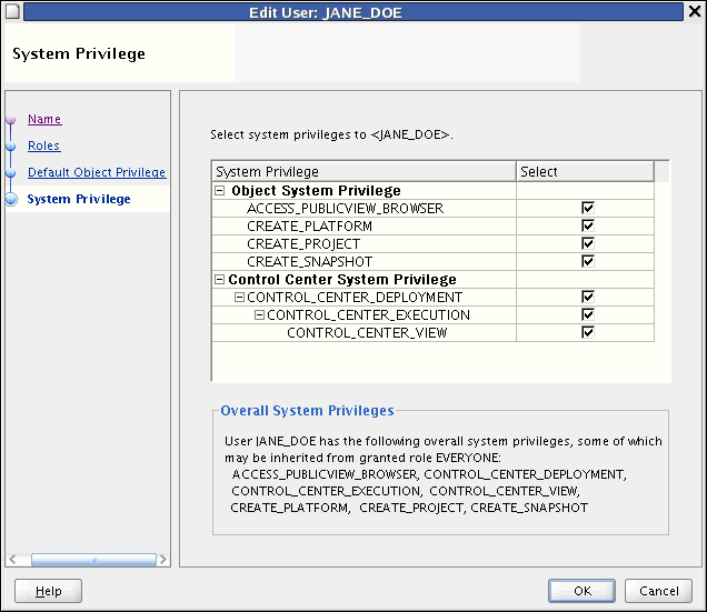

  4. The Edit User: Username screen appears. It contains the following options for editing
    • Name: you cannot change the name itself, but the screen contains an editable Description text field.
    • Roles: you may assign various roles to the user by moving them from the list of Available Roles to the list of Granted Roles.
    • Default Object Privilege: you may assign default privileges to either Users or Roles by checking the appropriate boxes under FULL_CONTROL, EDIT, COMPILE, or READ.
    • System Privilege: you may assign system privileges to the user by checking appropriate boxes under Object System Privilege (ACCESS_PUBLIC_VIEW_BROWSER, CREATE_PLATFORM, CREATE_PROJECT, or CREATE_SNAPSHOT) and Control Center System Privilege (CONTROL_CENTER_DEPLOYMENT, CONTROL CENTER_EXECUTION, or CONTROL_CENTER_VIEW).
  5. When the edits are complete, click OK.

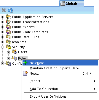

If you want to assign a user to a role that does not display on the Available Roles List, close the editor, create the new role, and then edit the user account. To create a new role, right-click Roles under the Security node in the Globals Navigator and select New Role. For information on creating and editing roles, see Defining Security Roles and Editing Role Profiles.

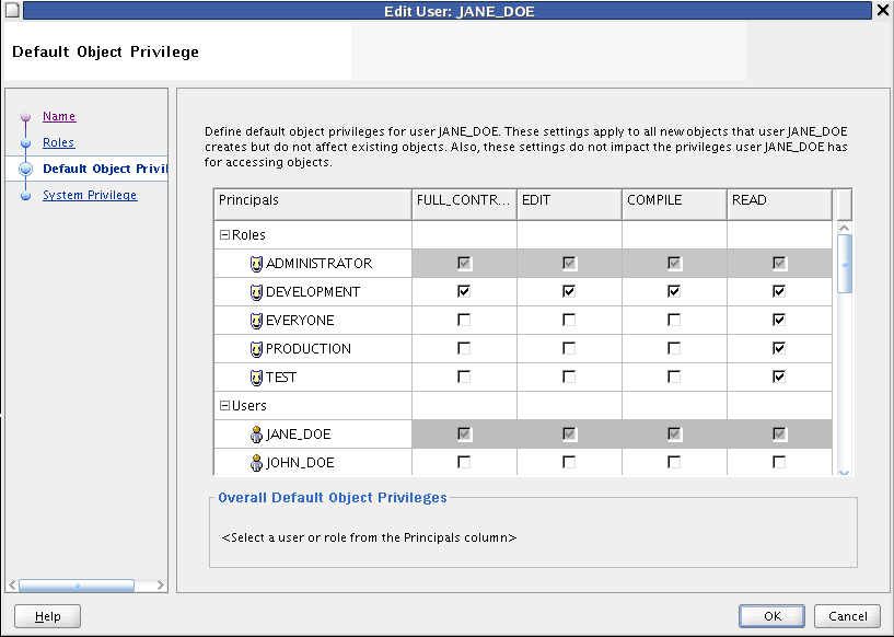

Default object privileges define the access other users and roles have to objects that the selected user creates. These privileges do not impact the privileges the user has for accessing objects created by other users.
For example, for all objects that JANE_DOE creates, JANE_DOE, as well as ADMINISTRATOR and DEVELOPMENT roles, have full access. Note that EVERYONE, PRODUCTION, and TEST roles are restricted to read-only.
Description of object_priv_01.gif follows
If you are familiar with UNIX operating system security, note that the default object privilege is similar to the UMASK command. When you edit the default object privilege, the change only effects objects the user creates subsequently; there is no effect on previously created objects. Therefore, if you set default object privileges early, you can expect little or no additional object-level security management.
To define the privileges other users have to objects the selected user creates, check the appropriate box for each role or user. You can grant the following privileges: FULL CONTROL, EDIT, COMPILE, and READ. All the privileges are additive. If you select COMPILE, then you apply both the compile and read privileges.
Note that access may be granted both to roles and to individual users. Note, however, that when you grant access to a role, the privilege is extended to all users in that role. For example, even though JOHN_DOE is not specifically granted access, he has read access through the EVERYONE role. Furthermore, if JOHN_DOE is a member of the DEVELOPMENT role, he has full control and access.
By default, when you create a new user, the EVERYONE role has full control on all objects. To enable metadata security, edit all user profiles and restrict the access the EVERYONE role has to objects each user creates.

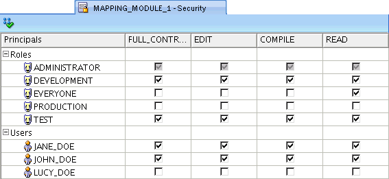

Securing Metadata Objects Throughout their Life Cycle

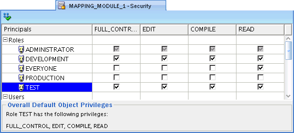

Default object privileges work in conjunction with object security properties to provide security options throughout the life cycle of a given metadata object. Settings you specify on the Default Object Privilege tab persist until a qualified user overrides the restrictions, on an object-by-object basis.
Assume that JANE_DOE creates several mappings. When JANE_DOE designs and develops these objects, the security policy described earlier in this section may be desirable. However, assume that JANE_DOE completes the mappings and releases the objects to the testing team. In this case, the default object privilege is too restrictive. To extend access to the TEST role, JANE_DOE can select the mapping, then from the View menu, select Security. She can then manually add all necessary privileges to the TEST role.
Description of object_priv_02.gif follows
For more details on overriding the default security on an object by object basis, see "Applying Security Properties on Specific Metadata Objects".

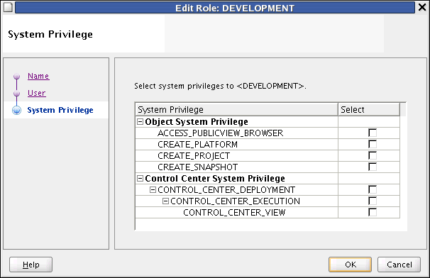

System Privileges
System privileges define user access to workspace-wide services. Use the System Privilege tab to allow or restrict users and roles from performing administrative tasks.
You can control access to the following operations:

  • ACCESS_PUBLICVIEW_BROWSER: Allows users to access the Repository Browser.
  • CREATE_PLATFORM: Allows users to create new platforms in the workspace using OMB*Plus.
  • CREATE_PROJECT: Allows users to create projects, which administrators create projects as a means of organizing metadata objects.
  • CREATE_SNAPSHOT: Allows users to create snapshots which administrators use when backing up workspaces.
  • CONTROL_CENTER_DEPLOYMENT: Allows users to deploy to the Control Center and then run those procedures.
  • CONTROL_CENTER_EXECUTION: Allows users to run procedures from the Control Center.
  • CONTROL_CENTER_VIEW: Allows users to view procedures from the Control Center.

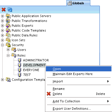

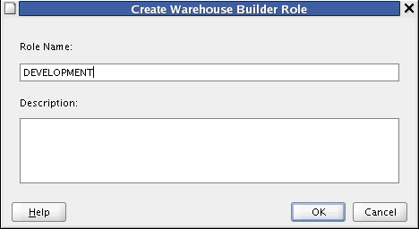

To create a new role:
  2. Under Security, select Roles.
  3. Right-click Roles, and select New Role.
    Description of new_role_01.gif follows
  4. On the Create Warehouse Builder Role screen, enter the Role Name.
    Description of new_role_02.gif follows
  5. Click OK.
For each role that you create, you can edit the name, enter an optional description, assign the role to existing Users, and specify the system privilege. You cannot rename or edit the descriptions for the predefined roles EVERYONE and ADMINISTRATOR, nor can you delete them. Note that Warehouse Builder roles and database roles are separate constructs; therefore, deleting a Warehouse Builder role has no effect on the database. For more information on system privilege, see System Privileges.

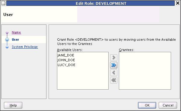

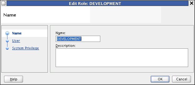

To alter default security privileges for a role:
  2. Under Security, expand Roles.
  3. Select the role to edit, and right-click. From the menu, select Open.
    Description of edit_role_01.gif follows
  4. In the Edit Role: RoleName window, you may do any one of the following:
Users
You can assign multiple users to a role. If you want to assign a user that does not display on the Available Users list, then close the editor, create the user from the Security node in the Globals Navigator, and then edit the role. To create a new user, right-click Users from the Security node and select New User. For information on creating and editing users, see Registering Database Users and Editing User Profiles.
You can grant or restrict access to metadata objects on an object-by-object basis.
To change security properties of a specific metadata object:

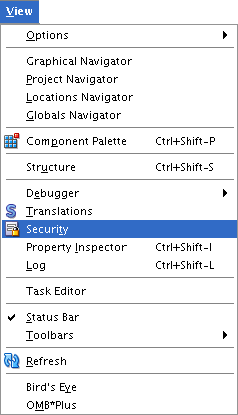

  1. Select the metadata object for changing.
  2. From the View menu, select Security.
  3. Edit the security privileges for the object, granting and revoking them either at Role level, or at User level.
    Description of object_priv_03.gif follows
  4. When all changes are made, from the File menu, select Save All.
    Confirm changes.
Security Tab
Use the Security tab to define metadata security on an object-by-object basis. Only users that have full control privileges on an object can change the metadata access controls on the Security tab. Security properties are important in managing the life cycle of your projects, as described in "Example: Using Security Properties to Freeze a Project Design".
While the Default Object Privilege defines metadata security for objects a specific user creates, the Security tab overrides that metadata security policy on an object-by-object basis. Assume that JANE_DOE is a developer that creates mappings and process flows. If you want all objects created by JANE_DOE made available to another developer, such as JOHN_DOE, then use the Default Object Privilege. However, if you want to make only a few objects created by JANE_DOE available to JOHN_DOE or even every user who has a TEST role, locate each object in the Design Center and alter its security options.
To enforce a full metadata strategy, edit the security properties for all projects in the Project navigator. By default, the EVERYONE role has its object privileges set to full control. Change the EVERYONE role privilege to be more restrictive and select Propagate Security Settings icon to apply the changes to all children.
Propagating Security Properties to Child Objects
You can apply security properties to an object and all its children by selecting Propagate on the Security tab. This option is disabled when you select an object that cannot have child objects.
When users complete the design of a project, you may want to freeze the contents of the project. Once you complete the following steps, only administrators can change the objects in the project.
To freeze a project design:
  1. Log on as user with administrator privileges.
    Description of security_03.gif follows
  3. On the Security tab, restrict the privileges for all users and roles other than the administrators, as appropriate.
  4. Click Propagate Security Settings icon.
