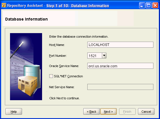

On the Database Information page, enter the host name, port number, and service name where OWB is installed.
Click Next.

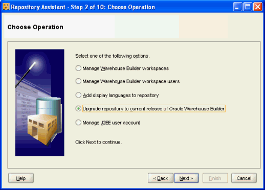

On the Choose Operation page, select Upgrade repository to current release of Oracle Warehouse Builder.
Click Next.

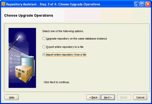

On the Choose Upgrade Operations page, select Upgrade repository on the same database instance.
Click Next.

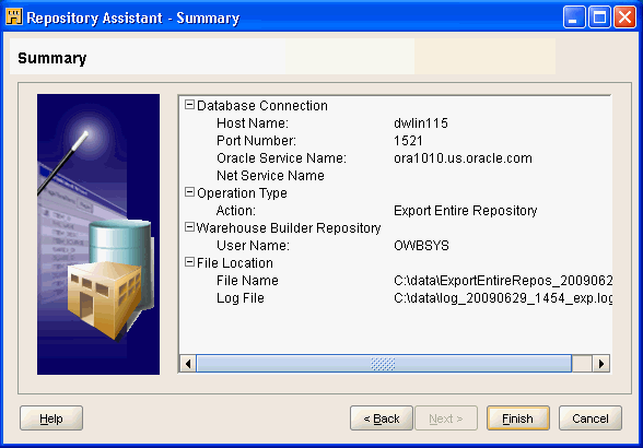

You can upgrade an OWB release 10.2 or 11.1 repository by exporting its content to a file, and then importing the file into an OWB release 11.2 repository, using the Repository Assistant.
You export a repository with the Repository Assistant as follows.
To export a repository to a file
Start the Repository Assistant.
In Windows, from the Start menu, select Program Files, then Oracle - OWB112, then Warehouse Builder, then Administration, then Repository Assistant.
In Linux, from the command line, run OWB_HOME
/owb/bin/unix/reposinst.sh
On the Welcome page of the Repository Assistant, click Next.
On the Database Information page, enter the host name, port number, and the service name where the OWB is installed.
Click Next.
Click Next.

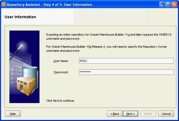

On the Choose Upgrade Operation page, select Export entire repository to a file.
Click Next.

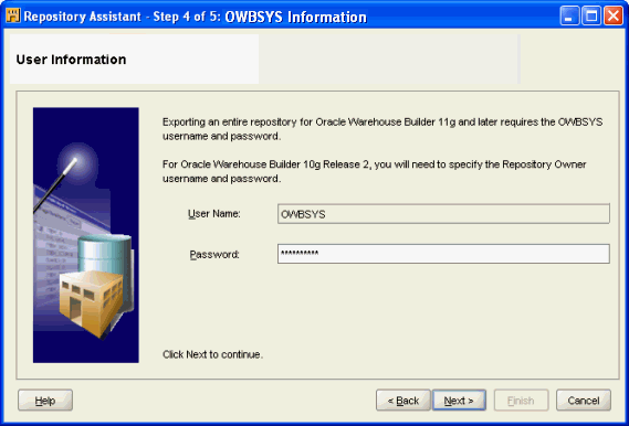

On the User Information page, for an OWB release 10.2 source, enter the user name and password of the OWB release 10.2 repository owner. For an OWB release 11.1 source, enter the OWBSYS
user name and password.
Click Next.

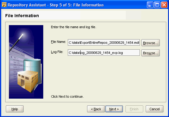

On the File Information page, enter the following information:
File Name: the name of the MDL file for storing the repository.
Log File: the name of the export operation log file that stores status and statistical information.
Click Next.
On the Summary page, click Finish.
An Export Repository Progress window appears showing progress.
At the end of the export process, a status message appears. The export operation creates the file.

On the Choose Upgrade Operation page, select Import entire repository from file.
Click Next.

The export part of the scenario uses the Repository Assistant to create an MDL zip archive. This MDL zip archive includes information about all the workspaces in the repository, with each workspace stored as a separate file.
See Also:
"Exporting an OWB Repository to a File" for a description of the export operationCreating OWB Users in the Target Instance
Before importing the repository, in the target Oracle Database instance that contains the migrated repository, create the same users who had access to the original repository. You must do this to ensure that the security information is correctly imported. However, you do not need to register these users as OWB users; the upgrade process handles this automatically.
Importing a Repository from MDL File
The import operation is described in section "Importing a Repository Export MDL File to OWB Release 11.2". Note that in step 6, you are entering the credential of the source (remote) database, which contains the repository MDL and log files.

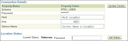

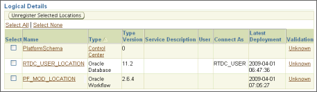

To upgrade locations using the Repository Browser

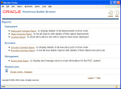

In Repository Browser, select Control Center. Click Reports.
In the Reports window, under Deployment, click Locations Reports.
On the Locations Report, under Logical Details, in the Validation column of the table, click Unknown.
Under Connection details, under Location Status, because the status is Unknown, enter the password and click Get Status.

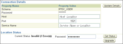

Note that the Current Status is Invalid.
Under Location Status, click Upgrade.
Note that the Current Status is now Valid.
Once you are finished, notice that the Validation column shows Tested locations
