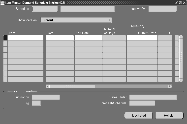

Choose Detail to open the Master Demand Schedule Entries window or Master Production Schedule Entries window.
Enter a date.
For MDS, this is the date of shipment. For an MPS, this is the completion date of production.
For repetitive items, whether MDS or MPS, this is the start date of production
For repetitive items, enter an end date of production.
Enter a current quantity.
This also becomes the original quantity and the total. Schedule reliefs reduce the current quantity. Schedule reliefs plus the current quantity equals the total.

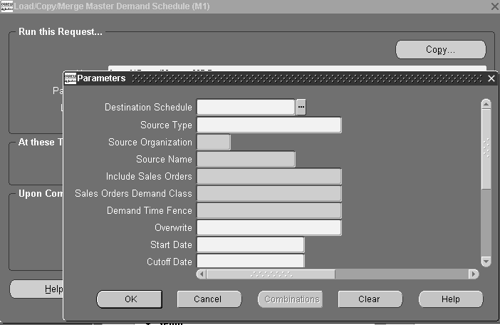

To load a master schedule from an internal source
Navigate to the Load/Copy/Merge Master Demand Schedule or Load/Copy/Merge Master Production Schedule window.
Choose one of the following names:
Load/Copy/Merge MDS
Copy/Merge MPS
Load MPS
In the Parameters window, enter a destination schedule.
Select a source type. See: Source Type Field
Select a source organization.
Select source name.
Select a start date and a cutoff date.
Select from a number of load options. See: Selecting Master Schedule Load Options
Choose Submit Request.

Sales Order Demand Class:
To limit the sales orders loaded to a particular demand class, select a demand class. Only sales order items from this demand class are loaded.
Demand Time Fence:
To limit the source forecast with a demand time fence, select:
Load forecast outside demand time fence only: Ignore forecast entries on and within the demand time fence. When you include sales orders and consume forecasts, this option loads sales orders within the demand time fence, and the greater of sales orders and forecasts outside the demand time fence.
Load orders within and forecast outside demand time fence: Load only sales orders on and within the demand time fence, and only forecast entries outside the demand time fence.
Ignore demand time fence: Ignore the demand time fence. When you include sales orders and consume forecasts, this option loads all forecast demand across the planning horizon.
Note: Use the include sales orders option to also load sales order demand across the planning horizon.
Overwrite
Overwrite To overwrite the existing entries of the destination schedule, select: All entries: Erase all existing master schedule entries associated with the master schedule name and load new entries.
For example, if you load master schedules MS-A and MS-B into master schedule MS-C the first time and then load master schedule MS-B into master schedule MS-C the second time, the result is that MS-C contains master schedules from the second load of MS-B.
Same source only: Erase only the entries with a source that has been previously loaded into the master schedule. This allows you to update master schedule information with the latest picture of the sales orders, updated forecasts or master schedules.
For example, if you load master schedules MS-A and MS-B into master schedule MS-C the first time and then load master schedule MS-B into master schedule MS-C the second time, the result is that MS-C contains master schedules from the first load of MS-A and the second load of MS-B.
Or, if you load sales orders into master schedule MS-C the first time and then load sales orders again using this option. Master schedule MS-C reflects all the current sales orders including those booked in the interim of the first and second loads.
To add new entries to the destination schedule, select:
No: This loads new entries, but does not erase existing master schedule entries.
Start Date
Select the start date of your schedule.
If you specify a start date Oracle Master Scheduling/MRP and Supply Chain Planning first selects the planning BOM entries that start outside the start date, then explodes those entries. When you load a forecast into an MDS, the master schedule load inserts all the forecast entries after the start date minus backward update consumption days for the forecast set. The start date does not apply to exploded entries that fall before start date due lead time offsetting from planning BOM entries that start after the forecast load start date.
Cutoff Date
Select the cutoff date of your schedule.
When you load a forecast into an MDS, the master schedule load inserts all the forecast entries prior to the cutoff date and adds forward update consumptions days for the forecast set.
Explode
Select Yes to explode the schedule entries, down to the MPS explosion level. See MPS Explosion Level.
Quantity Type:
To load forecast quantities, select:
Current: This loads the original forecast quantity minus any consumption quantities. When you choose this option, you cannot choose to consume the forecast, since the forecast quantities have already subtracted sales order demand.
Original: This loads the forecast without any consumption. When you choose this option, you should choose to consume the forecast if you intend to load the master schedule using forecasts and sales orders. Consuming the original forecast ensures that demand is not overstated.
Note: To ensure a consistent picture of demand, you should load sales orders and forecasts during the same load process, rather then loading them in two separate steps. If you load them separately, and you create sales orders in the interim, you could overstate or understate demand. For example, suppose you define a forecast entry for 100 on 01-FEB and load it into the master schedule. You create a sales order for 30 on 01-FEB. The forecast is consumed to 70, but the master schedule remains at 100. You then load sales orders as a separate step. The total demand for 01-FEB becomes 130, which overstates the actual and forecasted demand. If you launched a single process instead of two, you would see a forecast of 100 and no sales order demand, or a forecast of 70 and a sales order for 30. Either way, the correct demand of 100 results
Consume
Select Yes to consume the forecast. See Forecast Consumption.
Modification Percent
Enter a percent by which to multiple the schedule entries.
Carry Forward Days
Enter a number of workdays to move the schedule forward in time. To move the schedule backward, enter a negative number.
Note: When you specify carry forward days, the start date and cutoff date apply to the destination schedule, This allows schedule entries before the start date or after the cutoff date to be loaded.
Backward Consumption Days
Enter a number of workdays the consumption process will move backward when looking for a forecast quantity to consume. See: Backward and Forward Consumption Days.
Outlier Percent
Enter the maximum percent of the original forecast that a sales order can consume. See: Outlier Update Percent

You can track reliefs against a Master Demand Schedule for both the product family and the member items. You cannot track reliefs against a Master Production Schedule at the product family item level because the MPS for a product family item does not get relieved when the MPS for the member item gets relieved.
The procedure for tracking reliefs for a product family item is the same as that for any individual item.
To see which orders relieved the MDS, do this:
Navigate to the Item Master Demand Schedule Entries window.
Query to find the schedule you are interested in tracking.
Navigate to the Schedule Entry for the product family item.
Click the Reliefs button to see the order quantity and relief quantity for each order.
