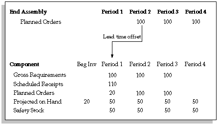

Supply Chain Planning users can employ additional functionality to generate and manage their material and distribution requirements across multiple, interdependent organizations. See: The Multiple Organization Model and Material and Distribution Requirements Planning.
Material requirements planning (MRP) calculates net requirements from gross requirements by evaluating:
the master schedule
bills of material
scheduled receipts on-hand inventory balances
lead times
order modifiers
It then plans replenishments by creating a set of recommendations to release or reschedule orders for material based on net material requirements. These planned recommendations are stated in:
discrete quantities, with due dates
repetitive build rates, with first and last unit start dates
Oracle Master Scheduling/MRP and Supply Chain Planning assumes infinite capacity is available to meet the material requirements plan. However, you can use capacity planning to verify that sufficient capacity exists to support your material plan.

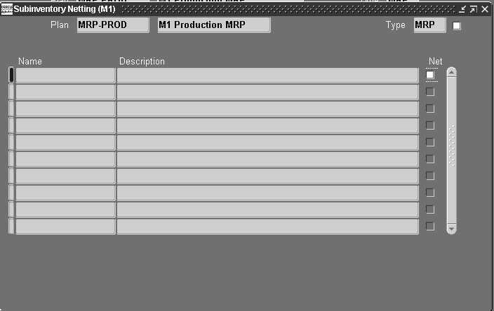

You can enter additional plan options for any plan. You can also view plan options in the Plan Status window.
Note: If you are launching the planning process for this plan name for the first time, the plan options you defined in the setup parameters are displayed. Otherwise, the plan options you chose for the last launch of the planning process are displayed.
Supply Chain Planning users can also launch a DRP and supply chain MRP and MPS plan. Supply Chain Planning users should refer to Reviewing or Adding Supply Chain Plan Options.
Navigate to the Plan Options window.
Query a plan name.
Select an overwrite option:
All: For an MPS plan, overwrite all entries and regenerate new MPS entries based on the source master demand schedule.
For an MRP, overwrite all planned orders and MRP firm planned orders for MRP items.
This option is displayed when you generate a plan for the first time.
Note: Be very cautious when using this option since it overwrites firm planned orders and/or master schedule entries. If you do not want to overwrite MRP firm planned orders, select None.
Outside planning time fence: For an MPS plan, overwrite all MPS entries outside the planning time fence.
For an MRP, overwrite all planned orders and firm planned orders outside the planning time fence.
Note: Be very cautious when using this option since it overwrites MRP firm planned orders and master schedule entries outside the planning time fence. If you do not want to overwrite MRP firm planned orders, select None.
None: Do not overwrite any firm planned orders for MPS or MRP plans and net change replan.
Check Append Planned Orders to append new planned orders in the following situations:
If the MPS plan name has an existing schedule associated with it and you enter None as the overwrite option, the planning process does not recommend rescheduling or suggest new planned orders before the end of the existing MPS (the last planned order) even if so indicated by new demand from the master demand schedule. This is analogous to firming your master production schedule. By not overwriting, the master scheduler is taking responsibility for manually planning items. For an MRP plan name, this option creates planned orders where needed, considering existing MRP firm planned orders.
Note: If you want to add firm planned orders using net change replan, set the overwrite option to Outside planning time fence or None.
If the plan name has an existing MPS or MRP associated with it and you enter All as the overwrite option, the planning process deletes all previous planned entries and creates new planned orders based on the source master schedule.
If the plan name has an existing MPS or MRP associated with it and you enter Outside planning time fence as the overwrite option, the planning process deletes all planned entries after the planning time fence and creates new planned orders after that date. In this case, since you are overwriting after the planning time fence, you are also appending new planned orders after that date.
If the plan name has an existing MPS or MRP associated with it and you enter None as the overwrite option and do not check this, the planning process reports the instances where the plan is out of balance with the source master schedule. It does not recommend any new orders. Instead it lets you manually solve any problems in the process. This gives maximum control to the master scheduler and/or material planner.
Check Demand Time Fence Control to indicate whether the planning process considers any demand from forecasts within the demand time fence.
The planning process does not consider demand from forecasts within the demand time fence, but considers demand from sales orders.
Check Net WIP to indicate whether the planning process considers standard discrete jobs, non-standard discrete jobs, or repetitive schedules when planning items during the last plan execution.
Check Net Reservations to indicate whether the planning process considers stock designated for a specific order when planning the items during the last execution of the plan.
Check Snapshot Lock Tables to indicate whether tables are locked during the snapshot process to guarantee consistent data.
This option temporarily prevents other users from processing certain transactions.
Check Planning Time Fence Control to indicate whether the planning process violates planning time fences for items.
For discrete items, the planning process does not create planned orders or recommend to reschedule in existing orders within the planning time fence of the item. The planning process can still recommend to reschedule orders out.
For repetitive items, the planning process can vary the suggested schedule from the optimal schedule, within the planning time fence, by the acceptable rate increase and/or decrease you specified for the item.
Note: For purchase requisitions and internal requisitions, the planning process ignores the planning time fence in all cases.
Check Net Purchases to indicate whether the planning process considers approved purchase requisitions when planning the items during the last execution of the plan
Check Plan Safety Stock to indicate whether the planning process calculates safety stock for each item during the last plan execution.
Check Plan Capacity to indicate whether you want to generate a capacity plan.
If you checked Plan Capacity, specify the Bill of Resources (for MPS plans only) and, optionally, a Simulation Set. See: Capacity Modifications and Simulation, Oracle Capacity User's Guide and Bills of Resources, Oracle Capacity User's Guide.
Check Pegging to calculate graphical pegging information. See: Overview of Graphical Pegging. The planning process then traces supply information for an item to its corresponding end demand details, which you then can view in a graphical display.
If you are working in a project environment, set a Reservation Level and (optionally) a Hard Pegging Level. See: Reviewing or Adding Project MRP Plan Options.

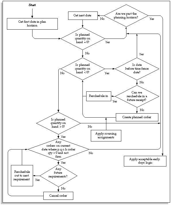

Order Modifiers Logic
The following diagram shows the logic that the planning process uses when planning with order modifiers.

Component yield is the percentage of a component on a bill of material that survives the manufacturing process. A yield factor of 0.90 indicates that only 90% of the usage quantity of the component on the bill actually survives to be incorporated into the finished assembly.
To account for the loss, the planning process inflates the demand quantities for the component (similar in concept to shrink factor). To increase demand, the usage quantity is divided by the yield factor.
For example, when you define the component usage quantity as 2 and the component yield as 0.90, the usage is recalculated as 2 divided by 0.90, or 2.22.
new component usage = usage / yield factor

Gross to Net Explosion Example
In the following diagram, the suggested planned orders for the end assembly are offset by the lead time, one period, and passed down to the component during the planning process.
The planned order for the end assembly in period 2 becomes the gross requirements for the component in period 1.
In period 1, the gross requirements (100) and the safety stock level (50) represent the total demand. The scheduled receipts (110) and quantity on hand (20) represent the total supply. The net requirements, total demand (150) minus total supply (130), equals 20.
The planning process suggests a planned order in period 1 of 20 to meet the net requirements.
There is no recommendation for safety stock in each period unless the demand in that period is driven less than the safety stock level.
Note: Planned orders in period 4 are not suggested since the projected on hand is at the safety stock level.

To net Subinventories
Navigate to the Subinventory Netting window from the Plan Options window.
Check Net to indicate that you want to net supply and demand for these subinventories.
Note: You assign a netting type when you define a subinventory in Oracle Inventory. The planning process considers the inventory in a nettable subinventory as supply. You can override the netting type for a specific subinventory when you launch the planning process.
Save your work.

Net Purchase
Net Reservations
Netting Supply and Demand
When you choose to net reservations, the planning process recognizes hard reservations that represent sales order demand. If you do not choose to net reservations, the planning process recognizes all sales order demand as soft reservations only. The planning process always plans to satisfy hard reservations before soft reservations.
Note: By definition, sales order demand is a soft reservation. A hard reservation is sales order demand that you firm by reserving selected inventory for the purposes of material planning, available to promise calculations and customer service issues
See Also
Viewing Item Reservations, Oracle Inventory User's Guide Net Purchases
Net Work in Process
