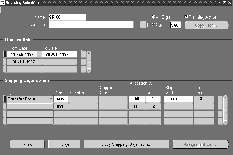

Sourcing rules define inventory replenishment methods for either a single organization or all organizations in your enterprise. Time-phasing in a sourcing rule determines when each group of shipping method - ship org combinations is in effect, as in this example:
In the first phase of SR-C01, SAC is replenished equally by AUS and NYC. From 01-JUL-1997, AUS no longer supplies SAC, which receives all transfers from NYC: (mrp_suprulex.if)
This sourcing rule can apply to one org (SAC, in this example), or to all your organizations. However, you cannot choose a single organization in one phase and all organizations in another phase. That would require two sourcing rules, with consecutive effectivity dates. If you assign the sourcing rule to one receiving organization (SAC in this example), it is a local sourcing rule; if you assign it to multiple organizations, it is a global sourcing rule.

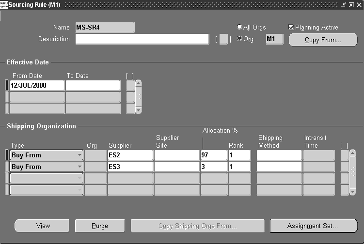

You can define sourcing rules that specify how to replenish items in an organization, such as purchased items in plants. Sourcing rules can also specify how to replenish all organizations, as when the entire enterprise gets a subassembly from a particular organization.
If there is a conflict between a sourcing rule and a bill of distribution, the sourcing rule takes precedence. For instance, if you assign a bill of distribution to AUS that tells it to source a part from NYC, AUS can still define a sourcing rule to source the part from SAC. In this case, the local sourcing rule overrides the bill of distribution. See: Defining Bills of Distribution.
Navigate to the Sourcing Rule window.
Enter a unique sourcing rule name.
Indicate whether this sourcing rule is used for all organizations (global) or a single organization (local). If the sourcing rule is local, you must enter an organization name; otherwise, your current organization will be the receiving organization.
Choose Copy From to copy the effectivity dates and shipping organization from another sourcing rule into this one.
Enter effectivity dates. You must enter a start date, but entering an end date is optional.
For each range of effectivity dates, you can include multiple shipping organizations. For each shipping organization you want to include, select a sourcing type to specify whether you make, buy, or internally transfer the item. You can also copy a list of shipping organizations from an existing sourcing rule. If you enter a customer organization as the receiving organization, then you cannot select a supplier organization as the shipping organization.
Enter an allocation percentage for each shipping organization. Allocation percentage includes the number of planned orders issued to the part for the entire the planning horizon. Your total allocation may not exceed 100. If the allocation percentage for all the shipping organizations included within a range of effectivity dates equals 100, Planning Active is checked. If the sourcing rule is not planning active, the planning process will not use the rule to assign planned orders.
Enter a numeric rank value to prioritize each sourcing type. If you have two sources with the same allocation percentage, planned orders are sourced from the highest rank first.
Select a shipping method, such as FEDEX, UPS, or rail. (See: Defining Shipping Methods, Oracle Inventory User's Guide.
Save your work.

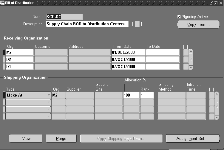

You can define bills of distribution that specify a multilevel replenishment network of warehouses, distribution centers, manufacturing centers (plants), and trading partners.
Navigate to the Bill of Distribution window.
Enter a unique bill of distribution name.
If the allocation percentage for this bill of distribution equals 100, Planning Active is checked. (See Step 7.)
Note: You cannot set the allocation percentage to less than or greater than 100 for sourcing rules that are already assigned in assignment sets
Choose Copy From to copy the receiving and shipping organization information from another bill of distribution into this one.
Enter the effectivity dates for each receiving organization in this bill of distribution.
For each receiving organization, you can enter a number of shipping organizations. For each shipping organization, select a sourcing type to specify whether you make, buy, or internally transfer the item. You can also copy a list of shipping organizations from an existing bill of distribution.
Note: Suppliers and supplier sites must be predefined in Oracle Payables. See: About Suppliers, Oracle Payables User's Guide
Enter an allocation percentage for each shipping organization. Allocation percentage includes the number of planned orders issued to the part for the entire the planning horizon. Your total allocation may not exceed 100. If the allocation percentage for all the shipping organizations included within a range of effectivity dates equals 100, Planning Active is checked. If the sourcing rule is not planning active, the planning process will use the rule to assign planned orders.
Note: For bills of distribution that are already named in assignment sets, you cannot set the allocation percentage to less than or greater than 10
Enter a numeric rank value to prioritize each sourcing type. If you have two sources with the same allocation percentage, planned orders are sourced in rank order.
Select a shipping method, such as FEDEX, UPS, or rail. See: Defining Shipping Methods, Oracle Inventory User's Guide.
Save your work.
This feature allows you to include long, previously defined lists of shipping organizations without manual entry.
Select a sourcing type to specify whether you make, buy, or internally transfer the item.
Choose Copy Shipping Orgs From.
In the Find window, select a bill of distribution that includes the shipping organizations you want to duplicate in this new bill of distribution.
Choose OK.
Select a bill of distribution name.
Choose Purge.

Splitting Of Demand According To Sourcing Percentages
Demand can be divided and allocated to multiple sources according to target sourcing percentages set in the rules and bills.
The data in these tables demonstrate how allocation percentages for planned orders are divided according to ranking information.
The demand for Item A on the date of 06/10 is:
| Demand | Due Date | Quantity |
| 1 | 07/15 | 300 |
| Item | Source | Rank | Percentage | Effective From | Effective To |
| A | S1 | 1 | 40 | 05/15 | 12/31 |
| A | S2 | 1 | 30 | 05/15 | 12/31 |
| A | S3 | 1 | 30 | 05/15 | 12/31 |
Demand is assigned using the ranking information and calculating the percentages assigned to each source to calculate the planned orders.
S1: 300 x 0.40 = 120
S2: 300 x 0.30 = 90
S3: 300 x 0.30 = 90
Three planned orders are created for the quantities of 120, 90, and 90 respectively.

Defining Sourcing Rules
