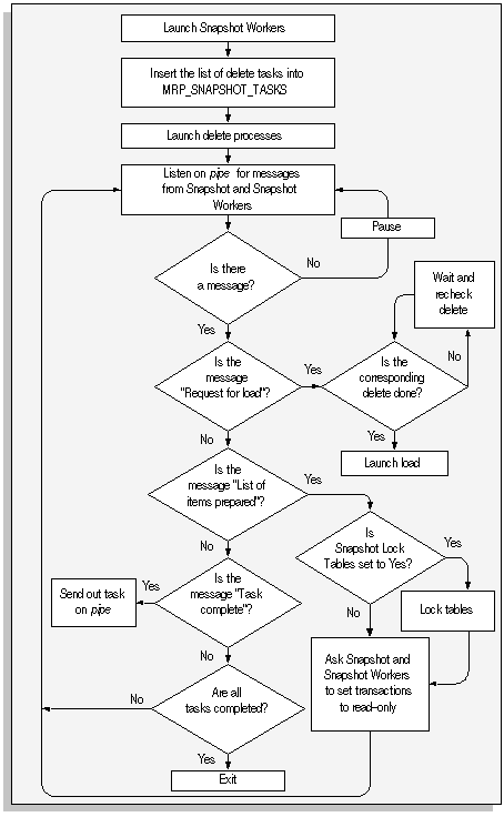

Figure 7-44 illustrates the Snapshot Monitor Process logic under the Memory-based Planning Engine. Below is a detailed explanation of the logic.
Launch X Snapshot Workers via the Concurrent Manager, where X is the number of Snapshot Workers to launch, as defined by the profile option MRP:Snapshot Workers.
Begin Snapshot Preprocessing. These tasks include calculating repetitive planning periods for all the planned organizations, and relieving the MPS.
List the items that the planning engine will include in the current run. The plan-level option Included Items determines this list.
The Snapshot Monitor launches Snapshot Delete Workers to clean old snapshot and planning output from the tables.
Snapshot Workers select data from system tables, including work in process, inventory, purchasing, and bill of materials and write the data to flat files. Since the data is written to flat files, the deletes are not a prerequisite for this step.
Loader Workers load the flat files from step 5 into the MRP snapshot tables.
Once the workers complete the list of items for planning, lock the tables if Snapshot Lock Tables is set to Yes, then ask the Snapshot and Snapshot Workers to set transaction to read-only.
Loop until the workers complete.
Snapshot post-processing begins, which consists of cleanup activities and the execution of user-defined Snapshot Tasks.
After these steps, the Memory-based Planner performs the gross-to-net explosion and creates new supply orders.
If the user ran the Memory-based Planner without the Snapshot, the Memory-based Planning Engine launches Planner Delete Workers, which delete data from the planner output tables.

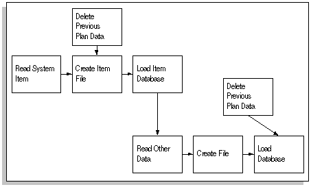

Once MRP_SYSTEM_ITEMS is loaded, then all other tasks can proceed. Each of the following tasks is responsible for creating a set of files that correspond to the database tables:
Capacity information: loads job resource requirements and capacity resource information
Delete: deletes data from relevant MRP tables which belongs to the previous plan
Demand information: loads independent gross requirements and material reservations
Inventory information: loads information regarding inventory lots
Item information: loads inventory items, primary suppliers, item categories, item classifications, quantity on hand and cost information
MPS orders information: loads MPS planned orders
MRP orders information: loads MRP firmed planned orders
Purchasing information: retrieves supply information regarding purchase orders, purchase requisitions, intransit shipments, intransit receipts and purchase orders in receiving from the database
Safety stock: loads time-phased safety stock information
Substitute items information: loads substitute items
WIP and BOM component information: loads BOM structures, pending ECOs, component requirements from discrete jobs, flow schedules, repetitive schedules, and non-standard jobs; calculates low level codes and checks loops introduced by both WIP components and BOMs
WIP information: loads discrete jobs, flow schedules, non-standard jobs, repetitive schedules and calculates aggregate repetitive schedules
When a given file is complete, each tasks submits a request to the Snapshot Monitor. The Snapshot Monitor then checks the dependency and begins loading the file, for use by the Memory-based Planner.

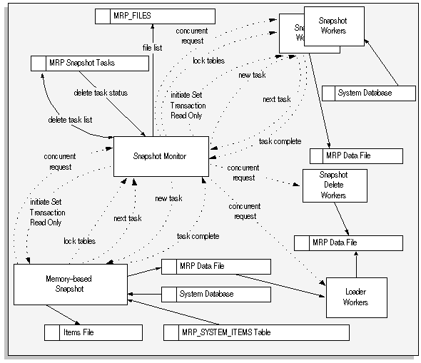

Oracle Master Scheduling/MRP and Supply Chain Planning breaks tasks into smaller tasks that are executed concurrently by independent processes (workers). The programs that execute these tasks concurrently need to communicate in order to coordinate their actions.
The Memory-based Planning Engine uses a combination of database pipes and database tables for inter-process communication. The Memory-based Snapshot and Snapshot Workers communicate with the Snapshot Monitor via database pipes. These pipes carry messages that include requests for new tasks, task completion, and initiate the set transaction read-only RDBMS feature. The Snapshot Delete Workers communicate via the database table MRP_SNAPSHOT_TASKS. See also: Interprocess Communication
