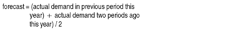

The forecast for this period is the average of the actual demands for the previous two periods.
the picture is described in the document text

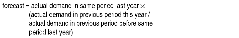

The forecast for this period is the actual demand for the same period last year multiplied by the growth (or decline) since last year as
measured by the ratio of the previous period actual demand to the actual demand for the same period last year.

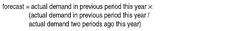

The forecast for this period is the actual demand for the previous period multiplied by the current growth (or decline) as measured by the ratio of the previous period actual demand to the actual demand for the period before the previous period.

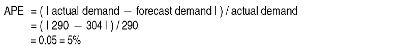

To evaluate which forecasting model produced the best forecast last period, the absolute percentage error (APE) is calculated for the five forecasts and the forecasting model with the smallest APE is chosen. APE is the ratio of the difference between the actual demand and forecast to the actual demand.

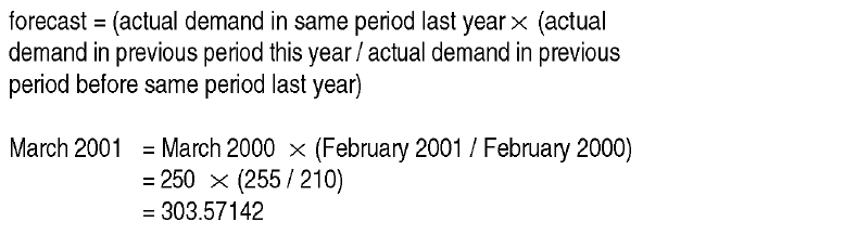

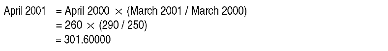

In this table, the forecast for the previous month is calculated for Model 4 as follows:
Important: For purposes of the previous table, we rounded ? our numbers off to the nearest integer. However, the forecast compile process rounds forecasts off to five decimal places.
The error for Model 4 is therefore calculated:
Since 5% is the smallest error of the five models, Model 4 is chosen to calculate the April 2001 forecast:

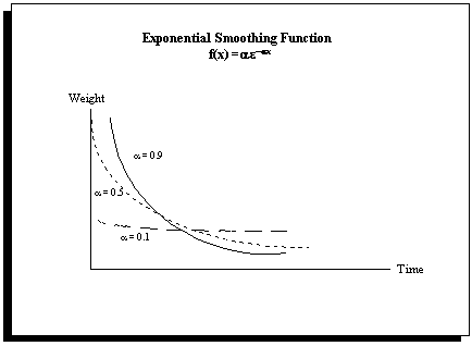

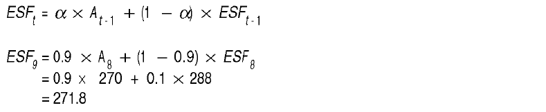

Exponential Smoothing Forecast (ESF)
In an ESF, demand is forecast by averaging all the past periods of actual demand and weighs more recent data to give it greater influence over the forecast results than older data. The weights are adjusted according to the exponential function f(x) = e (- ? x) where x is the number of periods past and is a chosen value between 0 and 1. shows the alpha function for three different values of; the larger the-value, the less weight is given to older data and the more the forecast tends to chase the prior periodís demand if demand is not smooth.
Rather than calculate the exponential function for every period, it can be shown that the ESF for period t can be easily calculated if we know the ESF for the prior period.
The initial value of ESFt is the actual demand for the prior period, At-1. The table shows these calculations for three different values of.
Period t Actual Demand At Forecast Éø = 0.9 Demand Éø = 0.5 ESFt Éø = 0.1

The forecast for period 9, for = 0.9, is calculated:
Period 3 was an abnormal period, but otherwise the trend is clearly upward. It can be seen that with the higher alpha, the forecast reacted intensely to the third period, and produced a very low period 4 forecast, but was also faster to correct itself and adjust for the trend. By period 9, the period we are forecasting, the abnormal period 3 has only a negligible effect on the forecast. All three forecasts became more accurate when they had more historical data upon which to draw.
It should be noted that, even though the higher alpha adjusted to the trend faster, plain ESF always lags behind the trend by at least one period. Even if the demand in the example had been smooth, all three scenarios would have lagged behind the trend.

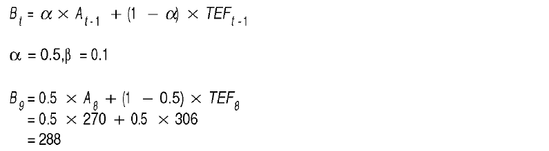

The base is found in the same way as the ESF, though:

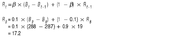

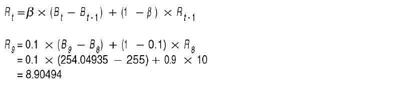

Finally, we need a way to figure out the trend index, Rt. To do this, we need another smoothing factor to smooth out changes in the trend. Similar to ESF, the higher this factor, the more responsive it is to changes in trend. However, it increasingly gets thrown off by abnormal period demand.
The initial value of Rt is the change in demand from two periods ago to the last period, At-1 - A-2.

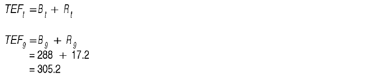

The table gives an example of forecasting using the trend-enhanced model. The forecast for period 9 is found by first calculating the forecast base value:
Then updating the trend index:
And, finally, adding the two for the period 9 trend-enhanced forecast:

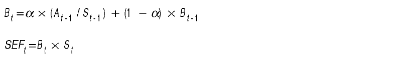

The same kind of logic that is used for adjusting for trend in the TEF is used to adjust for the seasonal variations. Demand is deseasonalized by dividing by the seasonality index for that period, and then exponential smoothing is used to produce a new base value. The base value is then multiplied by the seasonal index for the period being forecasted to produce the season-enhanced forecast (SEF).

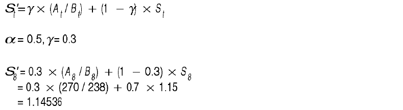

The seasonality index for the prior season is adjusted using yet another user-specified smoothing factor.

We begin by adjusting last periodís seasonality index:

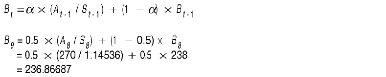

The period 9 forecast can now be found by calculating the forecast base-value:

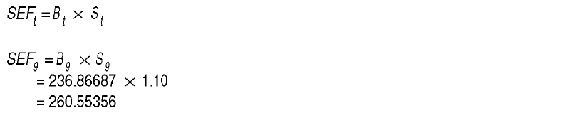

And then multiplying by the period 9 seasonality index:

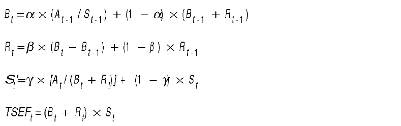

A combination of the TEF and SEF can be illustrated by showing the formulae and example provided in the previous table. The TSEF uses all three smoothing factors.

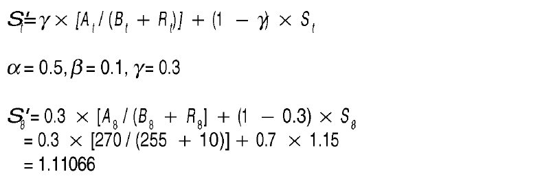

As with the SEF, we can calculate the new period 8 seasonality index as soon as period 8 results are in.

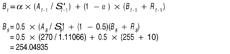

To make our period 9 forecast, we first calculate the period 9 basevalue:

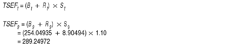

Add them together and multiply in the seasonality factor to get the period 9 trend and season-enhanced forecast:
