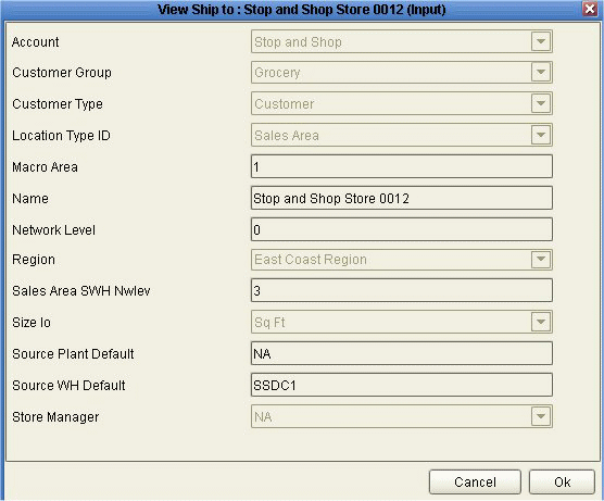

To view the attributes of an item or location
In your worksheet, find an area that is currently displaying the type of object you want to work with; see Where to Work with Items and Locations.
Right-click an object and click View (for example, View Ship to).
Oracle Demantra displays a dialog box like the following:
The attributes shown in red are required. These include the Name attribute and all immediate parents of this member. Depending on your implementation, not all attributes are editable.

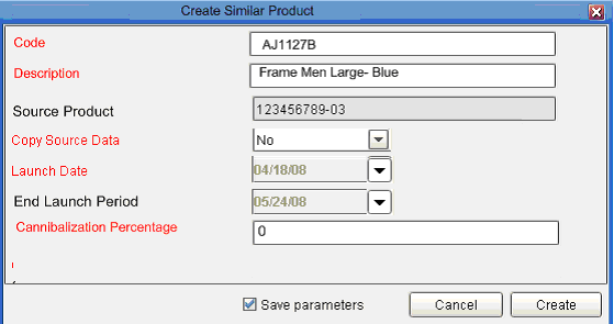

To create a similar product:
From any Demand Management worksheet, select the item from which you want to create a similar product.
Right click the item and then select Create Similar Product.
The Create Similar Product dialog box appears.
In the Code field, enter an item code. A pre-existing item code without historical data may be chosen or new item code entered.
In the Description field, give the new item a descriptive name. For example, “500 ml Grape Sport Drink”.
From the Copy Source Data drop-down list box, indicate whether data from source member should automatically be copied to the member.
In the Launch Date field, select the date when the item is being introduced. This date corresponds to when the item will first begin to sell, no forecast will be generated before this period.
In the End Launch Period field, select the date when the item has completed the launch phase. This field is optional and should only be populated if new item is to cannibalize sales from source item.
The period during which cannibalization is expected is between the Launch Date and End of Launch Period.
In the Cannibalization field, enter the percentage of sales that Demantra should take from the original item.
This input controls both whether cannibalization of source product will occur during launch time frame as well as the rate of cannibalization. A 0 value will result in no cannibalization of the source product.
Note: If you specify a value for the Cannibalization field, then you must enter a value for End Launch Period.
Click the Create button.
Demantra creates the new item, links it to locations and copies historical data from source to item if instructed to do so.

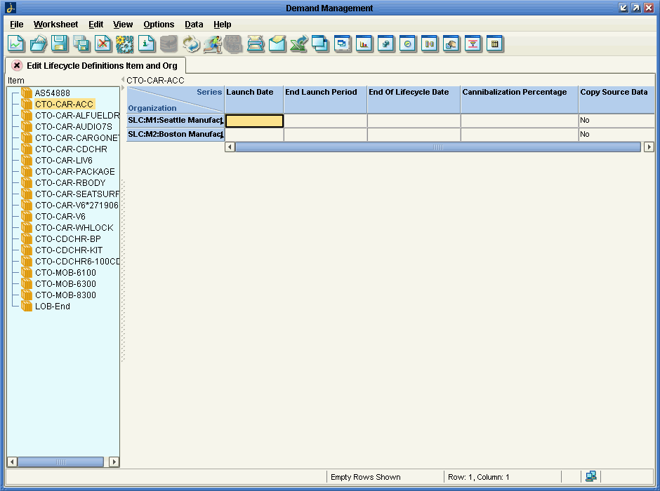

Once a similar product has been defined, you can later edit the product details for some (or all) locations from the Edit Lifecycle Definitions Item and Org worksheet.
To update a product lifecycle definition:
From the Collaborator Workbench, open any worksheet.
The Worksheet Designer appears.
From the File menu, choose Open.
From the Open Worksheet dialog box, choose Edit Combination Definition Item & Org.
Edit Combination Definition Item & Org worksheet appears.
Double-click a worksheet cell to edit the current value.
From the Data menu, choose Save Data.
Initiate the Update Lifecycle Definitions method to propagate changes in lifecycle definition and affect all relevant areas.

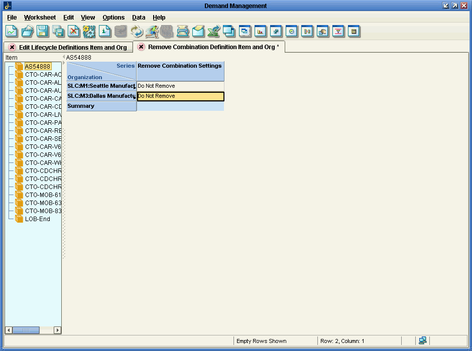

Use the Remove Lifecycle Definitions Item and Org worksheet to remove items and locations links. All data for deleted combinations is also deleted.
To remove lifecycle definitions:
From the Open Worksheet dialog box, choose Remove Combination Definition Item & Org.
The Remove Combination Definition Item & Org worksheet appears.
From the Remove Combination Setting drop-down list box, indicate whether or not you want to delete a combination.
From the File menu, choose Save Worksheet.
Execute the Remove Combinations method.
The Remove Combinations dialog box appears.
To confirm the deletion, choose Yes from the Remove Combinations drop-down list box, and then click the Remove button.
Note: Removing a combination that is set to cannibalize another item will update the cannibalization percentage for the remaining items.
Note: If all combinations for an item are removed the item itself will be deleted.

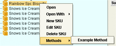

Depending on your implementation, the right-click menu may include a Methods submenu that includes additional options created by your implementors:
When you click one of these options, Oracle Demantra displays a dialog box like the following:
Select the Save parameters check box if you want to save the attribute changes to the database when the method is run.
For information on any such menu items, please contact your implementors or your designated Oracle Demantra system administrator.
