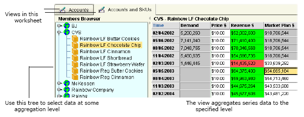

Within Oracle Demantra, you work almost entirely within worksheets. A worksheet is a customized working environment designed especially for your use. Here you can view and edit data. When you save changes back to the database, they become available to other users and to downstream operations.
A worksheet consists of one or more views, usually displayed as tabs within the worksheet. Each view retrieves a set of data that is aggregated in a specific way and that may also be filtered. The following shows an example:
Use this tree to select data at a level of aggregation. The view aggregates series data to the specified level. Here, views are shown as tabs within the worksheet. You can also display views as child windows of the worksheet.
The first interesting feature of any worksheet view is the aggregation level or levels that it uses. For example, you might want to view data at the account level, as follows:
The worksheet might include a dropdown list instead of this tree control. For example:
In either case, you can view data for any account. For example, for the quarter that started on February 3, 2003, the Demand for the CVS account was 1, 571, 396 units, and the unit price was $9.99. You can edit any data that is shown in white, such as the price and market plan.

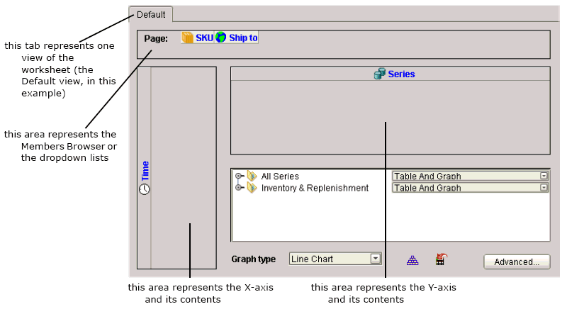

In general, a worksheet view can contain the following common visual elements:
Each worksheet view has an x-axis and a y-axis.
In the graph, the x-axis is shown horizontally and the y-axis is shown vertically.
In the table, the x-axis is displayed vertically and the y-axis is displayed horizontally. (This way, the x-axis displays the same data in the table and in the graph.)

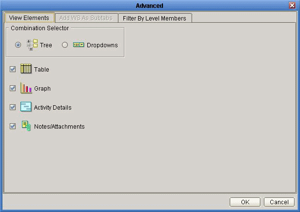

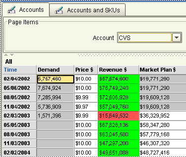

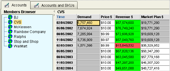

As noted earlier, a worksheet view usually includes either a Members Browser or a set of dropdown menus, which you use to choose the data to display in the rest of the worksheet:
| Members Browser |
| Selection lists |
In each case, the selected combination is “Low fat products at the BJ account.”
In addition to providing a way to select the data to display, the Members Browser enables you to create, edit, and delete the level members. See Managing Items and Locations. Depending on your implementation, you may also be able to perform additional operations on the members; see Using Other Right-Click Menu Options.
In some cases, the worksheet does not include either of these controls. This means one of following is true:

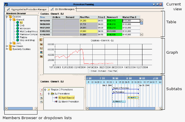

A worksheet graph displays data for the current selection. By default, the horizontal axis shows time, and the vertical axis shows one or more series.
A worksheet view can contain multiple subtabs.
The Notes/Attachments subtab displays notes and attachments related to the selected combination. See Viewing Notes.
The Activity Details subtab displays promotions and the promotion hierarchy. On the left, the Activity Browser displays an expandable tree view of the promotions associated with the currently selected combination. On the right, the Gantt chart displays the promotions associated with the currently selected combination. You can scroll backwards and forwards in time to see the start and end dates of each promotion, and you can zoom in and out in time.
Here you can create, edit, and delete promotions and higher levels in the promotion hierarchy. See the Oracle Demantra Trade Promotion Planning User's Guide.
A worksheet can include a subtab that contains a related worksheet. When you select a combination in the worksheet table, the related worksheet shows data associated with that combination. This related worksheet potentially includes different series than the rest of the worksheet and may also be filtered further.

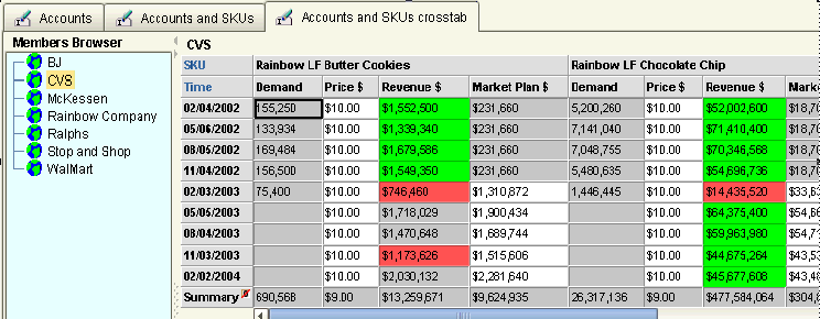

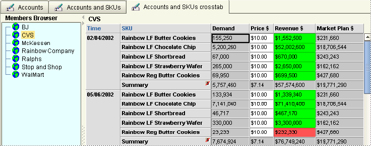

It is also possible to lay out a worksheet so that the members of a level are all displayed at the same time. This format is called a cross-tab layout, and the table (also known as a pivot table) provides a cross tabulation of all the members.
The following figure shows a worksheet table in cross-tab layout, with a row for each SKU member within each time bucket:
Notice that the Members Browser does not include the SKU level, because all SKUs are displayed at the same time.
For another example, the worksheet could instead display the SKU members across the top of the table rather than down the side, as in the following example:

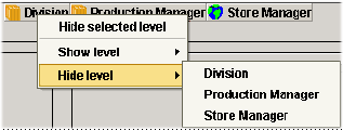

You can turn off (hide) the display of summaries, for example, if you
Want to use a separate view for rollups
Have data that does not summarize meaningfully
Want to save space on your screen
You can hide:
Level and worksheet summaries
Level summaries but display worksheet summaries
Worksheet summaries but display level summaries
The Worksheet Designer does not automatically hide any summaries. You evaluate the worksheet for meaningless and redundant summaries and hide them. It does, however, automatically hide repetitious summaries (summaries that summarize only one entity), for example, a promotion scenario that has only one promotion.
To turn off a summary:
In the Worksheet Designer, open the View’ region.
Right-click a level or series and deselect Show Summary

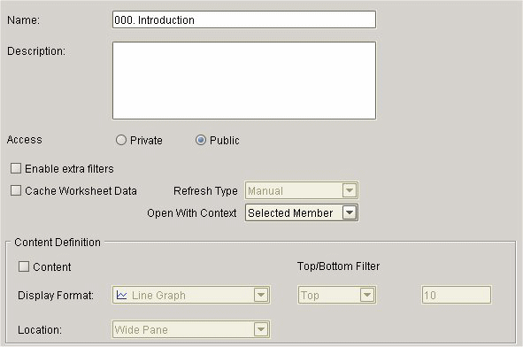

To configure basic information for a worksheet
Click Worksheet > Display. Or click the Display button.
The system displays a page where you specify the following basic worksheet information:
To display the content of this worksheet in Collaborator Workbench, check Content and then complete the following fields:
To specify how the worksheet table should appear, see Defining the View Layout.

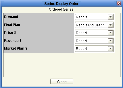

The system displays the Available Series and Selected Series lists. Each list is a collapsible list of series groups and the series in them.
You can instruct Worksheet Manager to display the series in a series group either:
In alphabetical order
By the display order that you set in Business Modeler
In Business Modeler, set parameter Sort Series by Display Order. See Oracle Demantra Implementation Guide.
Move all series that you want into the Selected Series list. To do so, either double-click each series or drag and drop it. You can also move an entire series group from one list to the other in the same way.

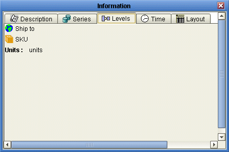

To specify the aggregation levels in a worksheet
Click Worksheet > Aggregation Levels. Or click the Levels button.
The system displays the Available Levels and Selected Levels lists.
Move all aggregation levels that you want into the Selected Levels list, using any of the techniques in Working with Lists.
Remove any unwanted levels from the Selected Levels list.
The selected levels will now be used on all views of this worksheet, unless you configure the views otherwise; see To specify which levels to use in a worksheet view.
The layout of the worksheet view controls the order in which the levels are used; see Defining the View Layout.

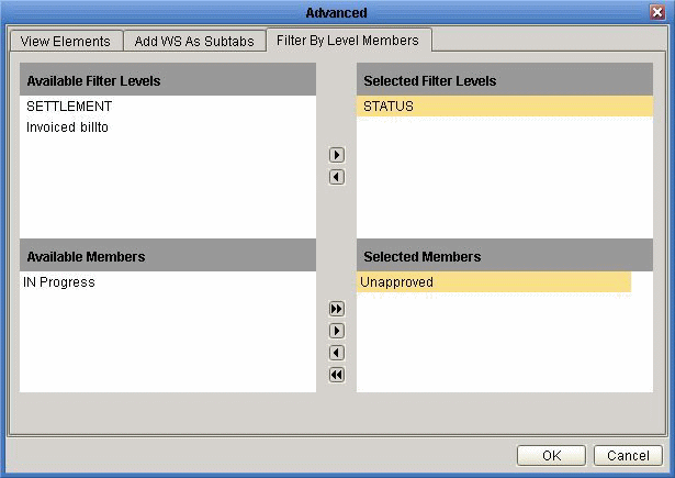

To apply a filter to a worksheet
Click Worksheet > Filters. Or click the Filters button.
The system displays the Available Filter Levels and Selected Filter Levels lists.
You can instruct Worksheet Manager to display the level members on the filter screen either by:
Code
Description
In Business Modeler, set parameter Sort Member by Code in Filter. See Oracle Demantra Implementation Guide.
Find the aggregation level at which you want to filter data and move it from the Available Filter Levels list into the Selected Filter Levels list, using any of the techniques in Working with Lists.
Note: This level does not have to be the same as any of the aggregation levels you display in the worksheet. In fact, typically you filter using a different level than you use to display.
In the Available Members list, find a member that you want to include in the worksheet and move it into the Selected Members list, using any of the techniques in Working with Lists.
At this stage, the worksheet includes only data for this member. (Before you applied a filter at this level, the worksheet could theoretically include any member of this level.)
Continue to move members from the Available Members list into the Selected Members list, until the latter list includes all the members you want.

To define the layout of a current view
Click Worksheet > Layout Designer. Or click the Layout Designer button.
The system displays a page where you specify the layout. This page displays the following areas:
In addition, this screen displays the following icons:
An icon for each aggregation level that you have included in the worksheet. By default, these levels are included in the Members Browser or selector lists.
An icon that represents the time axis. By default, time is shown on the x-axis.
An icon that represents the series data. Series are shown on the y-axis.
To change the worksheet layout, drag the level or time axis icons to the appropriate areas. You cannot move the series icon.
To specify the type of graph to use, select a graph type from the Graph Type dropdown list.
To specify how to display series in this view:
Click the Sort button.
The Layout Designer displays a page that shows the order in which this view currently displays the series. The default order of the series is the order that you added the series.
To hide a series in this view, click the None option in the dropdown list to the right of the series name.
Otherwise, to specify where to display the data for a series, select one of the following options: Table, Graph, Table and Graph.
To move a series up or down in this list, click the series name and drag it up or down. If you want to restore the series to their original order, click the Reset layout button.
When you are done, click Close.
Click Save.
Rerun the worksheet to see your changes. To do so, click Data > Rerun.
To specify a crosstab layout
Drag one or more level icons from the Page Item area to x-axis or y-axis areas.
By default, all levels you include in a worksheet are used on all views of the worksheet. Within a multi-view worksheet, you often hide some of the levels in some views, so that each view is aggregated differently.
Right-click within the Page area of the Layout Designer.
The system displays a menu like the following:
Click Hide level and then click the name of the level to hide.
When you hide a level, the worksheet automatically aggregates data across members of that level.
Note: Do not use this option to hide the time axis.

For Combination Selector, click either Tree (to display a Members Browser) or Dropdowns (to display dropdown menus instead).
Select the check box next to each element you want to include in this view of the worksheet.
Click OK.

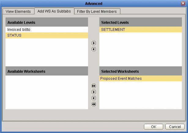

You can display one or more associated worksheets embedded within a subtab. When you select a member in the view, the embedded worksheet is filtered to show just that member. You typically use an embedded worksheet to drill into further detail.
Note: If you use the keyboard to move through the worksheet table, the subtabs are not automatically refreshed, for performance reasons.
To add an embedded worksheets
Click the tab corresponding to the worksheet view to which you want to add the embedded worksheet.
Click Advanced... in the lower right.
Oracle Demantra displays the Advanced screen.
Click the Add WS As Subtabs tab.
Oracle Demantra displays a screen like the following:
Depending on the level that you select, the bottom part of the screen shows different worksheets that you can add as an embedded worksheet to this worksheet view.
For Selected Levels, select the level that is associated with the worksheet you want. In general, a worksheet is associated with the levels where it makes sense to use it; this is controlled by your system configuration. You can choose any of the levels that are used in this worksheet.
For Selected Worksheets, select the worksheets that you want to display as embedded worksheets.
Click OK.
For each worksheet view, you can filter the view to show a subset of the data in the worksheet.
To filter a worksheet view
Click the tab corresponding to the worksheet view you want to filter.
Click the Filter By Level Members tab.
For Selected Filter Levels, select the level by which you want to filter this worksheet view. You can choose any of the levels that are used in this worksheet.
For Selected Members, select the level members whose data should be displayed in this worksheet view.
Click OK.

To view the definition of a worksheet
Open the worksheet.
Click Data > Info. Or click the Info button.
Oracle Demantra displays a dialog box that summarizes the definition of a worksheet, for example:
