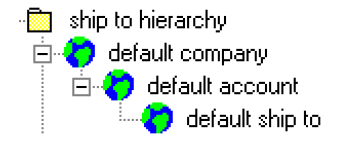

Oracle Demantra provides a default member within each level, as a placeholder, for example:
These placeholders may or may not be displayed in the worksheets, depending on how those worksheets are filtered.

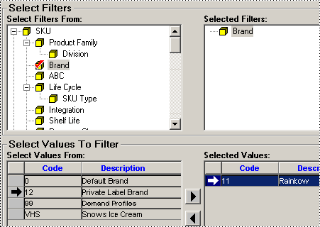

To filter the displayed members, method 1
Click Filter.
The Filter dialog box appears.
In the Select Filters From pane, select a level to be filtered.
The list of members for that level is displayed in the Select Values From pane.
Click the members to be included in the Select Values From pane and click the arrow to move them to the Selected Values pane, for example:
Click OK to return to Member Management.

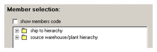

Select the member that you are using as the starting point. For this example, click the Rainbow member to select it.
If there are other hierarchies within this dimension, select a member within each of them. For example, suppose that the Member selection list includes two hierarchies of locations, as follows (shown collapsed to save space).
In this case, you need to select a member within the ship to hierarchy and a member within the source warehouse/plant hierarchy.
You do this so that the new combination can be found within both these hierarchies.

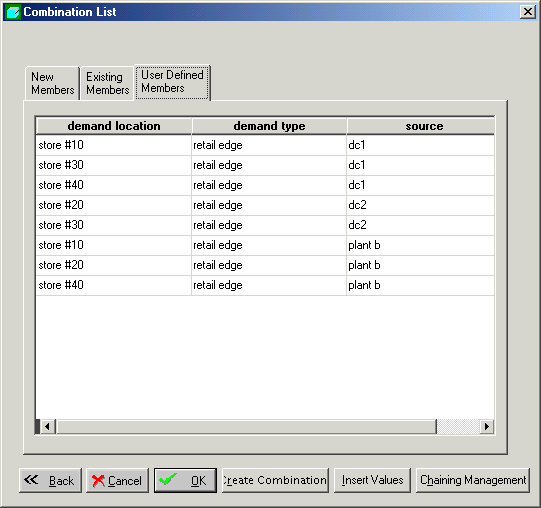

In the Combination List, all possible hierarchy links are displayed in three tab windows: New Members; Existing Members, and User Defined Members:
Do one or more of the following:
To create combinations, select one or more combinations and click Create Combinations.
To add the combinations to the database and create zero histories for them, select one or more combinations and click Insert Values.
Tip: To select more than one member combination, press Shift+Click or Ctrl+Click.
To go directly to Chaining Management, click Chaining Management.
