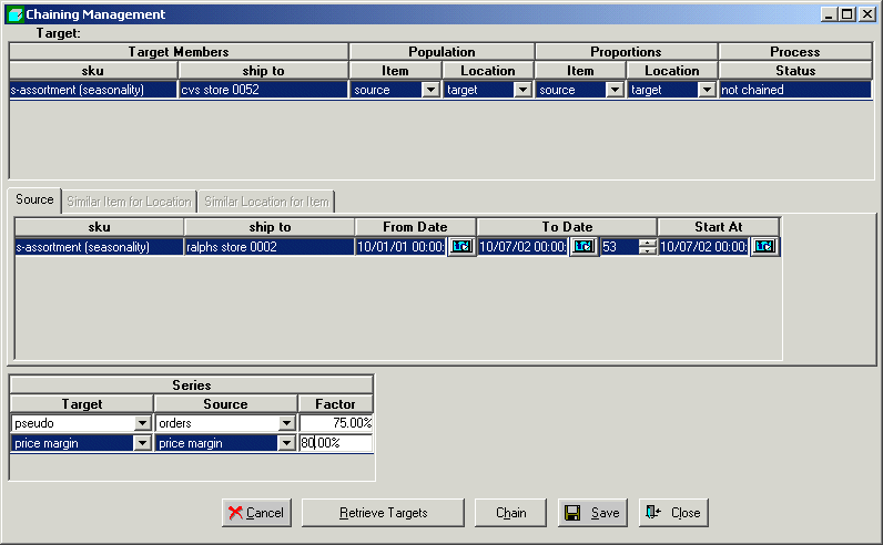

The Chaining Management window opens.
If this tool is not installed on your desktop or there is a newer version available, Oracle Demantra installs or updates the tools on your desktop. You must have the correct permissions. See Oracle Demantra Implementation Guide.
Click Retrieve Targets. Chaining Management is updated to display all saved chaining operations.
Before you start to use Chaining Management, it is useful to become familiar with the user interface. After you start it, click Retrieve Targets. The following window is displayed. In the window, each row of the:
Target area represents a saves chaining operation
Source area represents a source combination for the selected chaining operation
Series area represents a series to copy during the selected chaining operation
In this window, you can do the following:
Define chaining operations.
View details of each saved chaining operation. When you click a row in the table at the top of the screen, the rest of the window is updated to show details for that operation.
Edit a saved chaining operation.
Send chaining operations to be processed in the background. You can rerun chaining operations that were processed earlier.
View the status of past chaining operations.

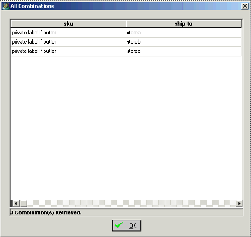

You can view the existing lowest-level source or target combinations for any chaining operation.
To view the existing lowest-level combinations
Right-click in the Target area or the Source area and then select All Combinations.
Note: If this option is not available, save your work, exit Chaining Management and then reopen it.
Chaining Management displays a window like the following:
This window lists all the lowest-level combinations that currently exist. It does not show you any combinations that the chaining operation itself would create.
To close the window, click OK.

In this step, you specify the Target Members and Population fields.
To specify the target
Start Chaining Management, as described in Opening Chaining Management.
In the Name column of the new row, enter a unique name for this chaining operation.
Double-click in SKU or Ship to column of the new row.
Oracle Demantra displays a window where you select a target combination, at any aggregation level.
Select a combination, as described in Selecting Combinations. As you do so, optionally apply a filter, if needed.
If there is a similarity between target and source, choose source for either Population/Item column or Population/Location column.
The following table summarizes the settings to use here.
In the table, * indicates that this member can be at any aggregation level and can be filtered.
| Case | Target Members SKU | Target Members Ship to | Population item | Population Location |
| Item similarity | All | A specific location* | Source | Target |
| Location similarity | A specific item* | All | Target | Source |
| No similarity | A specific item* | A specific location* | Target | Target |
See also Target and Source.

For each source, you specify a range of source dates, as well as a date to start pasting. For the source dates, you specify a start date and either an end date or a number of base time buckets.
To specify the chaining dates
For each row in the Source area, specify the following:
| From Date | Starting date for the source data. (To use a calendar, click the Calendar button.) |
| Length | The number of base time buckets for which to copy series data. |
| To Date | Ending date for the source data. |

The Series area of the screen lists the series whose data will be copied during this chaining operation. Note that when you copy data from one series, you can paste into a different series. You can also specify a scaling factor.
To specify the series to copy
For each series whose data you want to copy during this operation, do the following:
Right-click in the Series area and then select Insert.
A new row appears.
For Source, select the series from which you want to copy data.
For Target, select the series into which you want to paste this data.
For Factor, optionally specify a factor to multiply this data by before pasting it.
If you want to paste the same aggregated data to each target combination rather than splitting it across the combinations, select the Same Value for All Members check box.
Note: If you choose this option, your choices for item and location proportions are ignored.
If you have specified item similarity or location similarity, then Oracle Demantra matches up each target combination with one or more corresponding source combinations (depending on the number of chaining sources you choose). However, if the source combinations do not have sales for some or all dates, the chaining operation might be considered incomplete.

To save a chaining operation
Make sure that you have given the chaining operation a good name.
Optionally add a description, in the Description column in the far right of the target area.
Click Save at the bottom of the screen.
See also Performing a Chaining Operation.

To perform a chaining operation
Click Tools > Chaining Management.
Click Retrieve Targets. Chaining Management is updated to display all past chaining operations.
Click the chaining operation that you want to perform.
Click Chain.
Oracle Demantra displays a dialog box that summarizes your selections.
Click OK.
Scroll to the middle of the target area of the screen, to the Process Status column. This column shows the status of each chaining operation.
The status is one of the following:
| not chained | This chaining operation has not been run yet or was run recently but was not successful. |
| ready in chain | This chaining operation has been sent to the queue and will be performed as soon as possible. |
| done | The chaining operation was completed successfully the last time it ran. |
| failed | The chaining operation was not successful. |

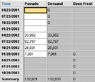

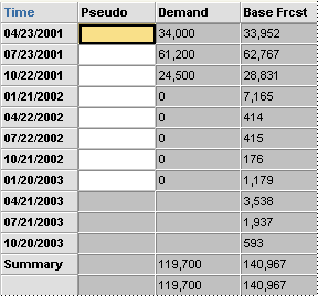

In this scenario, we copy data for one combination at the lowest level and we paste into a user-defined combination, also at the lowest level. This is not a common scenario but is a useful exercise to try.
Suppose that SKU 009 is sold in Wal-Mart 001. This combination has the following sales (shown here by quarter):
Suppose that we have already used Member Management to create a new item called SKU 999, and then to create a combination for SKU 999 at Wal-Mart 001.
We would like to copy the forecast for SKU 009 and Wal-Mart 011 and use that data as Pseudo for SKU 999 at Wal-Mart 011. We would like to shift the dates, however, by a year.
To copy this data, we set up this chaining operation.

After Oracle Demantra performs the chaining operation, SKU 999 at Wal-Mart 001 has the following data:
Note that Oracle Demantra does not paste data into Pseudo after 01/20/03; this is because Pseudo is editable only in the history. Also, the value for 01/20/03 is slightly different from the corresponding value in the source because we are viewing data by quarter. If we viewed data at the lowest level (by week), the numbers would be identical.
We want to introduce a new item to the market. We want this item to be sold in all locations where an existing item is sold, with the same sales data, multiplied by one half and shifted ahead by one year.
The item Chocolate Ice Cream is sold in three stores. For example, the demand for this item for the quarter Q1 2003 is as follows:
| Store | Demand |
| Store A | 1000 |
| Store B | 2000 |
| Store C | 3000 |
Suppose we just used Member Management to create a new item called Double Chocolate Ice Cream. It will be sold in the same stores as Chocolate Ice Cream, and we believe its sales will be the same.
Also, in Member Management, we created the new item (Double Chocolate Ice Cream), but we did not create any combinations for it.
We would like Double Chocolate Ice Cream to be in combinations with all the same stores as Chocolate Ice Cream. For those combinations, we would like the Oracle Demantra database to contain the same demand data, multiplied by 50% and shifted by a year.
To create the combinations and copy this data, we use the following chaining operation:

The Oracle Demantra database now includes the following combinations:
Double Chocolate Ice Cream at Store A
Double Chocolate Ice Cream at Store B
Double Chocolate Ice Cream at Store C
Also, the database contains data for these combinations. For example, the data includes these values for Pseudo for the quarter Q1
