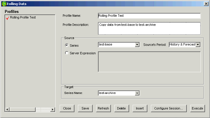

To create or modify a rolling data profile
Select Engine > Rolling Data.
The Rolling Data screen appears.
Do one of the following:
To select an existing profile, click the profile in the Profiles list.
To create a new profile, click Insert.
The screen displays a check mark next to the profile that you are editing.
Type a unique name and an optional description for the profile.
In the Source area, do one of the following:
Select a source series from the Series drop-down list.
Note: If the server expression for the series uses the round function, note that the rounding occurs before the data is rolled forward. In this case, you might have slight errors at aggregated levels.
Type a server expression into the Server Expression field. In this case, click Verify Expression to check the expression. The expression must be an aggregating SQL expression; see "Syntax of Server Expressions".
Specify the period association of this data source by selecting an option from Source's Period.
In the Target area, select a series from the Series Name drop-down box. Make sure that the target series is of the same data type as the source series or the source expression.
Click Save.

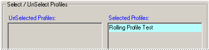

To specify the active rolling data profiles
Click Configure.
The Configure Rolling Session screen appears.
To include a profile to run, drag it from the left list to the right list. Or to exclude a profile from the next session, drag it from the right list to the left list.
To change the order in which the profiles should be executed, drag the profiles up or down within the left list as required.
Click Save.
