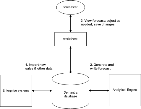

The following figure shows an overview of how a Demantra solution uses the Analytical Engine:
Within a Demantra solution, the Analytical Engine runs periodically (in the background), reading data from the Demantra database and generating forecast data. The forecaster uses a worksheet to view the forecast and make adjustments, saving those changes to the database. The updated forecast is available to all users with the appropriate authorization.
The preceding figure is not meant to show hardware configuration, which is discussed in the Oracle Demantra Installation Guide, rather than in this manual. You should be aware, however, that the Analytical Engine can be used in a distributed mode. Specifically, your system may include the Distributed Engine, where the Analytical Engine is registered on multiple machines, all with access to the Demantra database. In this mode, the Analytical Engine automatically distributes its work across multiple machines simultaneously. This maximizes processing power and reduces bottlenecks. For more information about the distributed engine, see the Oracle Demantra Installation Guide.
