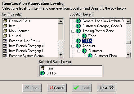

The wizard displays a screen where you specify the aggregation levels where the standard error is to be calculated.
This screen displays two lists of aggregation levels. The left list contains all the item levels and all the matrix levels. The right list contains all the location levels and all the matrix levels.
Specify the levels as follows:
Drag a level from each list to the Selected Base Levels field at the bottom of the screen.
To remove a level from the Selected Base Levels field, right-click it and select Delete Level.
Click Next.

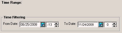

The wizard displays a screen where you specify the range of dates for which the standard error is to be calculated.
Specify dates as follows:
In the From Date spin box, select the number of base time buckets by which to go back. This is the date from which standard error is to be calculated.
In the To Date spin box, select the number of base time buckets by which to go back. This is the date to which standard error is to be calculated.
Click Next.

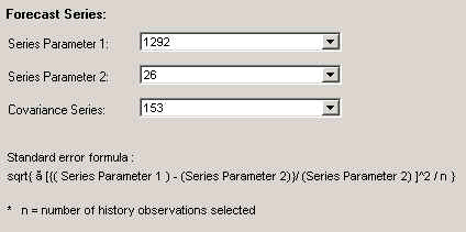

The wizard displays a screen where you specify the series to use in the calculation.
Specify the forecast series as follows:
In Series Parameter 1, select the series to use as Series Parameter 1 in the standard error formula.
In Series Parameter 2, select the series to use as Series Parameter 2 in the standard error formula.
In Series Covariance, select the series to use as the standard error calculated for the combination.
Click Next.
