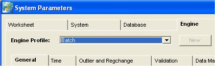

To edit the global engine parameters
Log onto the Business Modeler.
Click Parameters > System Parameters. The System Parameters dialog box appears.
Click the Engine tab.
From the Engine Profile drop-down, select the engine profile whose parameter settings you want to adjust.
Find the parameter of interest. The dialog box provides find, sort, and filter capabilities to help you with this. See "Engine Parameters".
To change the value of the parameter, click the Value field for that parameter. Type the new value or select a value from the drop-down menu.
Click Save to save your changes to this profile.
Click Close.

To create or rename an engine profile
Do one of the following:
To rename an existing profile, click the profile from the Engine Profiles list and then click Edit.
To create a new profile, click New.
Enter a (new) name for the profile.

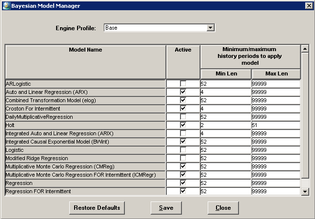

To enable models for the Analytical Engine to use
Click Engine > Model Library.
The following dialog box appears.
Select the batch engine profile to be associated with the model library configurations.
For each model, do the following:
To enable the Analytical Engine to use this model, make sure the Active check box is checked. For details on these models, see "Theoretical Engine Models". Note that not all models are supported with any given Analytical Engine.
The other two settings control the minimum and maximum number of non zero observations that a combination must have in order for the Analytical Engine to consider using this model for this combination. To specify these values, type integers into the Min Len and Max Len fields.
Note: Min Len must be equal to or greater than the number of causal factors in the forecast, except for the HOLT and FCROST models, which do not use causal factors.
Click Save and then click Close.
